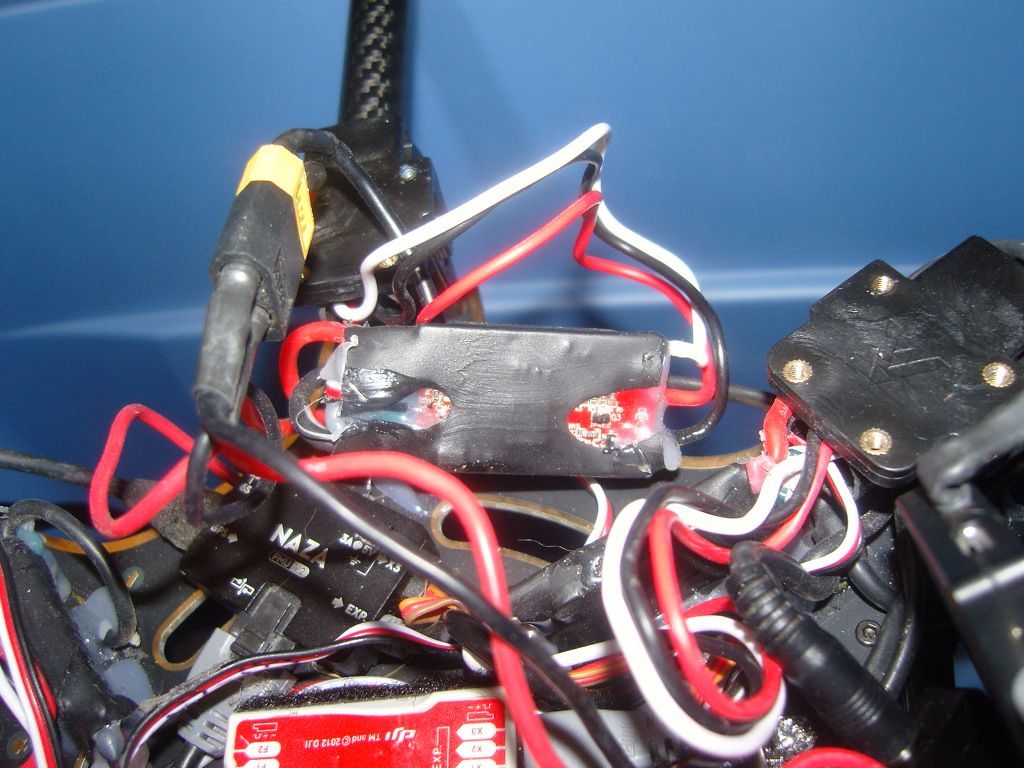

Think this got hot;
And, there's 1 more like that....it just keeps getting better.....
Really glad I took the top off and had a look around....those ESC's are toast!! So now, I need to figure out which ESC's I need to buy, that will offer me the most performance, and be the easiest to install. I get the 2-wire plug thing into Naza, M1, M2, etc....that's easy to figure out.
What I don't want to do is DE-solder the main ESC leads from the bottom PCB. So, can I just cut the wires, and splice/solder onto the new ESC's and go from there?
