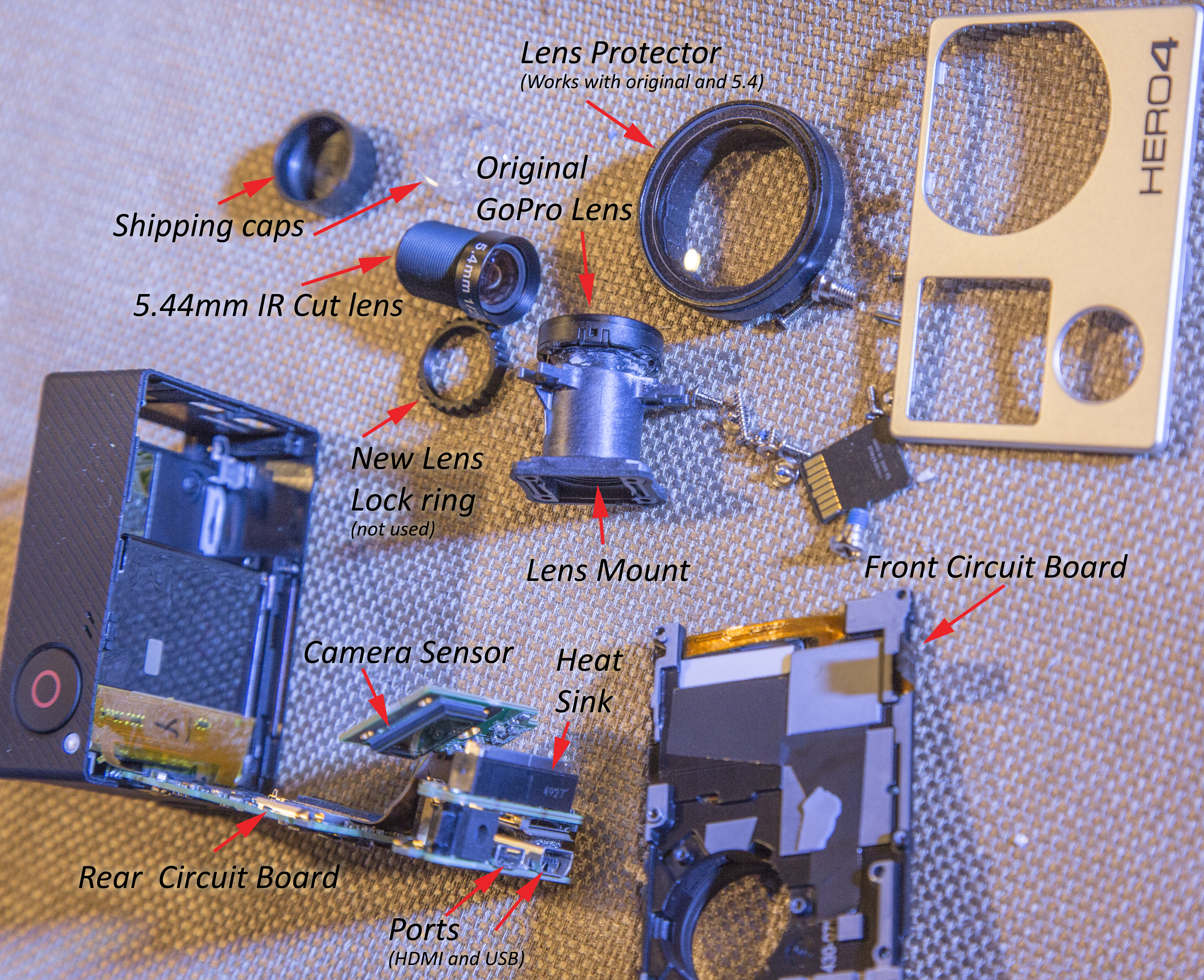

How long did it take you to disassemble, focus and reassemble the camera?
How did you focus the lens?

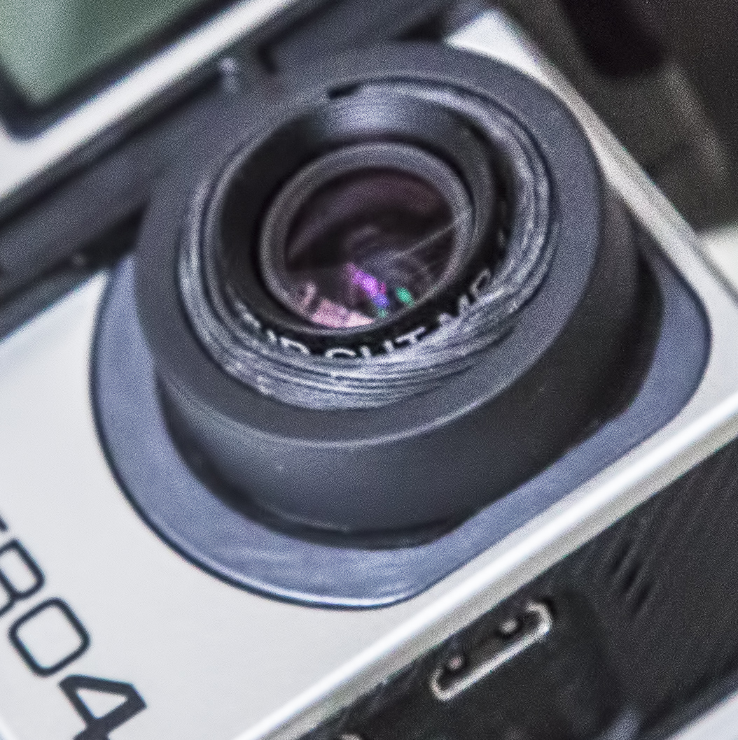

I would say an hour and a half, m/l. I would say it's roughly equivalent in time and bother to replacing a phantom's shell. Focusing was the hardest part. Well, the most tedious at least. I adjusted the lens in and out (twisting it against the threads) while watching it on a high-res monitor. I had to estimate the minimum focus distance for the lens. By trial and error, I got it right. I used 1/8" window screen beading around the lens to lock it in place.

This is how I locked my 5.4mm lens in place That is 1/8" window screen beading holding the lens in position. Thread lock would also work, but this also served the purpose of closing the gap around the lens.

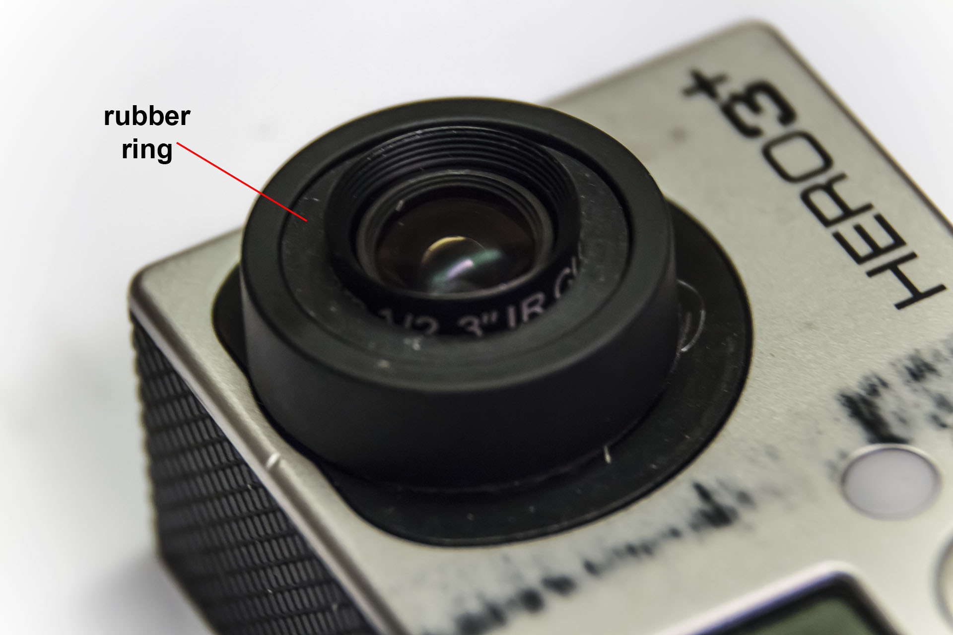

Rubber O rings also work nicely
Didn't you the rubber locking ring with your lens? Once the focus was setup I used a small amount of hot glue to lock it down before closing up the case.
I used the rubber beading instead. It's very tightly locked - and marked. I could put thread locker on later if there is a problem, but the rubber beading is very tight
This is the locking ring that came with the lens. It replaces the plastic locking ring that is mounted on the stock lens.
