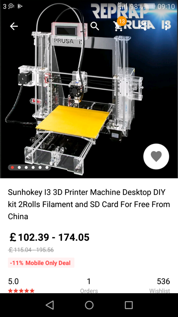

How about this? Price is very good. Its from aliexpress View attachment 90908
the problem with open printers is they loose heat that's something you don't want in your prints since heat is how the layers bond. With any of these printers you will want to read a lot of reviews be warned though all printers have issues with software or hardware and some with both. you will want to find out if anyone has fixed the issues through Modifications, how costly and how involved they will be to perform. many will just buy the printer and later find they need programing skills to fix the issues. I had the Programming skills going in and chose wisely the printer with the least amount of cost to bring it up to quality print level.

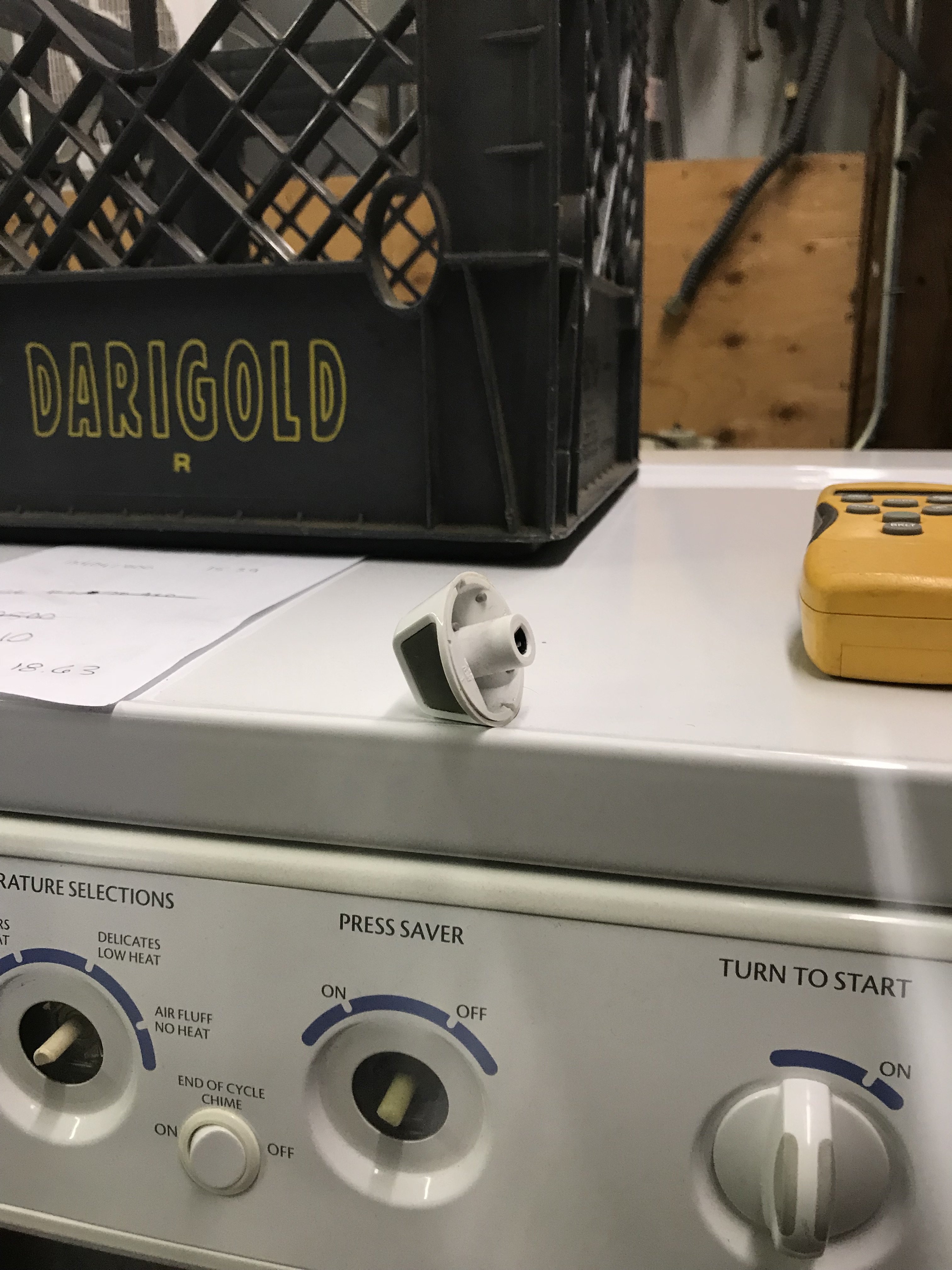

Thanks, I don't understand the 3D scanner part, can I put this knob like this in there and it will copy it?
If yes with or without a PC?

From what I understand you use your pc to create the width and height and layout and it will print it. Expensive printers scan it before hand

that is exactly rite it will scan any object you put in the printer provided its within the dimensions of the printers bed for width height and depth or X Y Z axis this is also a nice feature to have because it permits duplication of objects so lets say you have a knob on the stove that broke in half you can glue that knob together put it in the printer and scan it, it will save that file for you to print out to the exact dimensions. this can save a lot of time not having to draw it up in cad. I bought a handheld scanner that does this.

Can you put the knob in the printer in any direction and it does a one time scan or do you need to scan it multiple times in different positions?
Rod
some items such as knobs should go in upside down so the scanner can see the section that holds onto the shaft but then it should scan well in 1 scan. these are the little tricks you learn in printing same with setting it up to be printed, you will be able to rotate the item around in the printer program to find the best way to print it with as little support as possible. this saves filament, but if you aren't concerned about saving filament it can be printed at any angle with supports. there is only one other thing to consider with this method and that is show side so a knob you will want the best surface facing towards you those surfaces are usually best printed UP if you printed it sideways you would have the print lines running through the object and if it needed supports you would have to detach those supports that would leave some indication that they were there.
fortunately though all print lines can be smoothed with acetone, there are several ways to do this but IMO the best way is to used a double boiler style set up. so basically you will take a pot with some water in it and place a smaller glass container in the put of water in that container you put a couple ounces of acetone then suspend the part above it over the container then fire up the stove lowest heat possible to warm the water this will warm the acetone causing it to vaporize those vapors will rise up onto the printed part and smooth out all the print lines as well as give the part a nice glossy surface. I use an old frying pan as my boiler and a 1quart mason jar for my container. you can also sand items smooth and I sometimes do that and then use an acetone pen to further smooth and gloss over the part. acetone pens are basically a pen you put acetone in it has a felt tip to spread the acetone with I bought mine on amazon
