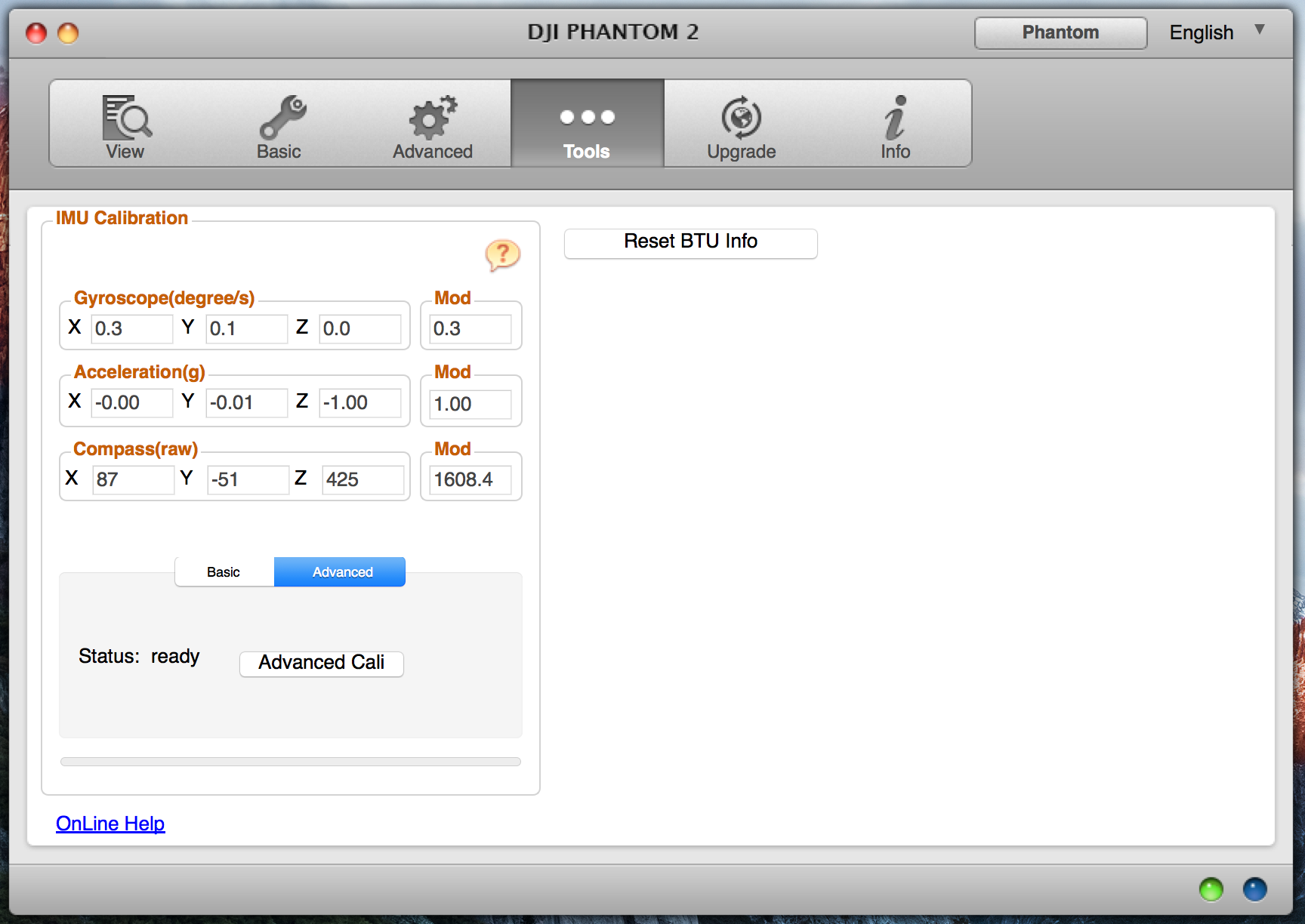

    Here is a screen shot of from the P2 software...just tried another take off....I take it up a meter or two, it keeps drifting to port at about 5kph then it won't respond to stick up, and comes down by itself...

    Your IMU looks fine.
