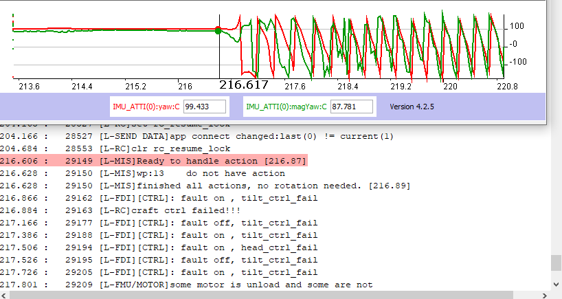

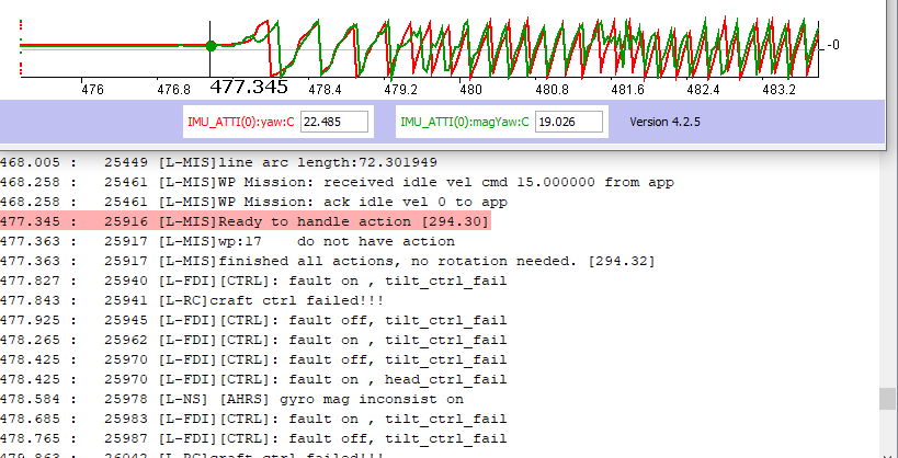

Can you provide FLY370.DAT? That would be the .DAT for the alternate P4(Pro) corresponding to the 3rd .txt you submitted. I'll be looking to see if the incident occurred at the same point in the mission. In FLY186.DAT the incident started when all the mission actions had been completed

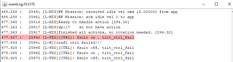

Looks to be the same problem; i.e. in FLY370.DAT the incident also started when all the mission actions had been completed.
Both the P4 and P4Pro were running the same FW. My guess is that the interface between MapPilot and the FW has a problem. There may be something unusual, but correct, about the way you specify missions that tickles this bug.

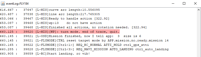

@EagkeOneUp Looking at the eventLog stream for the incident flights vs the non-incident flights:
Incident flight
Non-incident flight
I don't really know what this means but it is significant that this discriminates between incident and non-incident.
I was supposing there may be a difference in the way you specified the missions to MapPilot.
