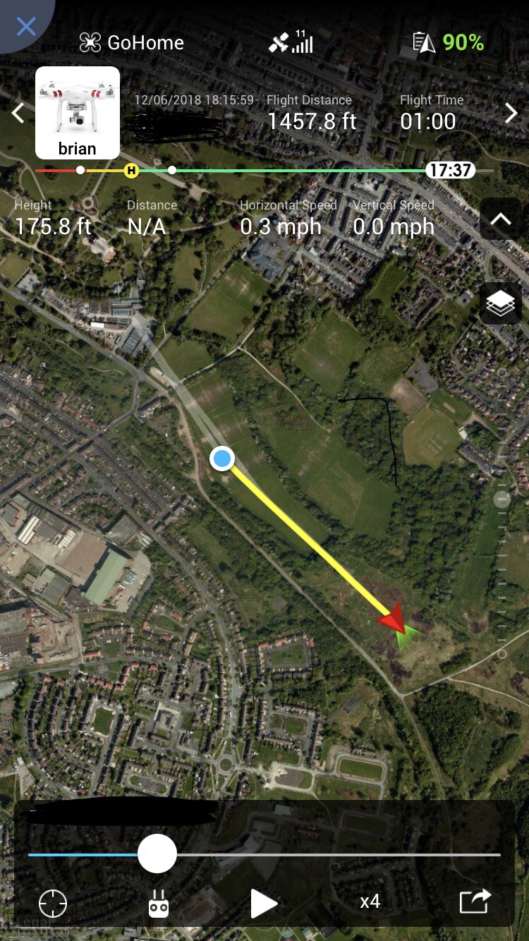

Ok i did a distance test before I lost signal with the drone
that’s the max distance achieved with the argtek mod

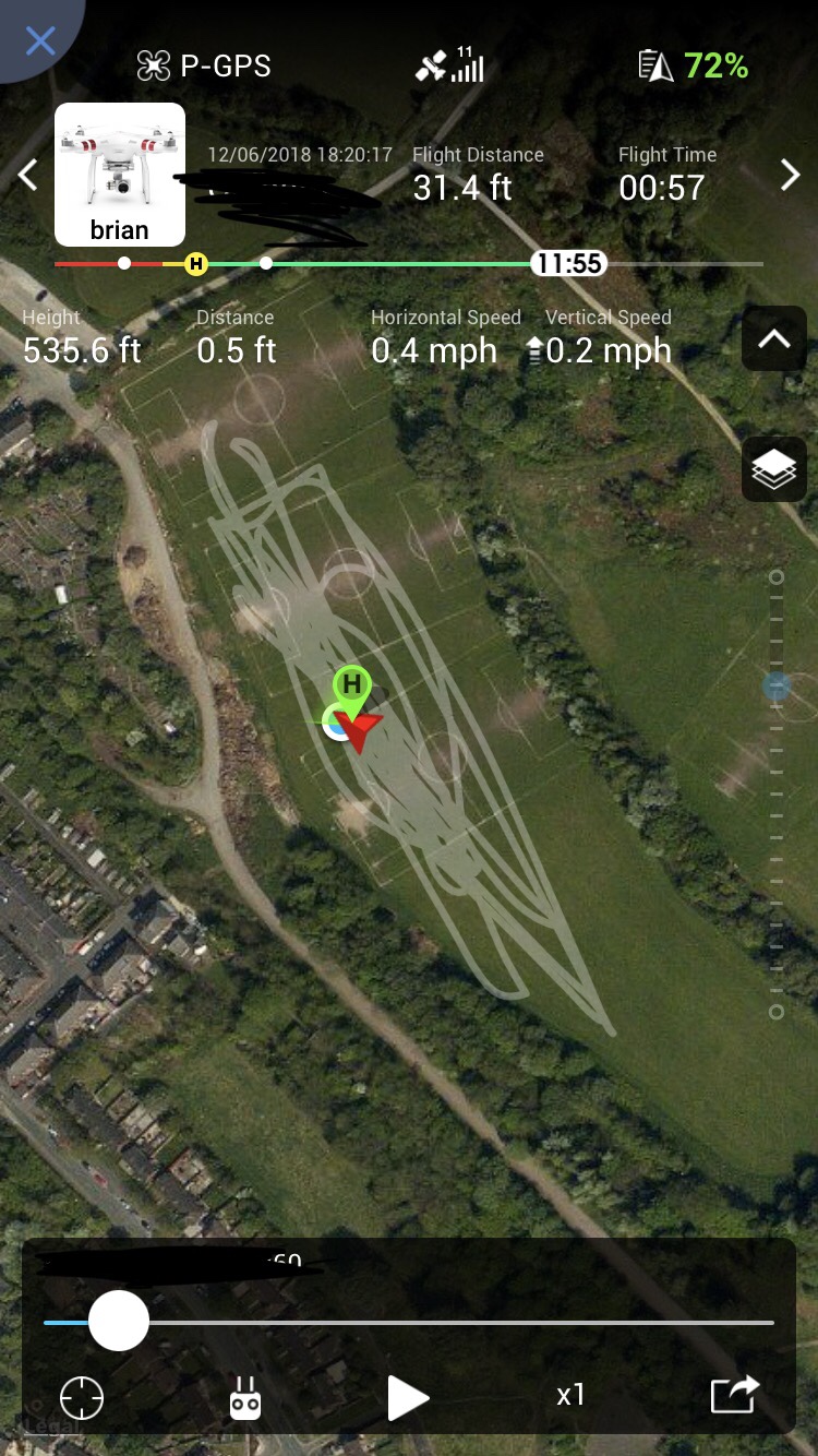

Next is my altitude test
I am not in beginner mode and my max altitude is set to 500 metres
