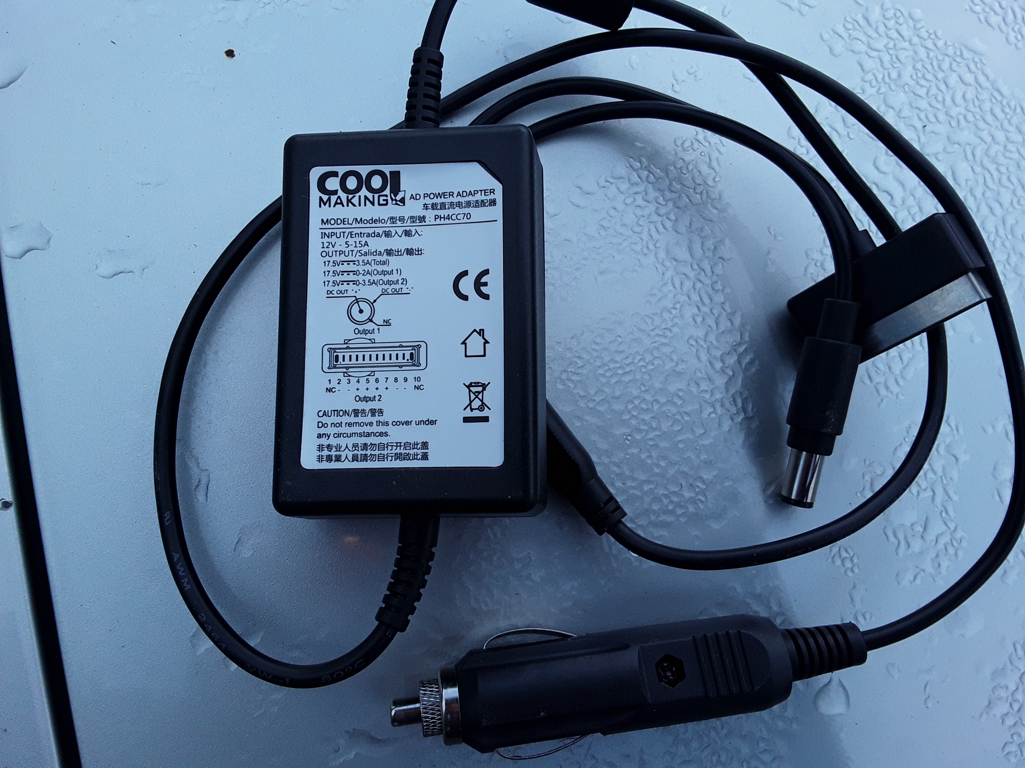

The one I bought from Amazon is like this one ... they also sell one for the P4 batteries... not DJI brand but works fine.

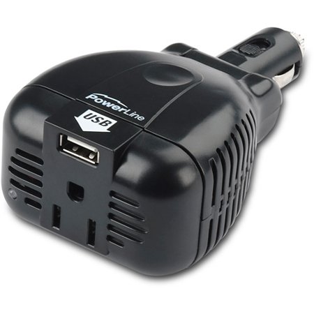

While taking a Lengthy trip recently, I wanted to fly at two different places about an hour apart. I bought my wife an inverter years ago for her laptop. The laptop is gone, but the 200 w peak inverter is still here so I gave it a try. I was amazed at how well it worked and didn’t get hot. Well, nothing like it did with my wife’s laptop.
It is a simple plugin to the lighter port. PowerLine 140w continuous, 200 w peak, 16 vdc. I used it on my DJI P4 battery.
