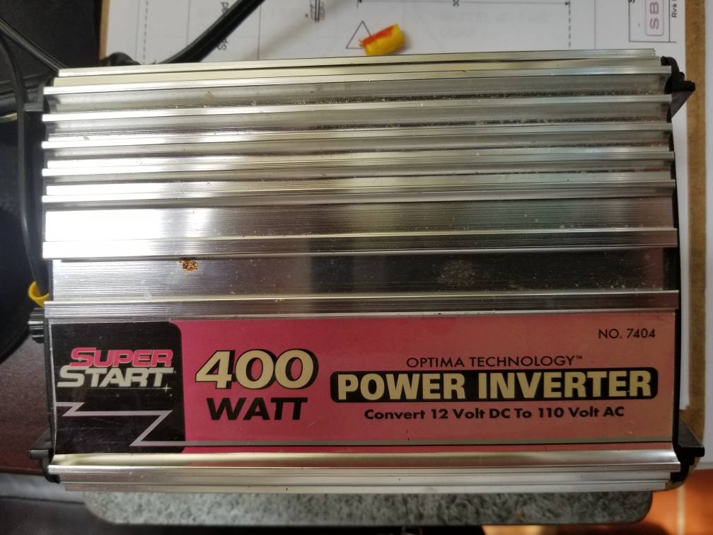

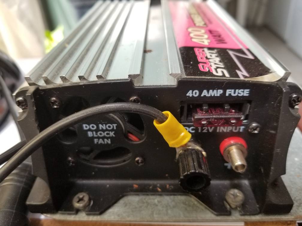

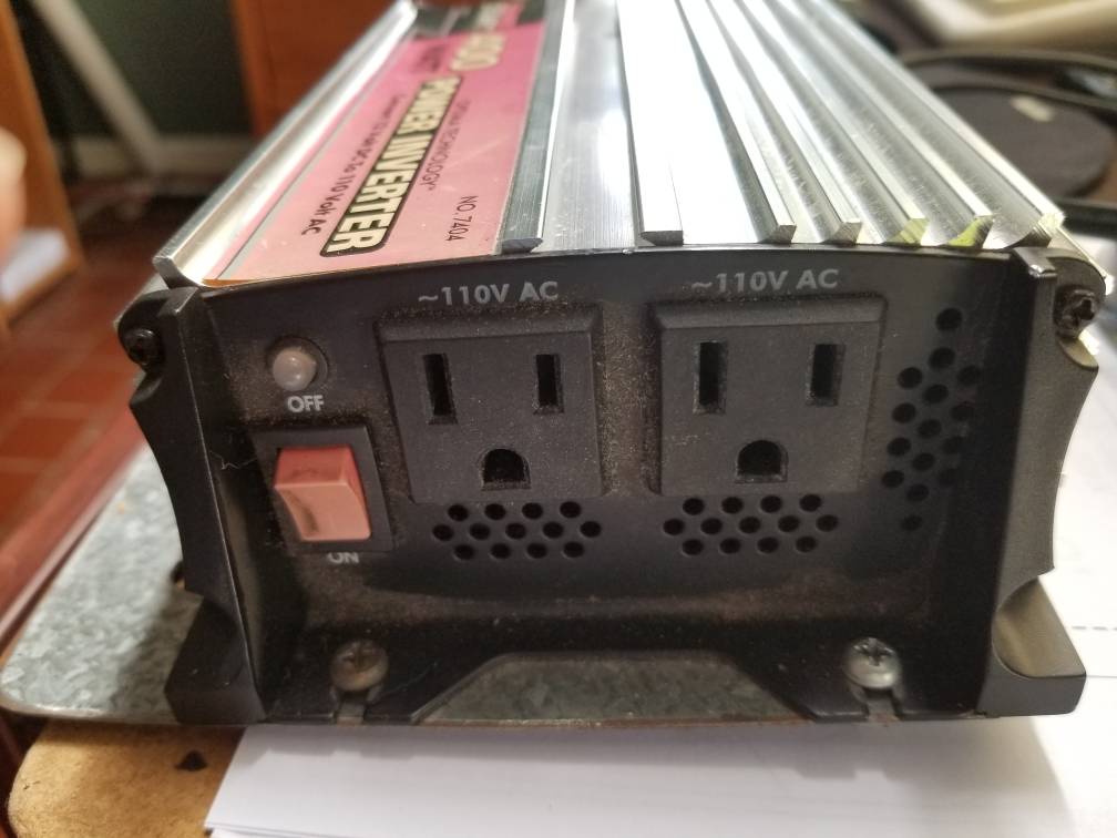

Here is what I use. Charges batteries & runs my laptop. Has a great fan.
