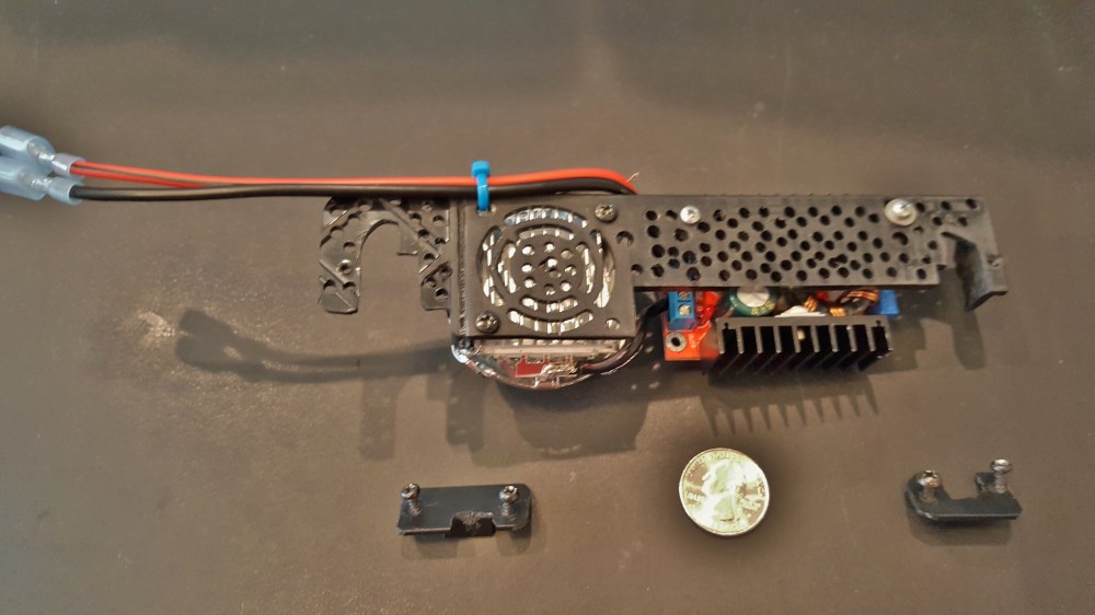

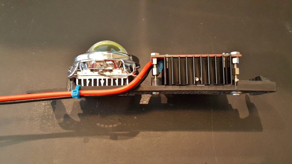

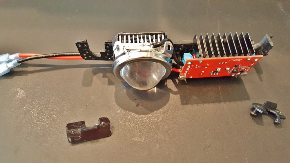

LOOK MA, NO FANUPDATE REV 2

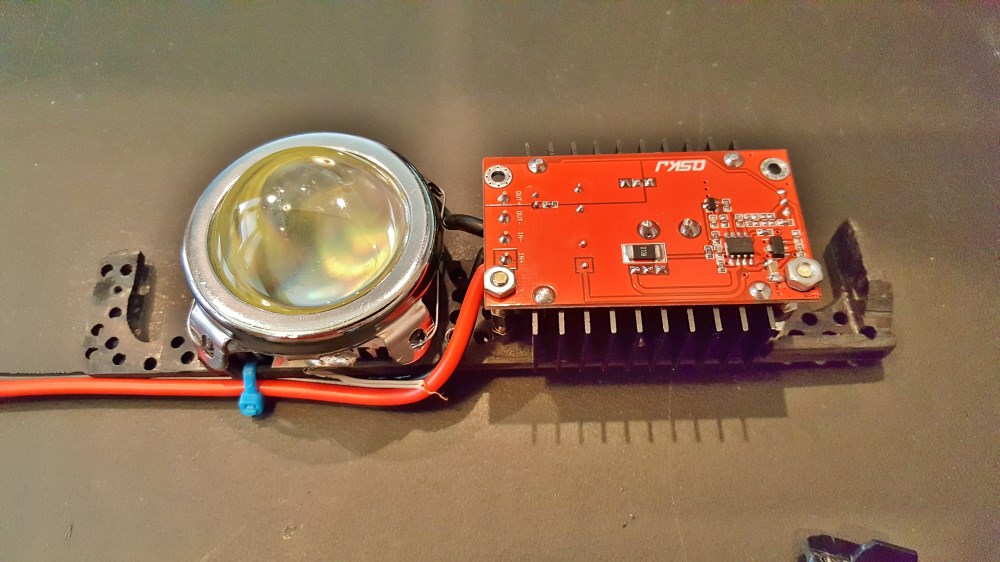

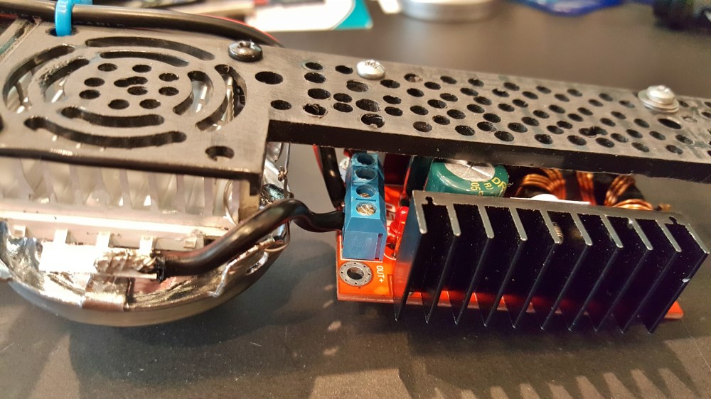

I made some changes to reduce weight and increase airflow over the power board and the LED. Photos show the light module off the drone so it can be seen better. More airflow, fan eliminated, lighter plastic from many holes drilled in it. The spring clips have been replaced with tension wire to hold the heat sink on with less metal protruding outward.
The short grey wire in the 4th photo connects to one side of the mercury switch and the other side goes to the + out connection at the power board. The 12 -36v converter is on and charged as soon as you connect the power leads to the battery. The light itself is what is switched on. The power drain of the voltage converter is nominal at rest, and the light itself draws far less current than the 12v input. (That is because it is at ~34v vs. the 12v input V/I formula.... look it up).
I have a US quarter for scale. You can see how my mount works with removable clips that screw on to hold it to the legs. The assy. actually sits level right on top that flat shelf edge at the top of the antenna covers of the legs. Note the clips have little down plastic at 90 degrees to keep things from rocking back and forth. I was lucky and found to right plastic bits from a scavenged HD drawer.
LOOK MA, NO FANS!! I figured constant high power prop wash was better than the tiny fan that went very slow when the light was on anyway. It actually blocked the more powerful prop wash air. I also inverted the power board so that air also now flows onto the power boards heat sinks to cool it better. I had to add longer board mounts. That is aided by the many air holes drilled in the plastic. It is thick so this helped reduce weight a few milligrams too I guess. The fan alone had some significant weight to it.
