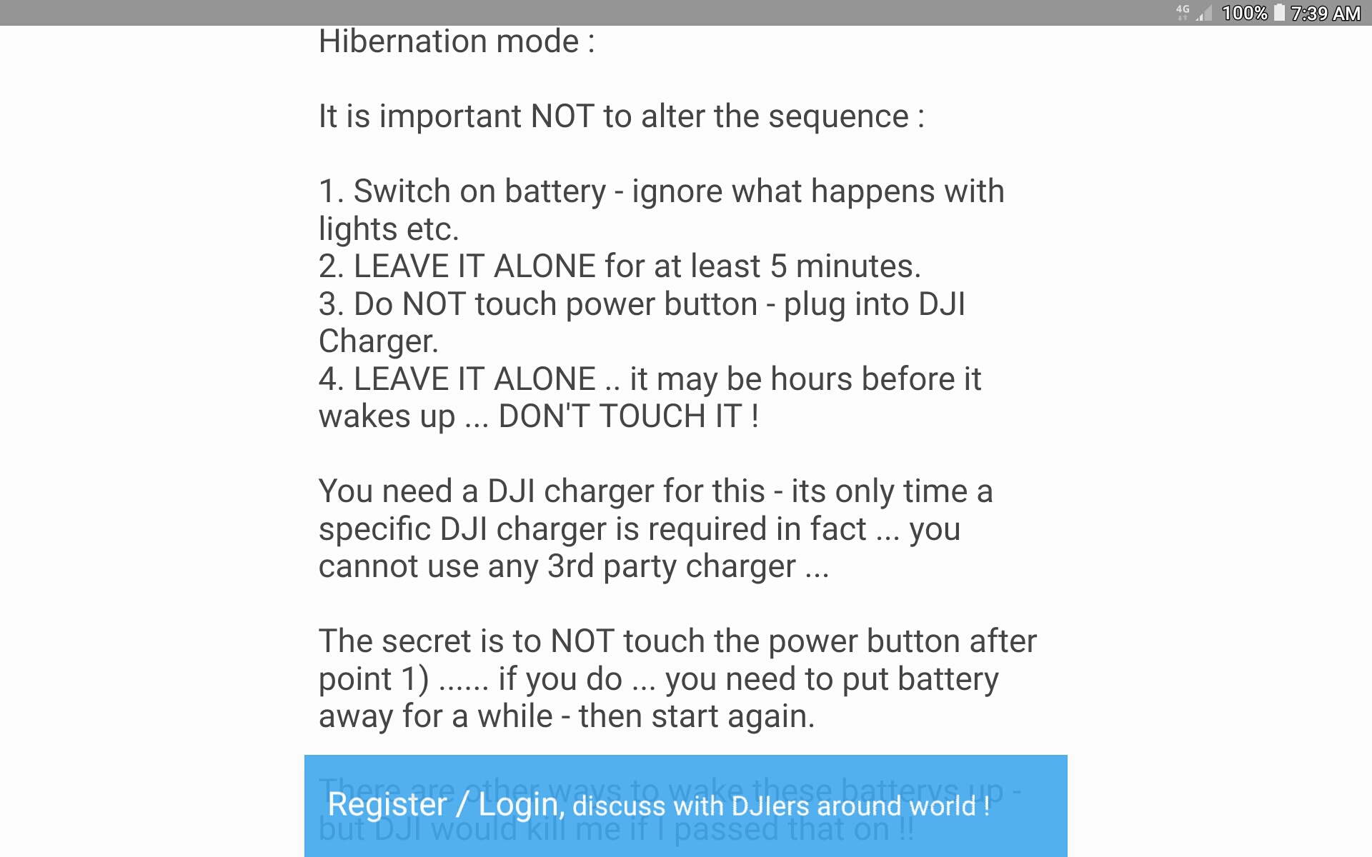

Stupid question but it worked for me. Thought I had a dead battery or a dead charger. Nothing was going on. Tried another charger. Nothing. Nothing for an hour. Then I pushed the battery button while unplugged, one light came on (as predicted). Plugged it in and it started charging. All is well. Hope it could be that easy for u.
Reactions: MotorCycle-Man
Yes.......i have read about what you did to get it charging....Its sortah a wake UP for it to leave the hibernation mode and Yes Start charging UP !............hope its works for the bsartist too

I am facing the same trouble and frustation. I bought a P4Pro+ that came with a dead battery too! :hushed::angry::worried:
After having issues of swelling with both my hi-cap P4P batteries, I started looking for replacments. Best deal so far is BuyDig, $99 for the brand-new standard capacity. Which is ok with me, since the three I have are working great (no puff), and there's only like a 5-10% increase in charge with the high-cap.
Update: The BuyDig battery arrived today, it's a "PowerExtra", not DJI. Buyer Beware!
Returned it and the shop gave me a brandnew boxed P4Pro+ but the battery is dead too!:fearscream: Is there any "secret ritual" to resurrect these "intelligent" batteries? Thinking in returning it and ask my money back! :mad::(
Mayby it went into hybination,,worth a try
