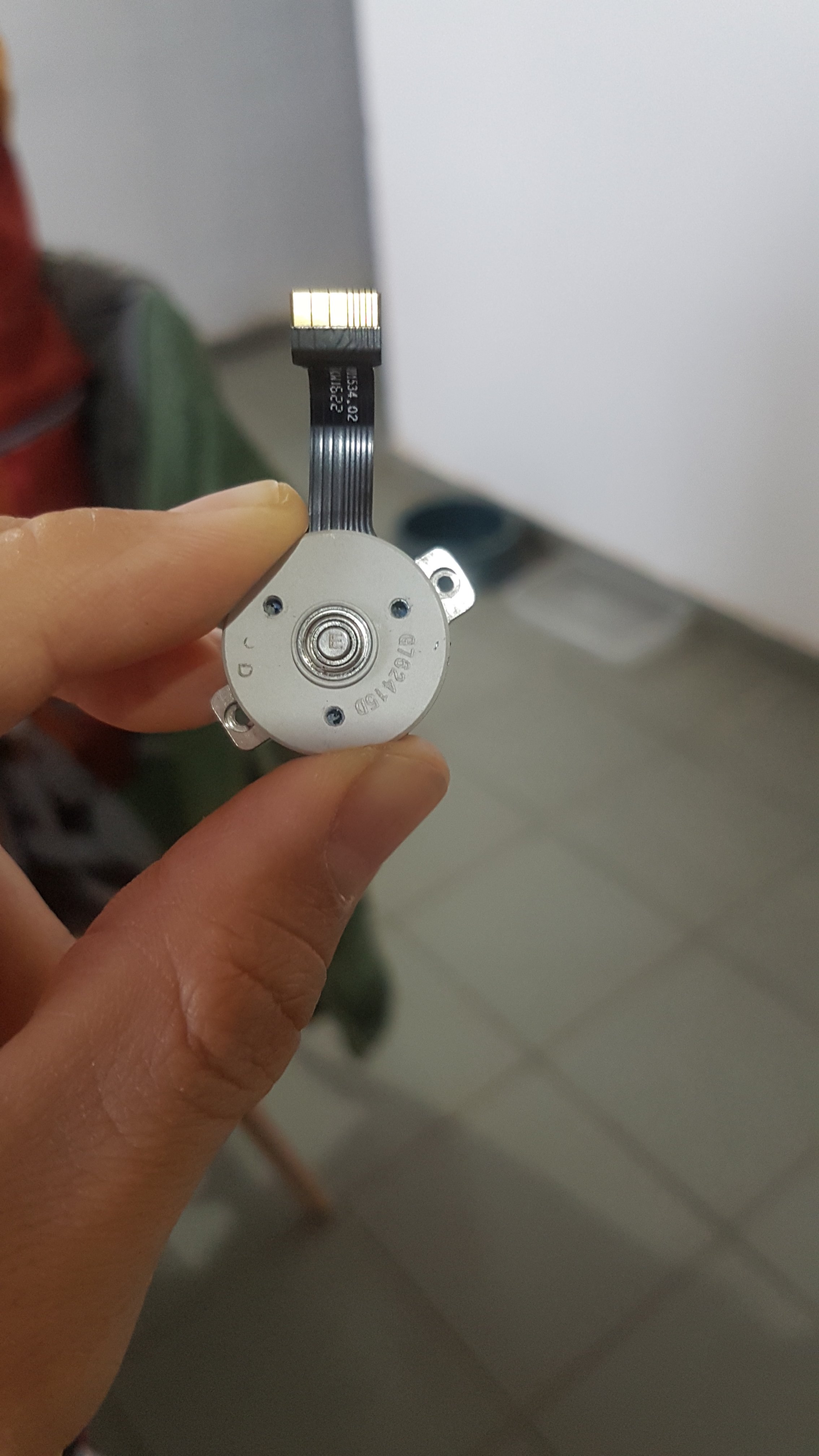

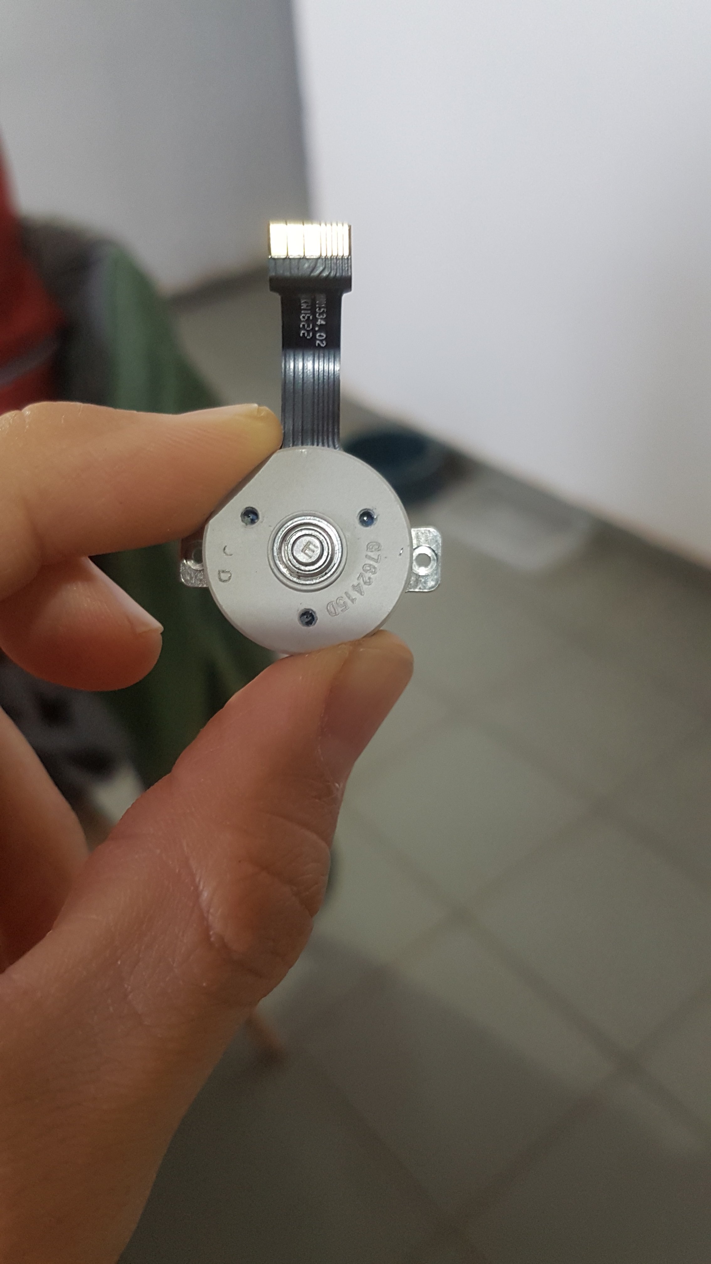

Hi Ted, I saw your video on youtube and I think it might help me with my issue but I'm not sure.
I had repair a Phantom 4 (flex and yaw arm replacement) and reassembled again without the yaw motor connected as its flex is broken and get a new one will take me almost two month here in Argentina.
So the thing is that I want my client to be able to use it without the yaw stabilization (as far as I understand yaw is controlled by the drone and is not something human controlled), at least us it that way until I get the new yaw motor.
The problem I'm facing is that the camera is fallen to one of it sides and I think is the roll motor which is decentralized but as I'm pretty new in this I want to consult you as you have much more experience. I'm attaching two pictures with what I think is the problem and I would need advice if this motor can be splitted and fixed.
So I'm thinking the "E" from center is the equilibrium point and should be aligned the flex as when I move the motor in the second pic to match flex direction it has the position I see in the camera.
PS: automatic gimbal calibration is not possible as there is one motor missing (the yaw motor).
I hope my explanation (and english) is accurate.
Your English is perfect. The gimbal will not work without all the motors in place and working. If one motor is not working corectly it gets confused and does odd things. If someone else has an idea feel free to jump in. I don't know everything
Were you worried about being 180 degrees off on mounting this motor? Was that your concern, that you had it in the right position?

As Ted has previously stated.... Check the sensors for scratches, score marks when you get the new motor. You are gonna have to use Teds method to pull the motor apart to inspect it. If they are smooth and dont have the scratches on the 2 sensors (opposite of the ribbon cable) then you have to install it back together with the original magnet housing that came with the drone, also shown in Teds method (Video). Let us know when you get the new part... Try to walk you thru it.

Well I replaced the yaw motor with a "new" used part and still camera is leaned right...
I tried to open it and re balance and doing that I broke the bearing so I need a new gimbal motor, the one that control the lean angle.
My question is.... Does the phantom 3 motor works on a phantom 4 ?
