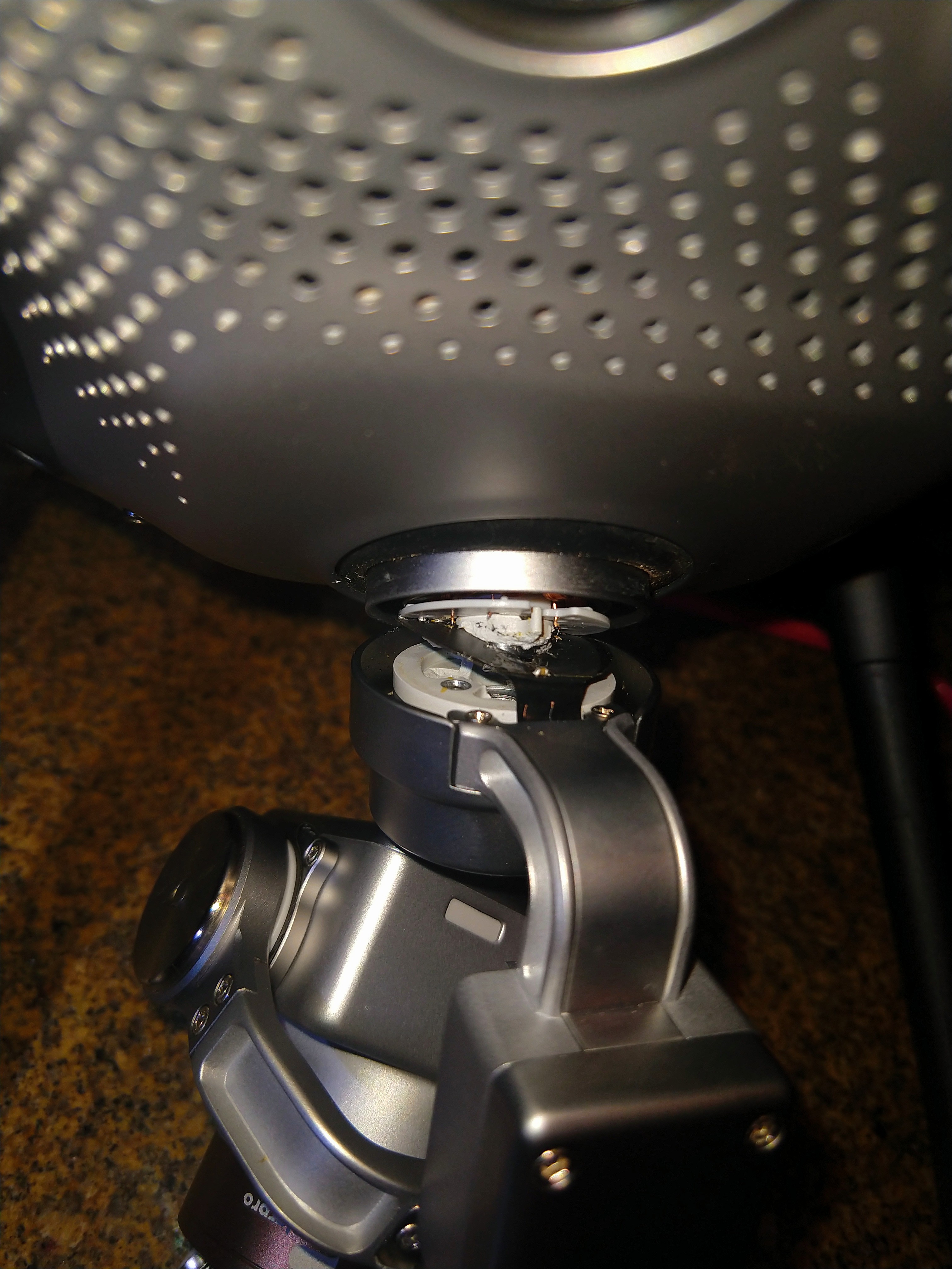

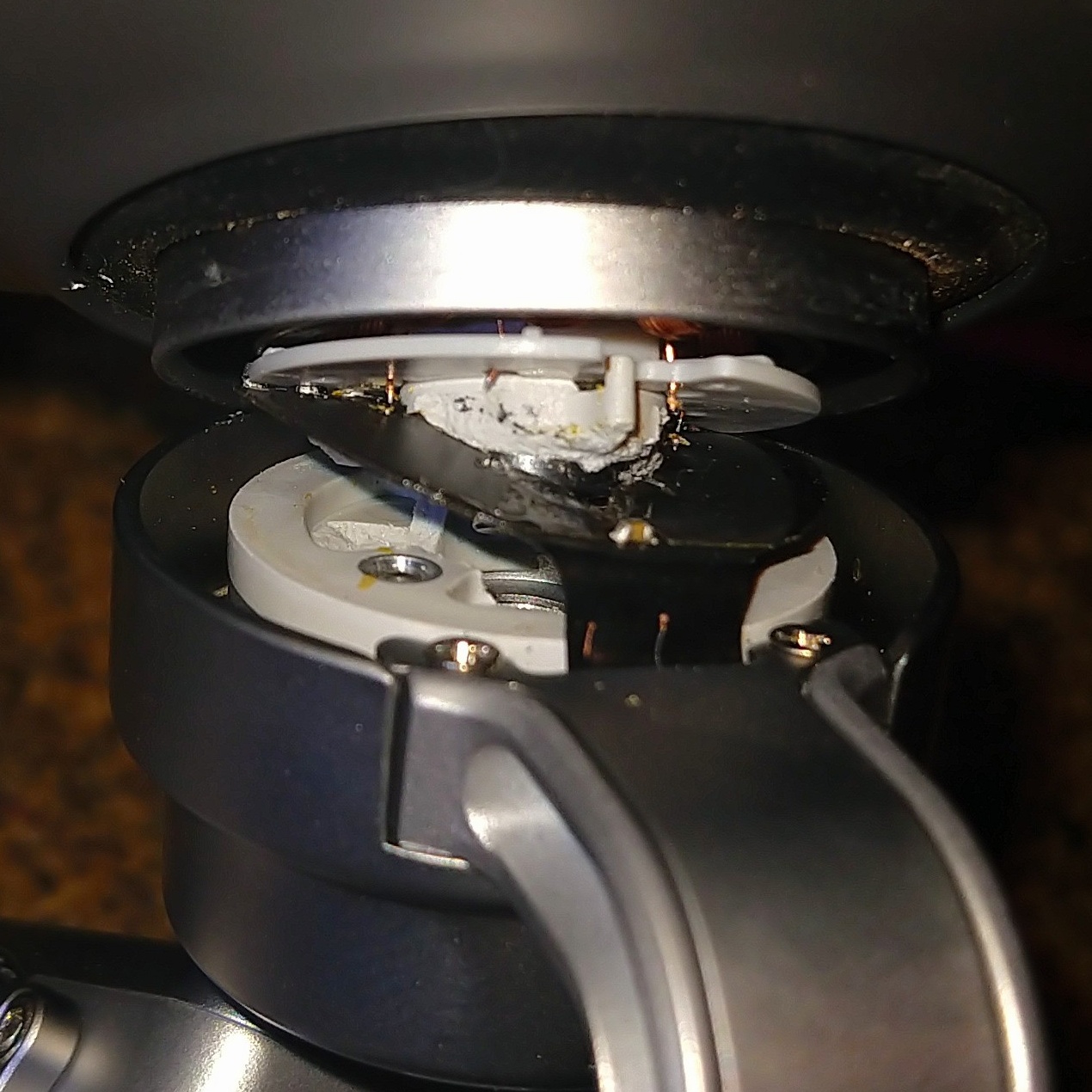

Hey guys, I know I'm a little late to the show here, but it seems the best place to start as I have not seen this specific problem.
I had a little accident where from what I gather, the yaw motor was ripped apart. From what I am guessing, it looks like a little clip holding it together was broken. I can actually snap it back into place and even flew with it like that, but now I'm getting "gimbal overload" warnings and obviously I want to fix it anyways.
I do have DJI refresh and have used it with good results, but I am guessing that this repair might be done for under $100 and would like to save the refresh for something more catastrophic.;) It looks like I just need to purchase the yaw motor?
Also, I don't own a vice but would probably pick one up if there is no other way.
Thanks for any and all input.

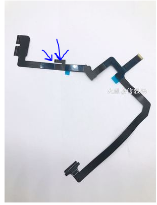

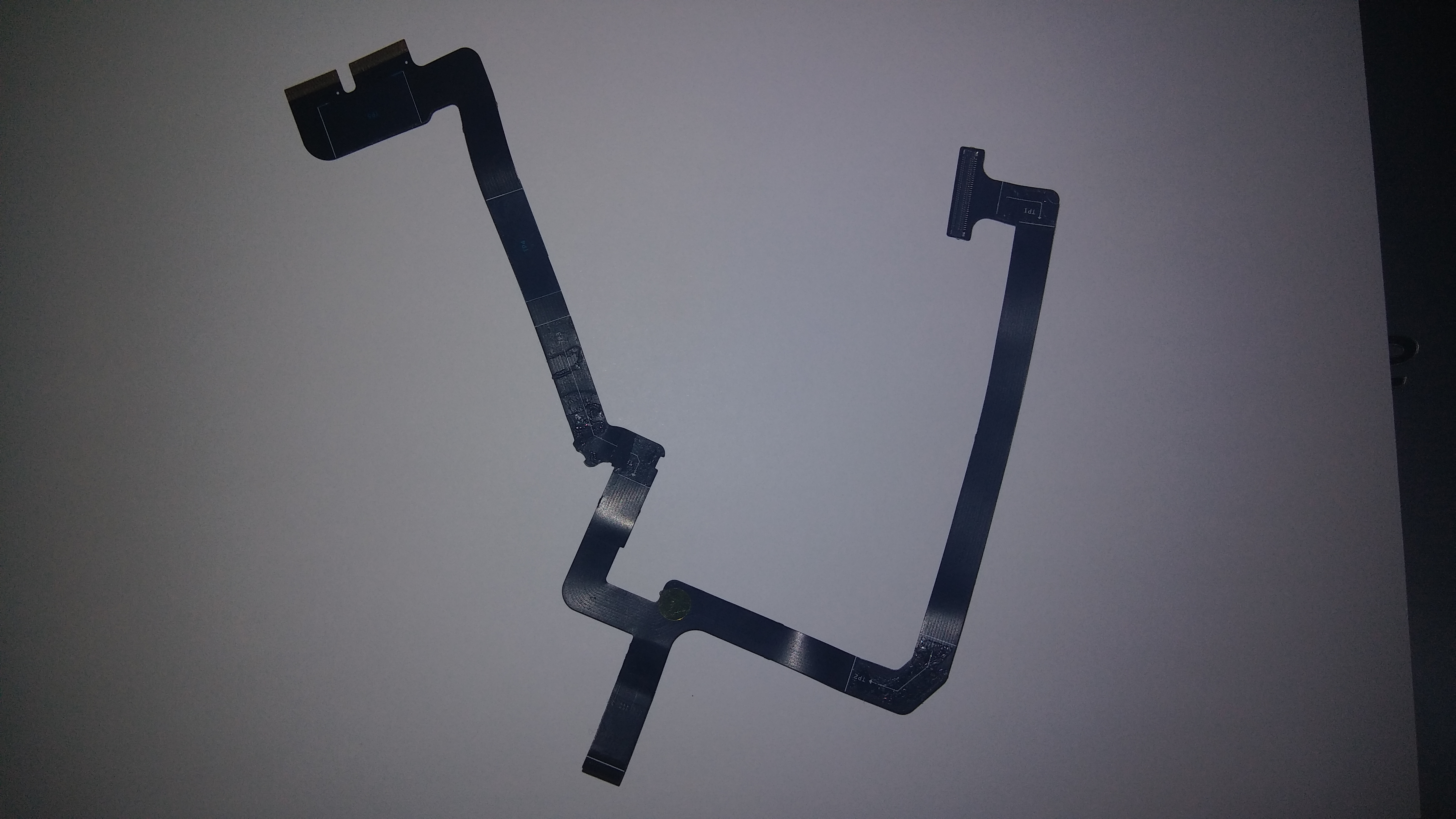

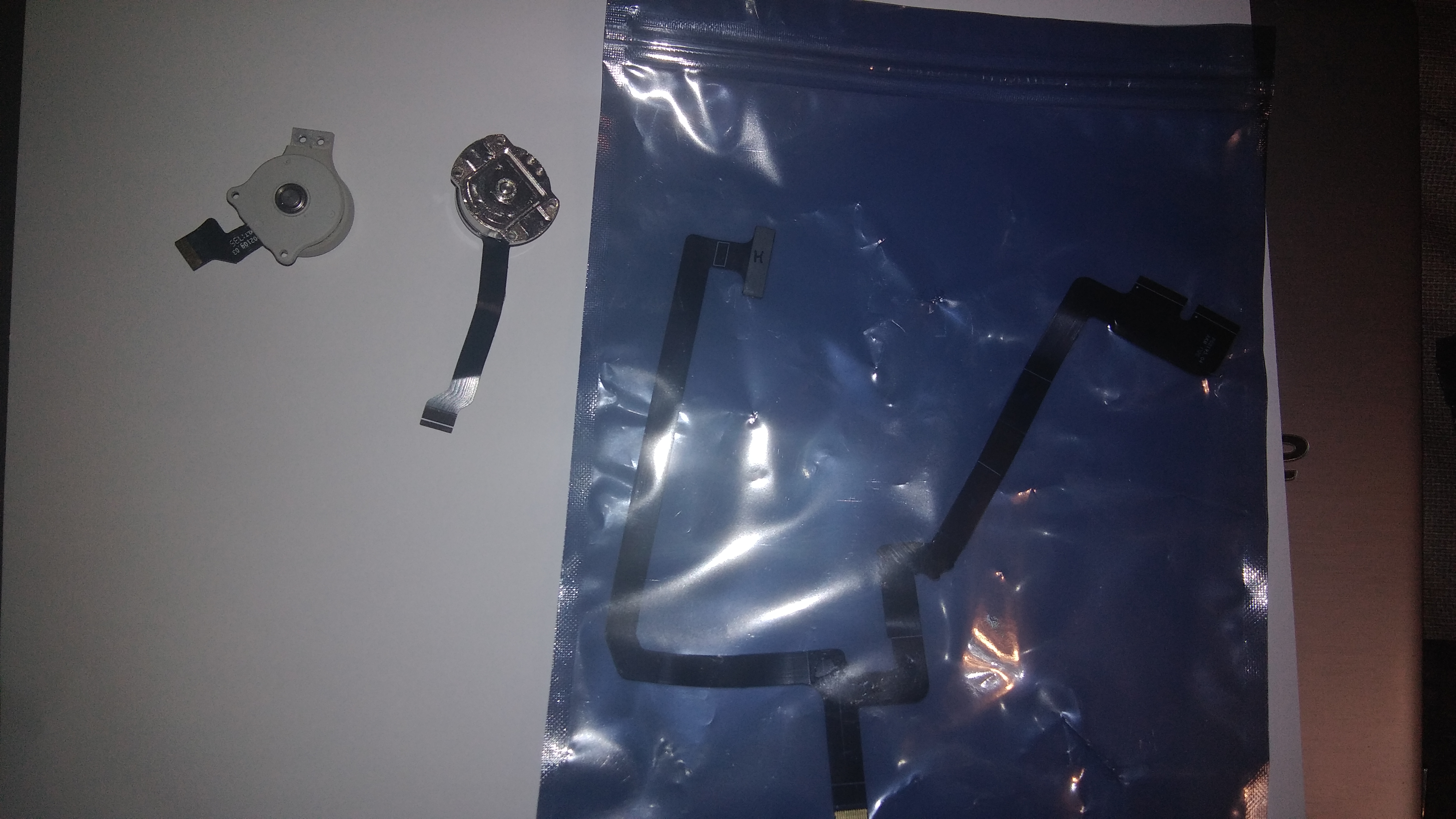

Hello, my P4p replacement parts arrived from china so far so good no complaints, roll motors looks like brand new but yaw motor has some scratches, i guess it's used, i am not sure about the flex cable though flex cable that i ordered doesn't have this part look at (blue arrows)
I do have DJI refresh and have used it with good results, but I am guessing that this repair might be done for under $100 and would like to save the refresh for something more catastrophic.;) It looks like I just need to purchase the yaw motor?View attachment 112051View attachment 112050View attachment 112050
Yes you need yaw motor and follow the teds video on how to replace the motor and sensors and keep the old housing
