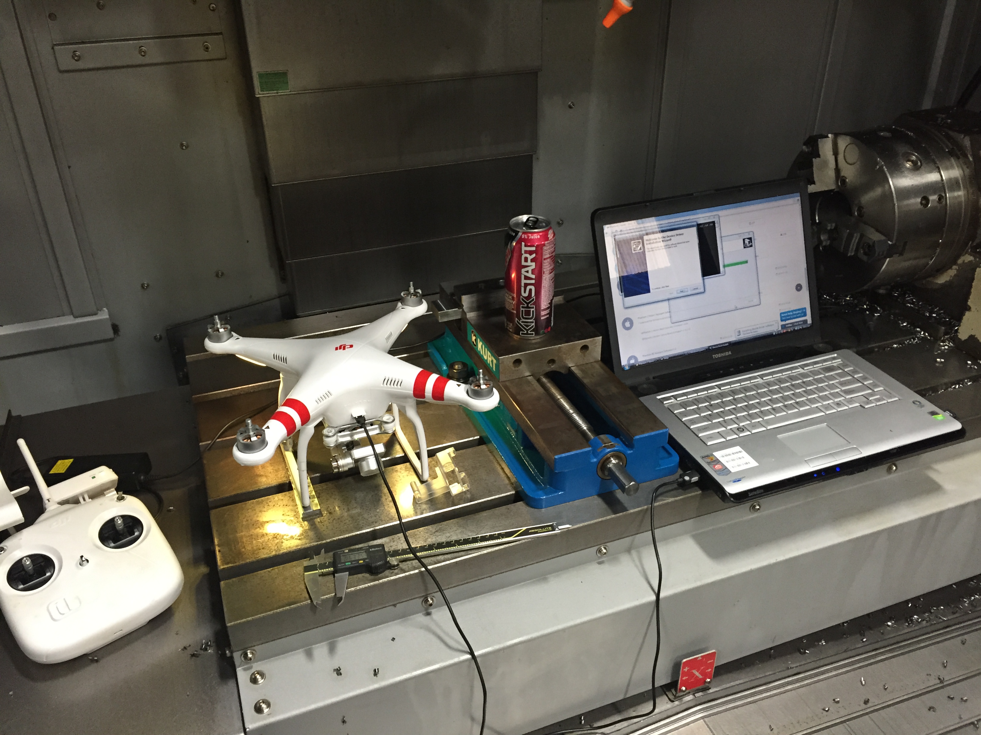

Or you can use a CNC leveled within +/- 0.00001" and use a CNC probe to ensure the Phantom is dead level. I had to use multiple thickness shims on all 4 corners to level. Spins on a dime now...FYI never reset your IMU data lol.

Or you can use a CNC leveled within +/- 0.00001" and use a CNC probe to ensure the Phantom is dead level. I had to use multiple thickness shims on all 4 corners to level. Spins on a dime now...FYI never reset your IMU data lol.View attachment 17520
QUITE HILARIOUS....... I must be certain to order this machine ASAP
