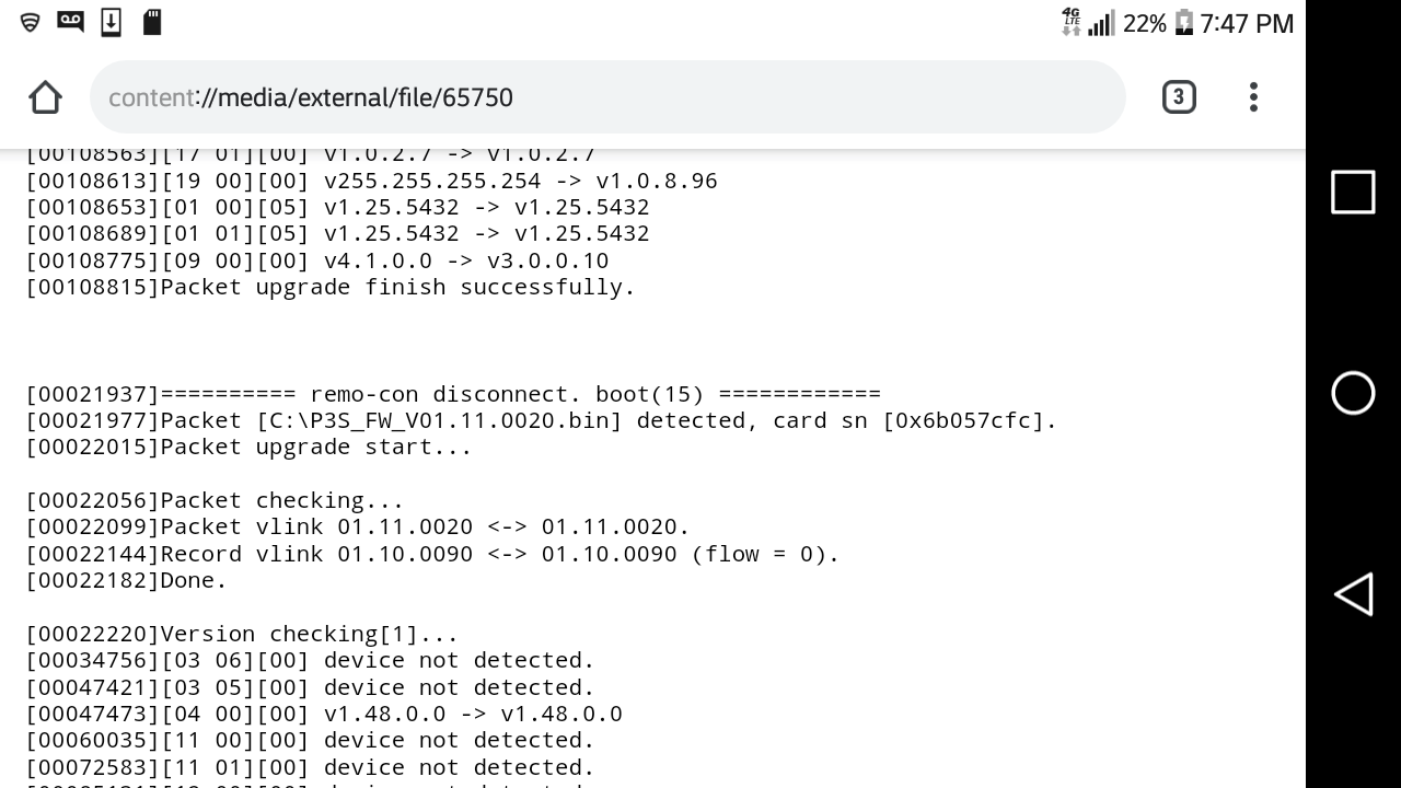

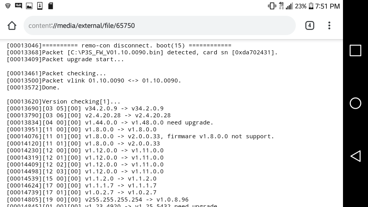

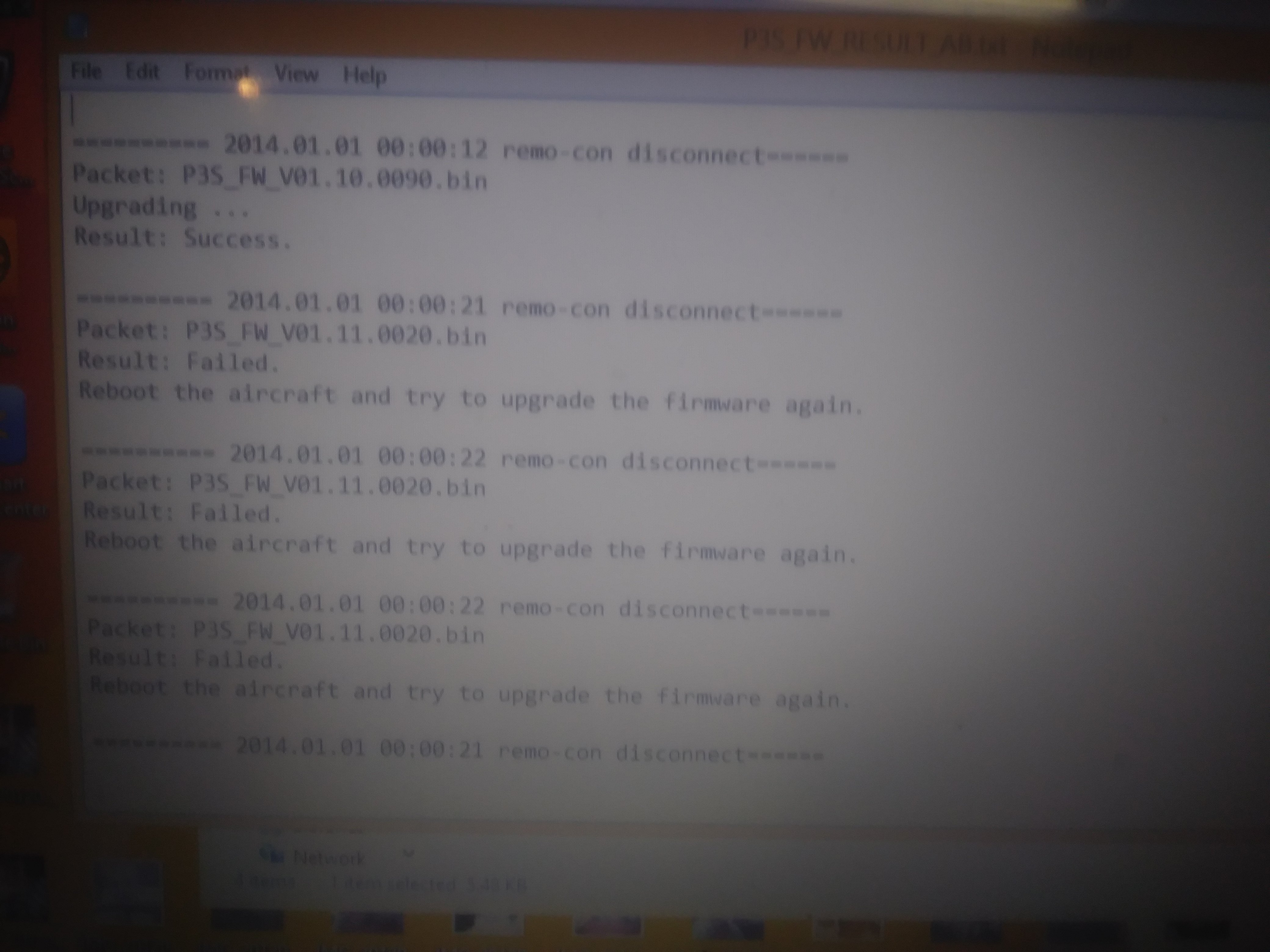

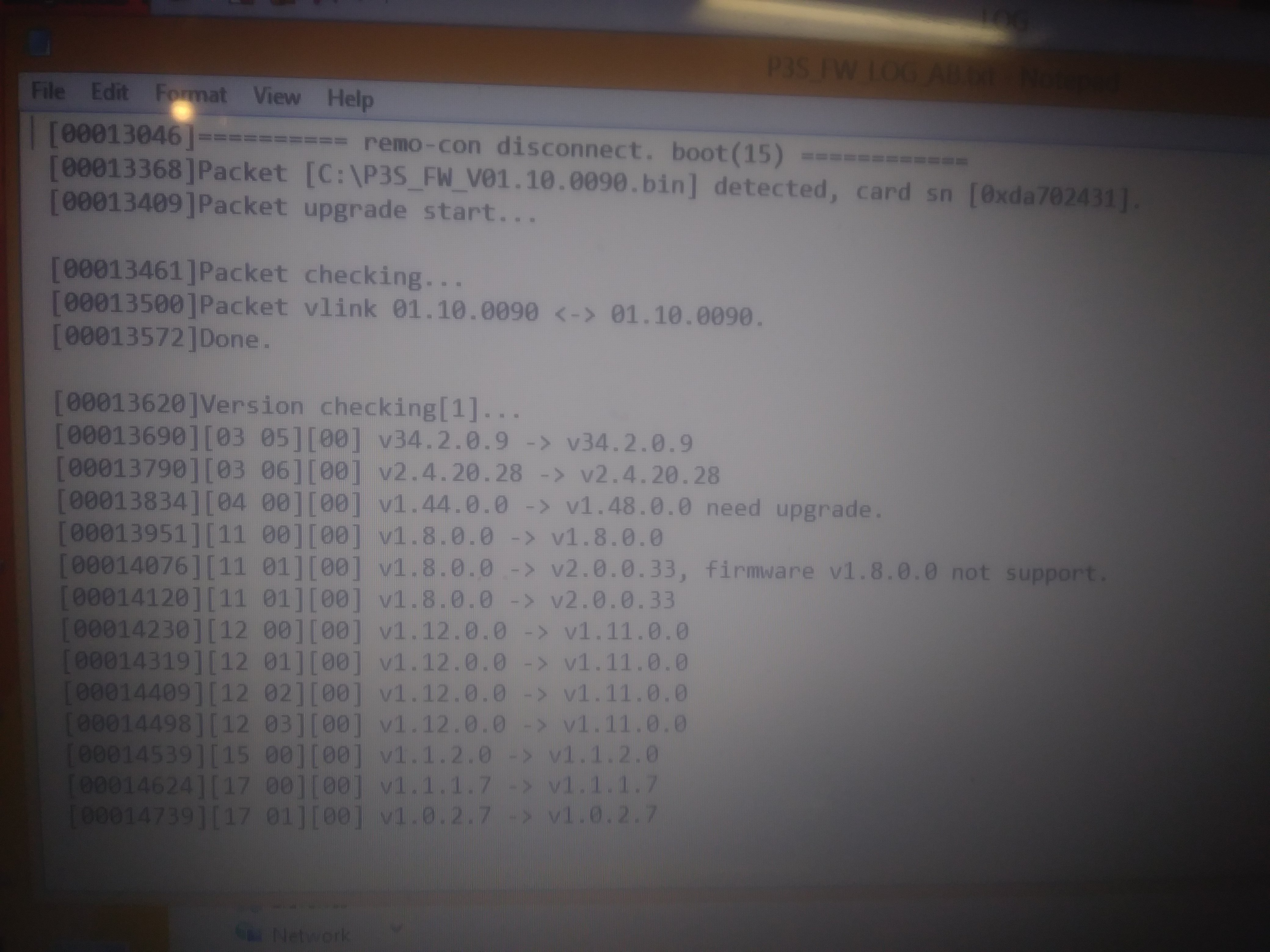

log file from sd card 15474184093681269131345.jpg. 15474184093681269131345.jpg
Judging from the very difficult images to view, it appears you have 1.10.09 on the AC. Can't be certain from the images. It would be better to see the actual .txt file. Not sure what is going on here, but it also appears you are attempting different versions. Make sure there is only one on the SD card. I realize hindsight is 20-20 but updating the firmware before determining actually what was going on with the AC interface was a big mistake. Now you have multiple issues added to the original problem. This might be very difficult to resolve.

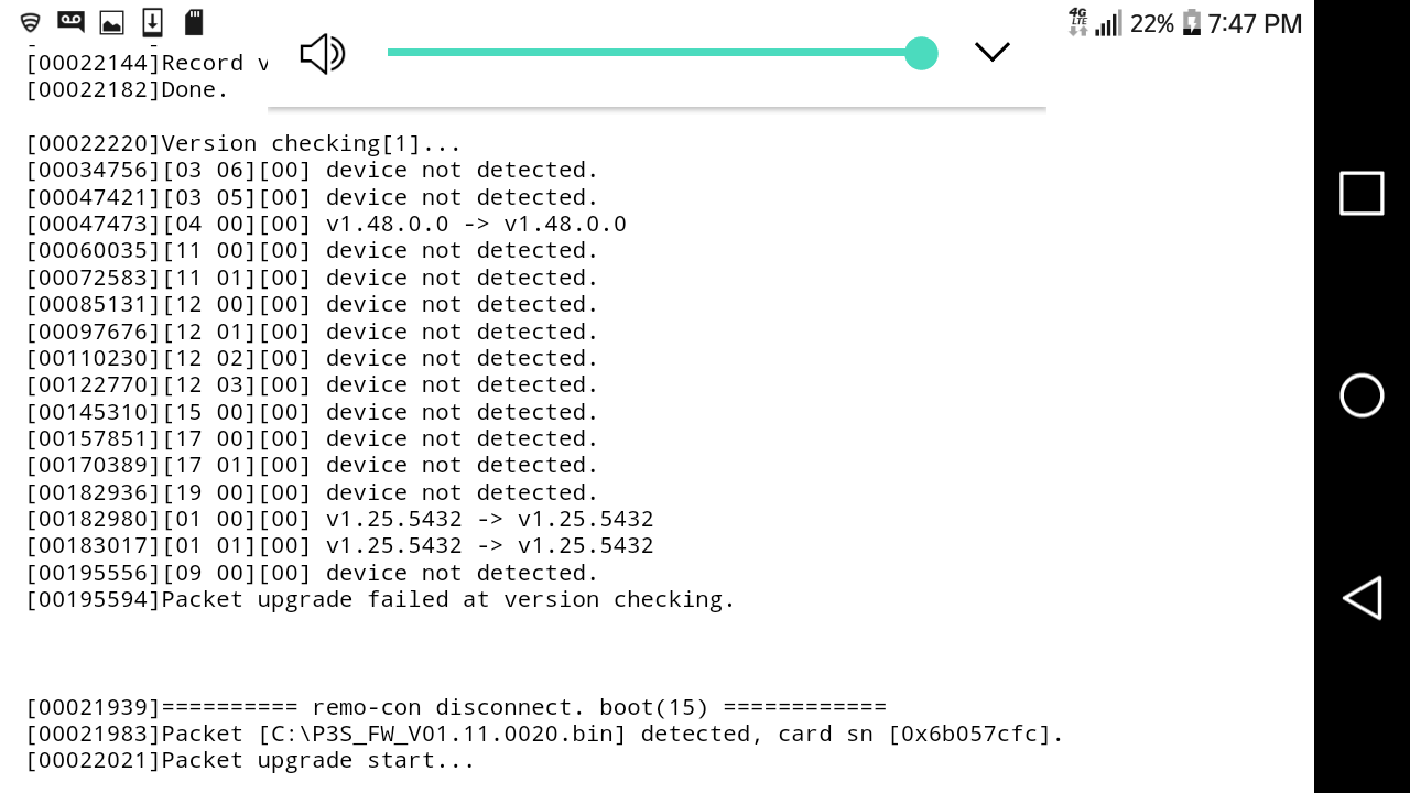

Hey flydawg i have finally got the files i beleive you asked for to help me resolve my issues
