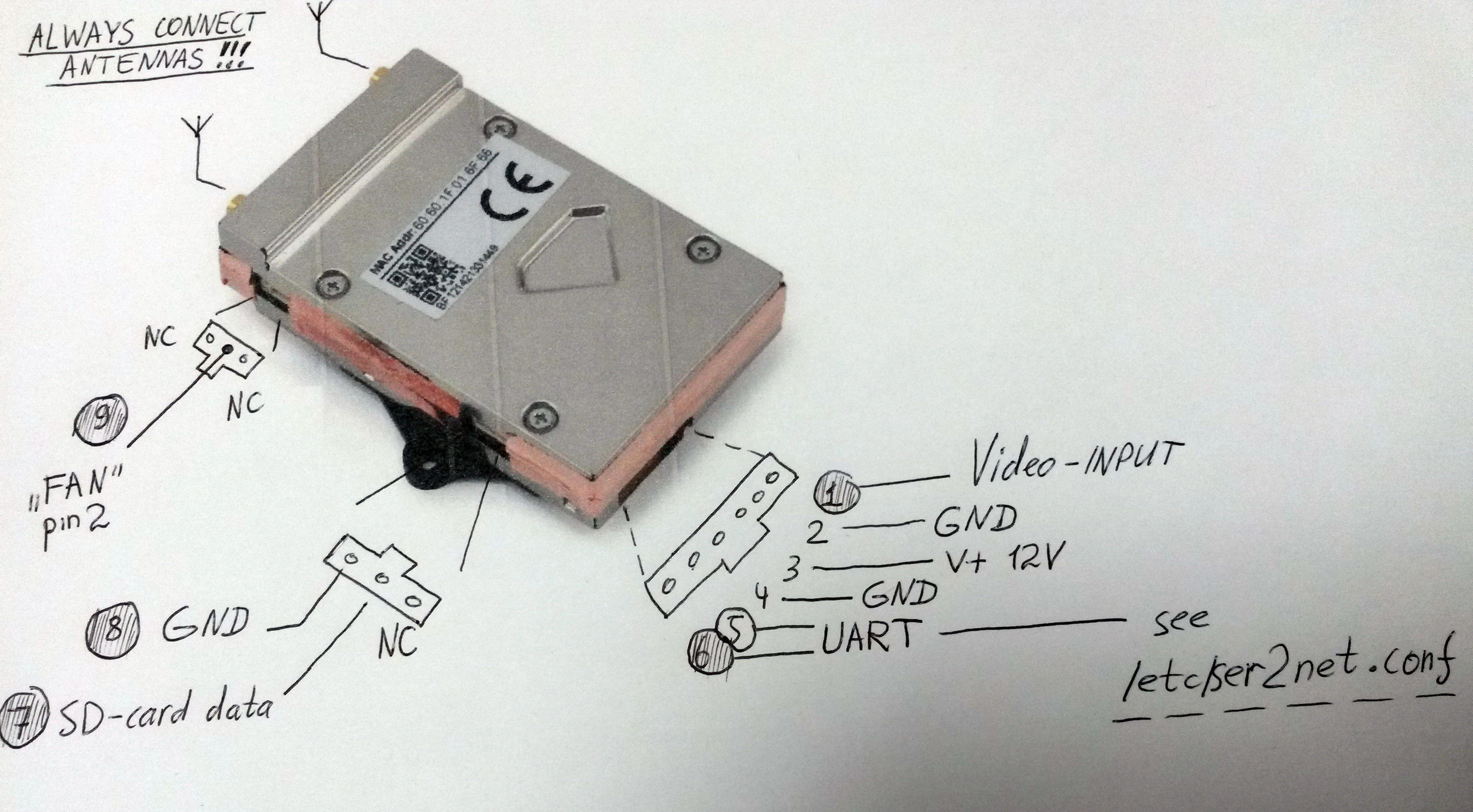

Looking for info. On the wifi module there is a 3 pin plug with only centre wire connected, in diagrams I've seen this short wire goes to a socket on the main board.
The plug on the module was marked fan, on another part of the main board there is a fan connector, no fan fitted on that model.Maybe P2 vision not the plus model ?
Is the single wire from the module a temperature sensor output from the wifi module. If so can you fit a cooling fan connected to the 3pin "fan" connector on the main board so you can cool the wifi module ?
