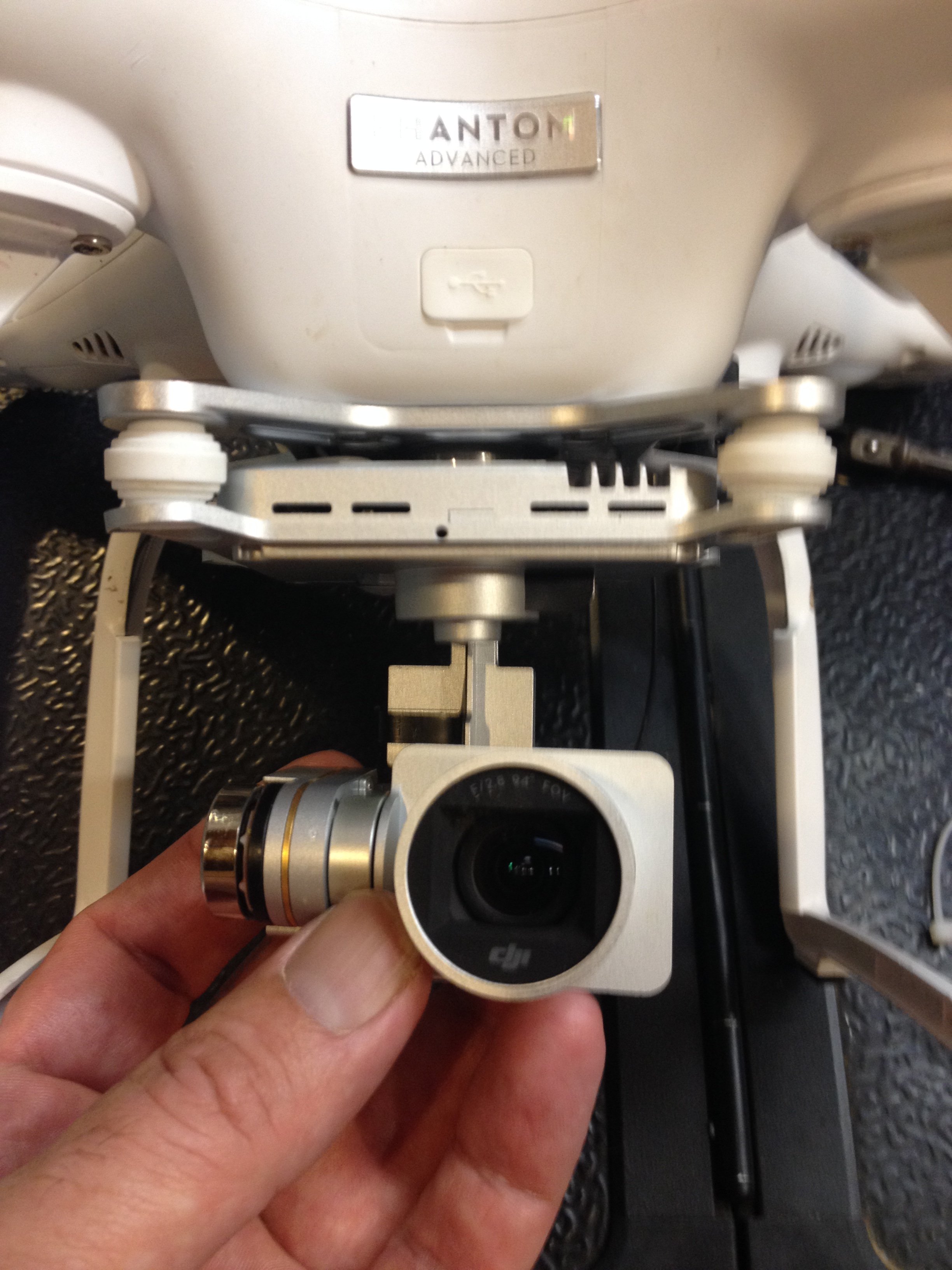

I had actually adjusted or messed with that while I was attempting to bend the gimbal.
I took the gimbal / camera back off, tried to do a little more tweaking and really focused on the Thumb Screw, I didn't know it was a (D-shaft?) but really wasn't focused on that at the time.
I don't think I got any straighter than before but this is what it is now. :)
I will take it for a fly after two gimbal calibrations.
And give you guys an update.
.View attachment 85799

Looking a lot better rod. Fingers crossed for the flight. Keep us updated [emoji4]

Well it got worse on Sunday, I think I got it to tight and it made the camera turned off of center. Later in the day when the winds calmed down, I tried adjusting the gimbal grub screw again, really focused on making sure It was straight with flat side of the shaft. The flight was good!
Last night I was going to another mission by dropping another 20' at my buddies house, the tablet battery was 1%. :rolleyes:
Thanks guys, its looking better now. ;)
