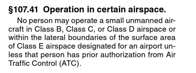

For part 336 you are required to notify them. As part of 107, you are not.
since hobbyists are not required to understand airspace, their only requirement to follow if they want to operate within 5 miles of airport is to notify ATC. In essence every pilot, whether sUAS or manned aircraft has to notify ATC in one way or another before entering class B, C, D, or E airspace.
In fact class B & C surface airspace generally extends beyond the 5 mile radius of which hobbyists by rule are allowed to fly in as long as they are outside the 5 mile radius, I don’t recommend doing so as you will get busted.

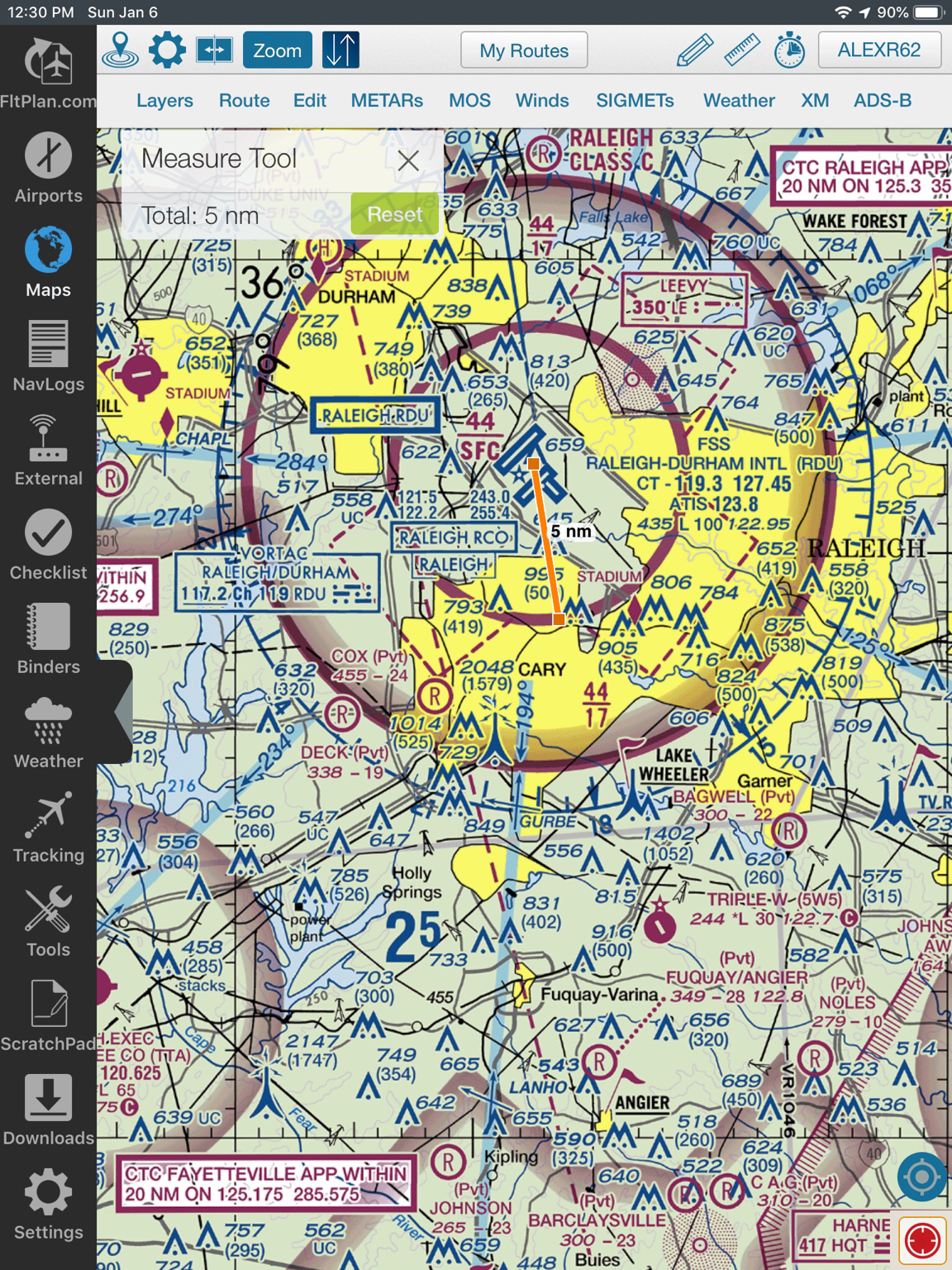

OK, thanks, I think I have it figured out. Where I am flying is just outside a dashed magenta line of the airport and maybe 1/2 mile from the prison. It is a park field designated for sUAS flying. I have no issue with warnings, but the message indicated that I was IN the class E airspace. The problem I am having is identifying my exact location relative to this dashed line. The sectional does not show ground detail and the Airmap does not show the dashed line. Is there another map I can find both of these?
I also have no problem with DJI telling me where I can fly and where I cannot, BUT if they do not do it accurately, it is going to create a problem and people will ignore the WOLF cry.
the only dashed magenta line signifying class E surface airspace close to Cary is the is the extension to lass C airspace for Raleigh-Durham International.

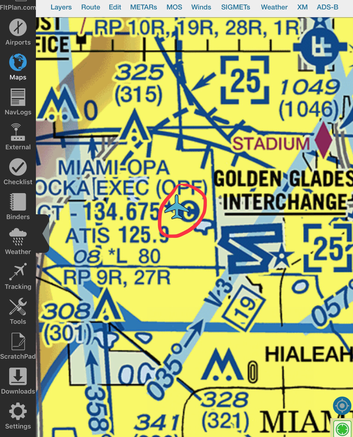

If you want to see where you are at with reference to a sectional map then download this app ‎FltPlan Go for iPhone go to maps on left then layers up on top and click on sectionals. You should see an aircraft pinpointing you location on the sectional.

The problem with airmap is they do not show the class e extensions. We are flying at Dorthea Dix park in Raleigh which is Under the 1700" class e BUT on the edge of the SE extension about where the inverted V 716 is. Where I live is due south of RDU above the word CARY. I have no problem there, but I haven't check recently.
I guess it is a good thing DJI is taking business away from Airmap, given their attitude and direction.
