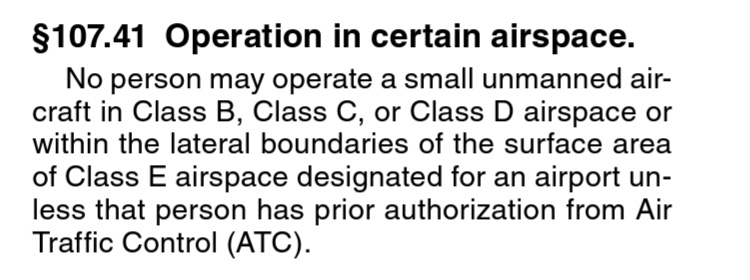

View attachment 107085 since hobbyists are not required to understand airspace, their only requirement to follow if they want to operate within 5 miles of airport is to notify ATC. In essence every pilot, whether sUAS or manned aircraft has to notify ATC in one way or another before entering class B, C, D, or E airspace.
In fact class B & C surface airspace generally extends beyond the 5 mile radius of which hobbyists by rule are allowed to fly in as long as they are outside the 5 mile radius, I don’t recommend doing so as you will get busted.

By rule hobbyists are required to notify ATC ONLY when flying within 5 miles of an airport, while part 107 has to contact ATC when within the surface boundaries of class B,C,D, or E airspace. Before LAANC, part 107 only way to get authorization to fly in these Airspaces was to submit a waiver which took about 90 days. I would bet a good number of part 107 who had a job lined up that couldn’t wait the 90 days flew anyway under the hobbyists rule. I think we could agree that most class B,C, and D surface areas extend beyond the 5 mile (I would assume Statute mile instead of Nautical mile). So by rule hobbyists could legally fly in class B, C, and some D surface airspace that extends beyond the 5 miles without having to notify ATC. I would not tell anyone to do this but you have to wonder how many times a day does this happen in these Airspaces outside of the five mile radius by hobbyists and part 107 flying under the hobbyists blanket. I think every sUAS pilot whether hobbyists or part 107 should contact ATC when flying within class B,C, or Delta surface airspace regardless of distance from airport. I also agree that hobbyists or part 107 should contact a heliport if flying within 5 miles of heliport. This is good practice to follow whether the FAA puts it in writing or not. I’m sure any helicopter pilot would like to receive information on anything flying within his flight path. I use current sectionals on the fltplan go app, Kittyhawk app, and purchase paper ones on mypilotstore.com
