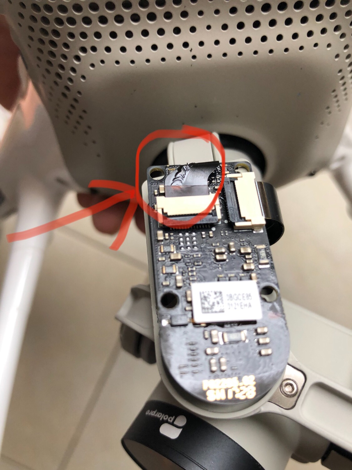

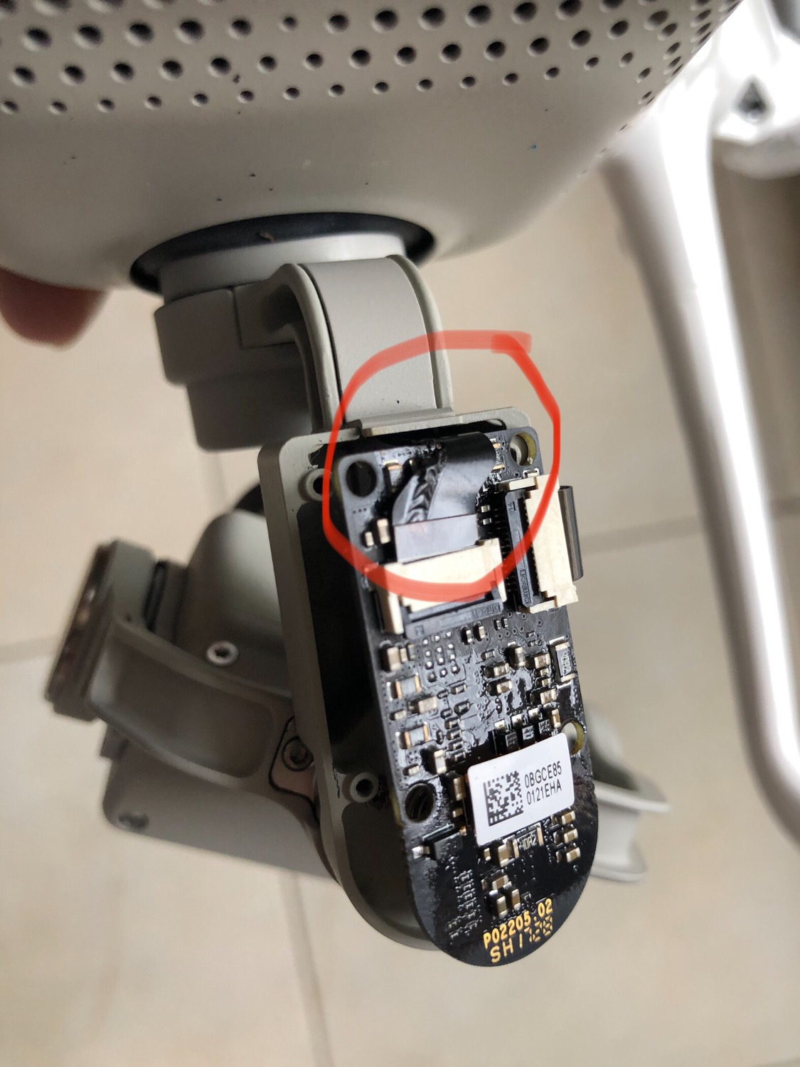

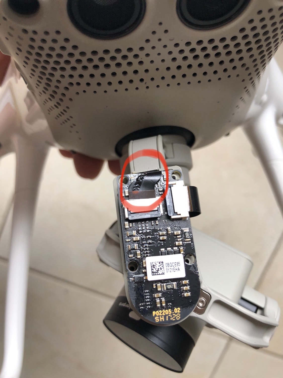

Other day one of the gimbal cables got burnt (check PIC). I was doing firmware update with gimbal guard, it took awhile so one of cables smoked (top ESC)
Please can anyone tell me which EXACTLY cable that is, so I can order it, and hopefully replace it by myself ?
This is Phantom 4 pro plus, btw.
Thx,

Not a seperate cable. Attached to the yaw motor. Have replaced a few already. Will need an inexpensive drone screwdriver set. YouTube videos available. Good luck.
Reactions: cneedelman
yes, yaw motor needs to be replaced. Be sure you use the original yaw motor casing
