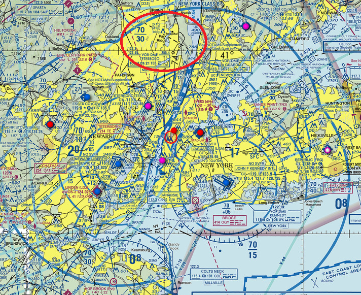

Thanks! I think that sky vector is just confusing me. So I would be able to fly in the New York area to the right in the outer Class B portion since the floor is 3,000 ft.
Another quick question, according to the FAA aerial map users guide, this blue circle is considered a NAVAID. Does this mean it is also classified as Class B Airspace? If so, I can't seem to find the ceiling/floor indicator.

I'm a private instrument-rated pilot, also hold a Part 107 license. The blue circle is just the compass circle for the VOR beacon 'Sparta' at the center of the circle. It has no airspace significance. Fly on.
I'm looking at the map you posted and don't see a floor indicator of 30[00] to the right of "New York" so if you could put a big arrow on where you are wanting to fly, or Lat. / Lon. co-ordinates, that would help.
The inner circle around New York is 70/Sfc so no flying anywhere in or around NYC without authorization.
My bad the way I wrote that comment was deceiving. I am saying that I would be able to fly in this circle for example since the floor is 3000 ft.
Hmmm, I don't see why not in THAT spot. Yes, the floor is 3000 MSL and a nearby obstruction (the inverted V right above "Park Ridge") has a top at 513 MSL (312 AGL) meaning the local elevation is 201 MSL so adding 400' gives 601 MSL, well below the 3000'MSL ring bottom. But beware that in many areas inside the 70/30 "ring" are other airports of Class D & surface Class E areas
I'm sure if I'm mistaken someone will chime in, but from a pure FAA 107, Class G perspective, yeah.

The red circled area is definitely Class G, good to fly under either set of rules. Just don't forget to check for any NFZ or TFR areas.
