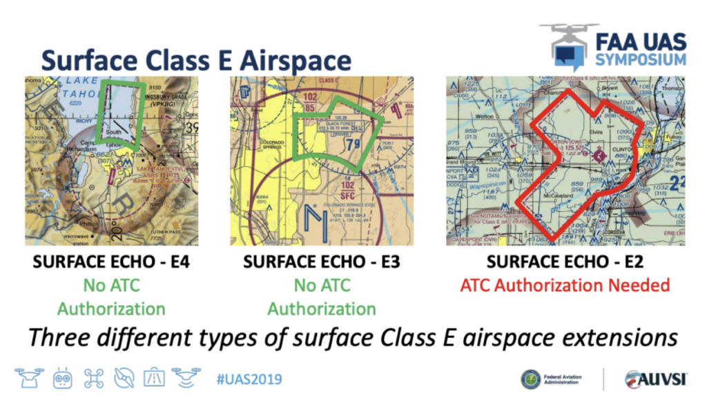

You should be OK with Class E. I had bookmarked this a while back that may help.

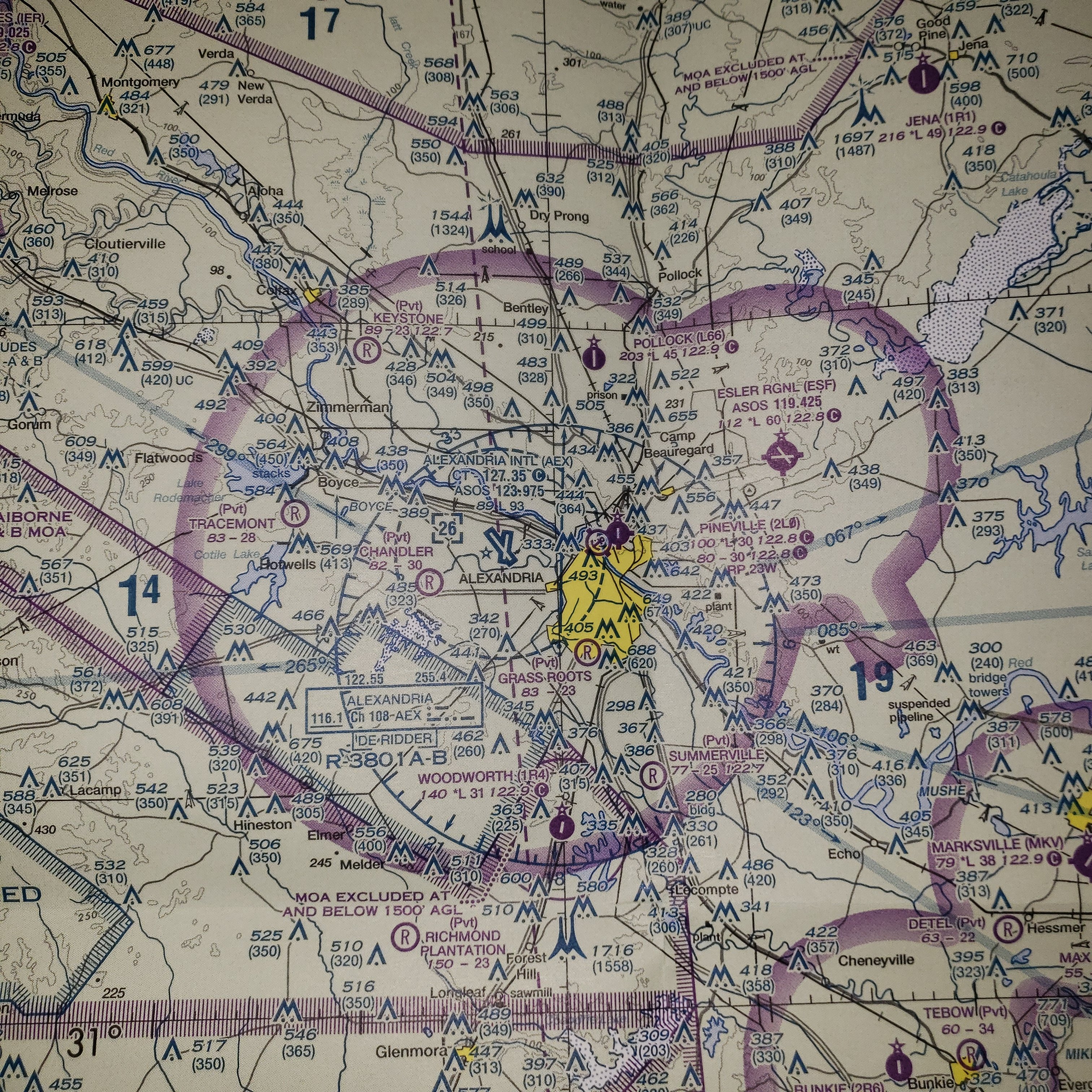

Yes it's a Phantom 4. Went to fly yesterday. Using B4ufly. It showed cleared for take off in green. No active advisories. It showed 1.5 miles from Pineville Municipal Airport ,1.08 miles from Rapides Heliport, 1.87 miles for Va medical Center Heliport and 2.00 miles from Alexandria International Airport Class D and 2.79 miles for Troop E Police helipad.
When I crank up to fly I get
Safety Notification
Your aircraft has entered an enhanced warning zone ( Airport).
Please fly with caution. To continue your flight please select.
I agree to bear full responsibility for my flight in this zone O
Yes
I click yes and fly. According to the sectional chart from what I can tell it is Class E. Looks like to me we have two classes of airspace. We have a large area that class E covers and the class D. It is inside the class E. The class covers a large area. Just about anywhere I want to fly. Anymore advice appreciated. I live right at the top part of the yellow area that shows Alexandria.
