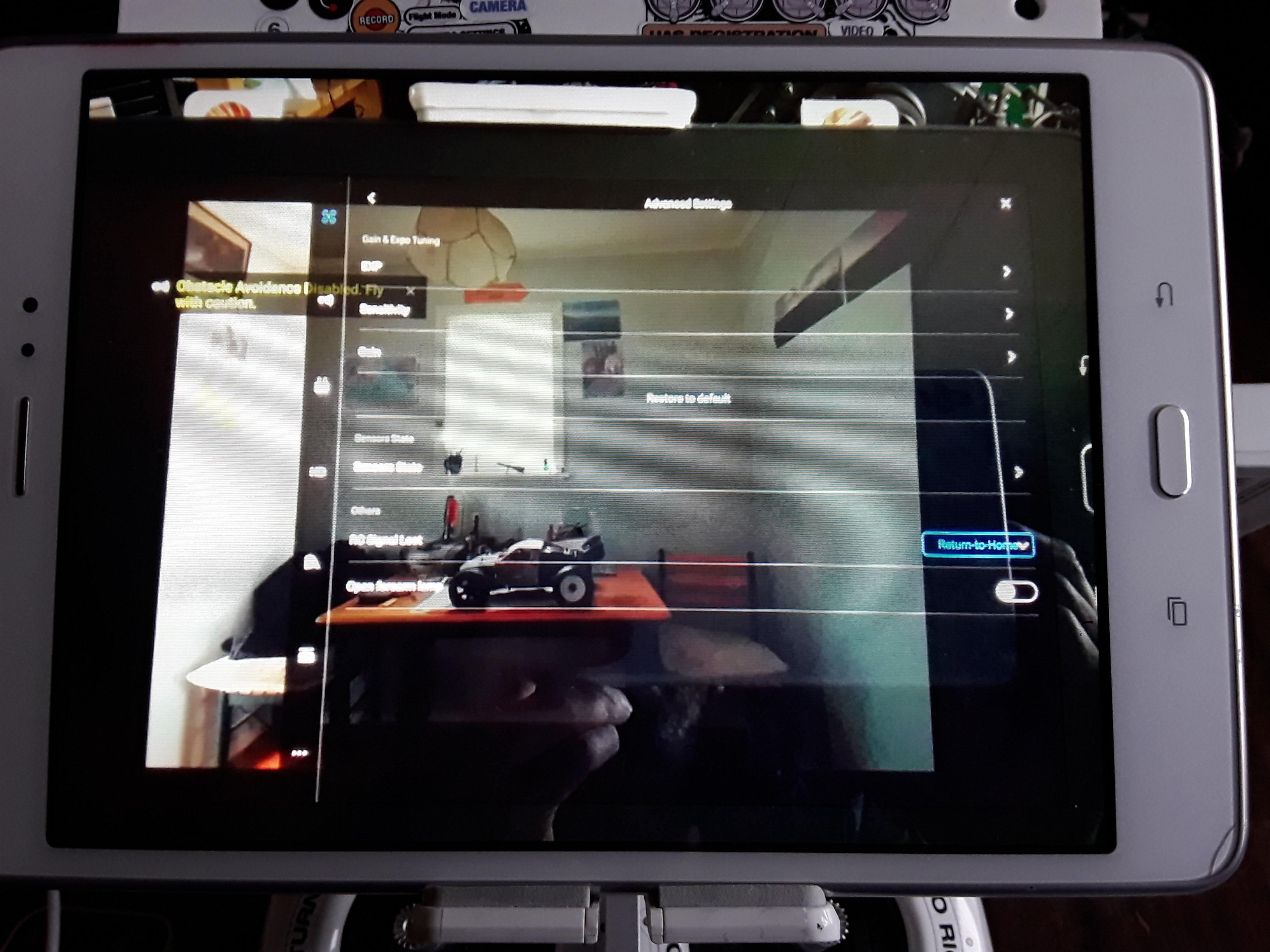

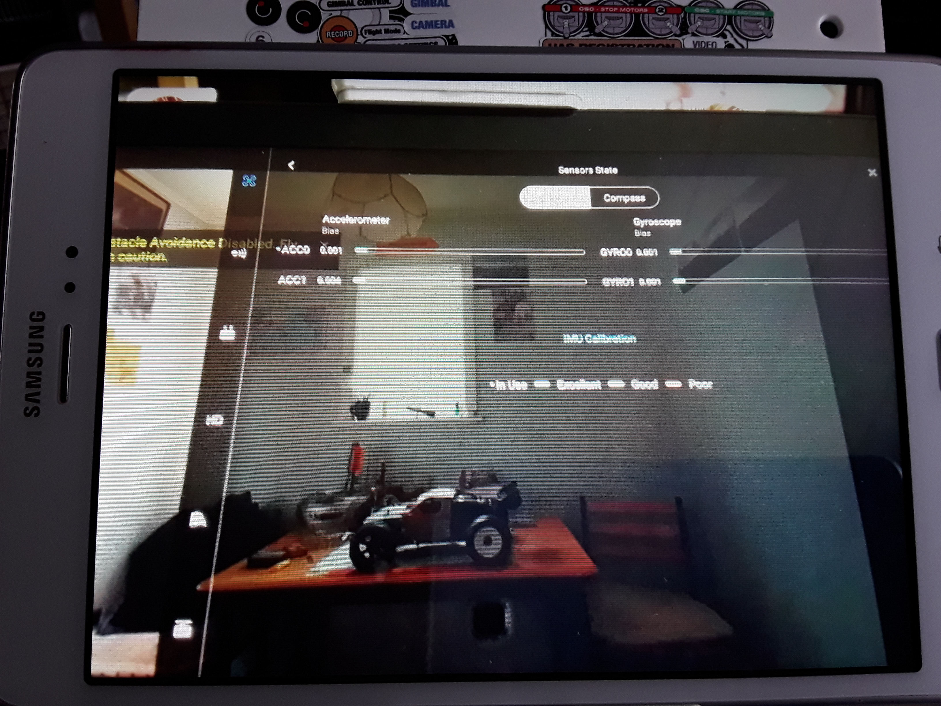

Hi are you saying you cant click on compass or imu at all,everthing working,lights ,camera move ,do you have a camera veiw
Heres pic just incase you not find,,click general settings,,click blue icon,under sensors state,imu or compass comes up,,do you get this image on your device
once you click compass you can calibrate,has onscreen help so cant go wrong

Heres pic just incase you not find,,click general settings,,click blue icon,under sensors state,imu or compass comes up,,do you get this image on your deviceView attachment 87587 View attachment 87588once you click compass you can calibrate,has onscreen help so cant go wrong
Appreciate that picture thx. I did run through that with the guy from the dji Store and it threw up a possible problem with Compass 2. He then suggested I do a firmware refresh which didn't fix the problem. This could turn out to be a hardware fault with compass 2 and it'll need to be repaired or replaced under warranty. My issue would be that if Compass 2 is broken, why not say that's what's wrong. Why simply repeat that I need to do a Compass calibration when that's never going to work. The dji Go App seems to be able to recognize there's a problem with Compass 2 but spuriously spams me with a request to calibrate the app. Beyond annoying!
