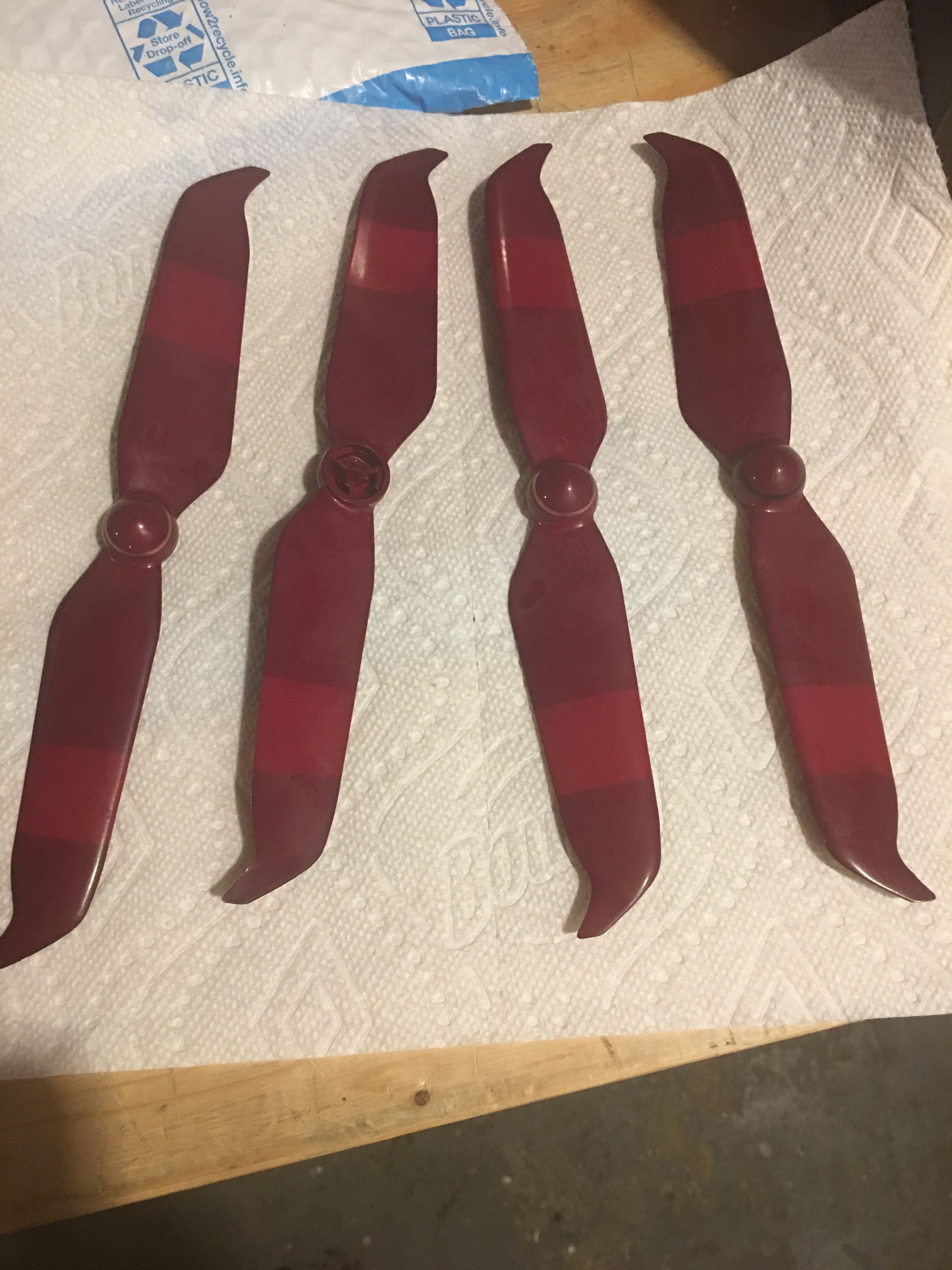

I dyed brand new props to make them stand out a little bit. I have balanced them as well to avoid any issues while in flight. I wonder if the dye will prolong the life of the props.
