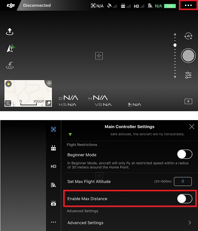

There was a recent firmware change that can restrict the max distance to 50 meters (164 feet). If 164 feet was really the max you were reaching, then check out this post for more details. If you really were able to reach 500 feet, then try disabling the "Enable Max Distance" setting in DJI GO.
