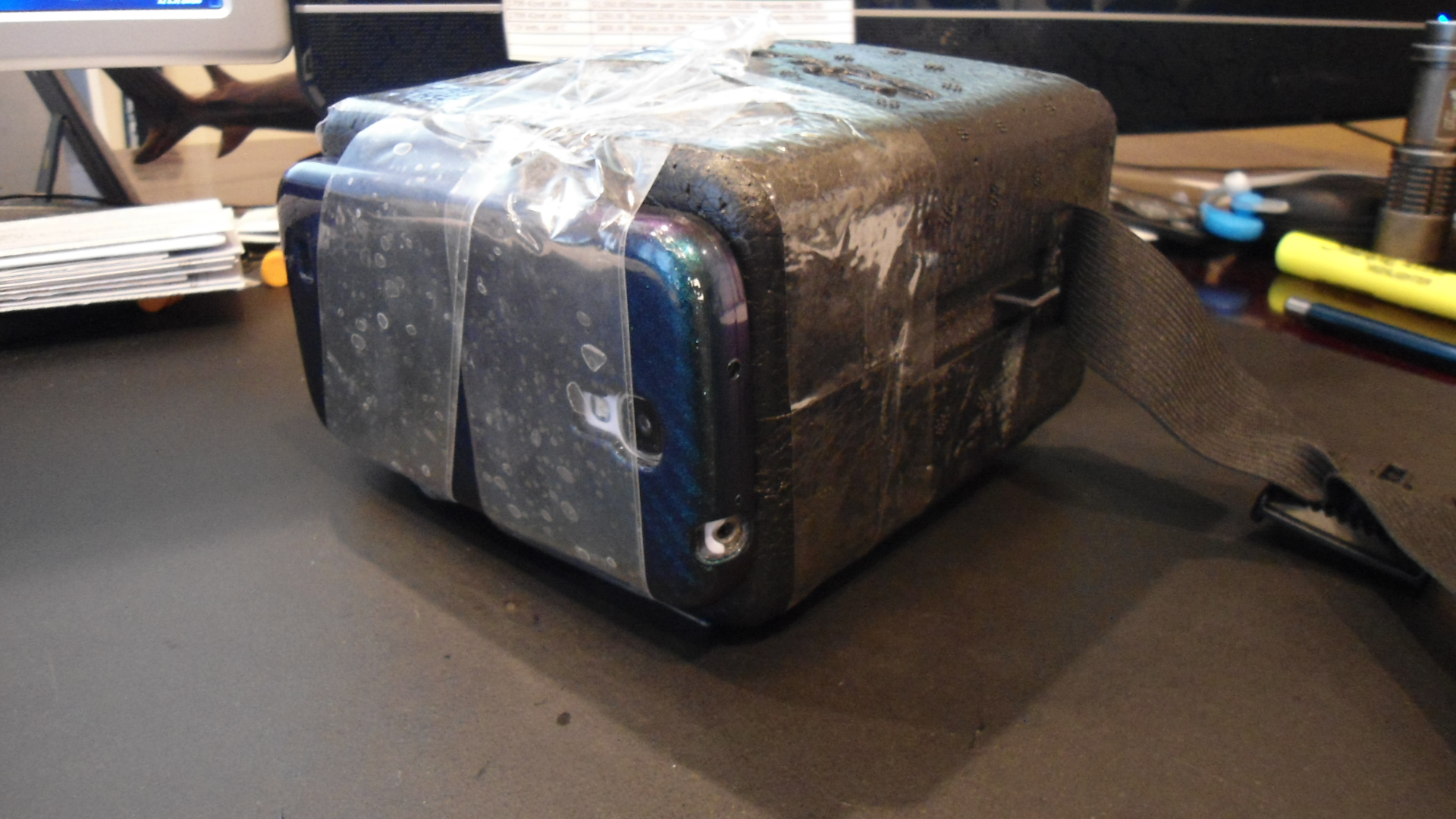

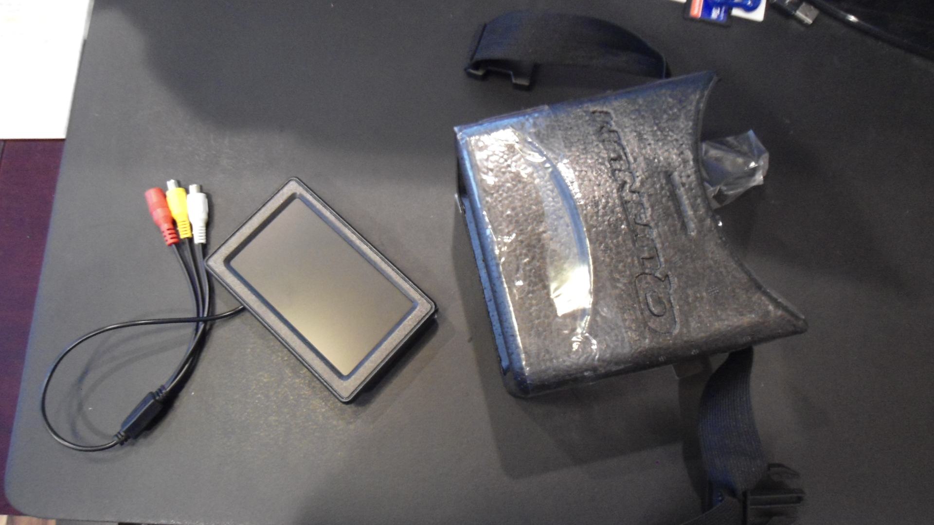

Yes, the goggles with 2 lenses need a double image that has been distorted so it looks normal when viewed through the round lenses. The one I ordered has a nice ski goggle style foam face gasket and glass lenses. The other option is to use something like a box with a Fresnel lens. I just flew with my old Quanum. I just removed the stock screen it came with and taped my phone to the front. I uploaded some photos. The image was not quite as distorted as it appears in the photo. BUT it was not exactly clear either. I can see me eventually using something like the Quanum with a larger Fresnel lens and moving the phone another inch or two further away. The screen in the Quanum is smaller than my Galaxy S4 phone so the Fresnel lens was undersized for viewing my phone. I am about to get the larger Galaxy S6+ so I will definitely need more distance and a larger lens.
