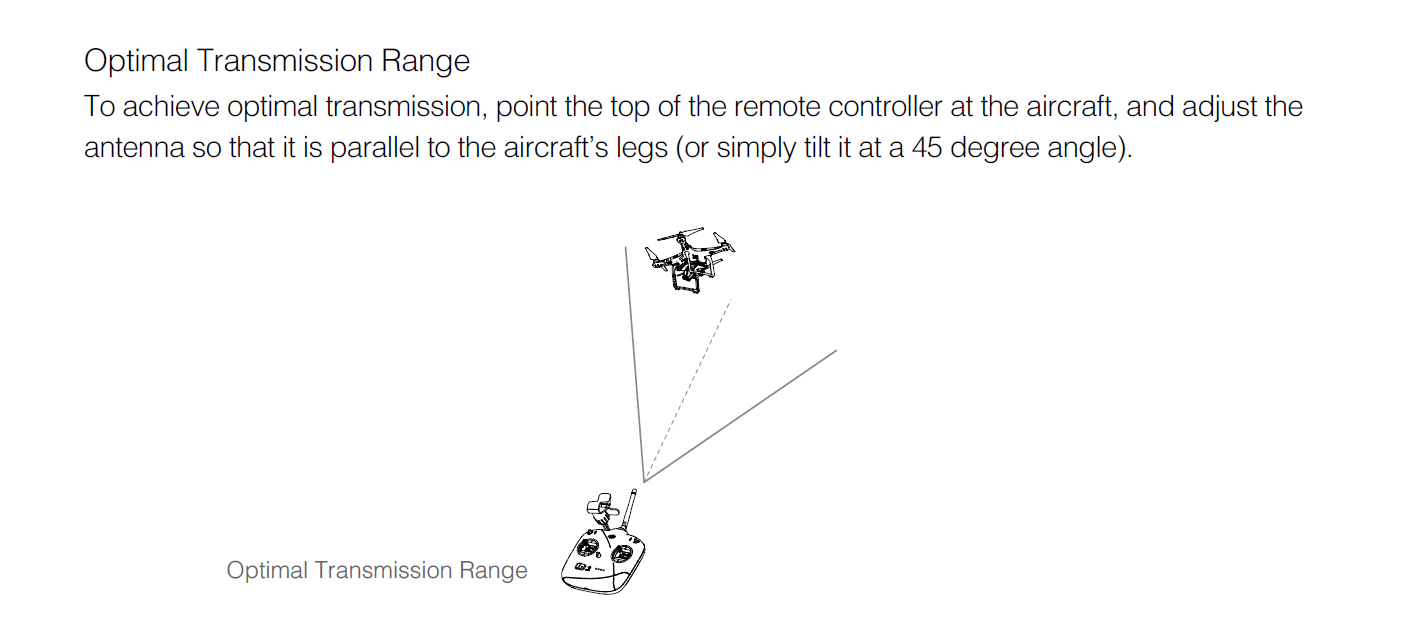

With that limited amount of information, it will be difficult to help you, but is your antenna oriented correctly? First step.What range should I be able to get? I am only getting about 150 ft high be for the app says that the signal is weak or the video is lost.
