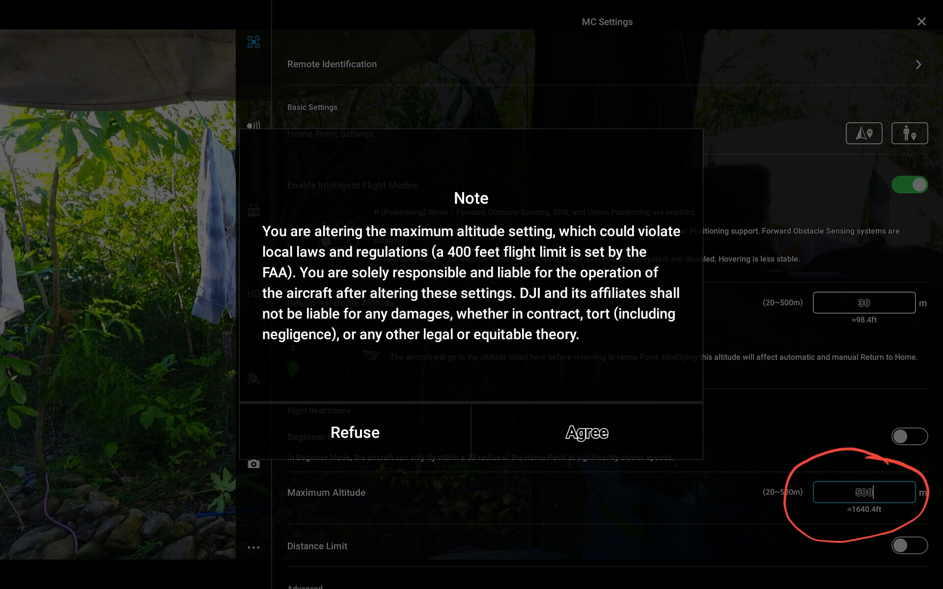

Here screenshot,,me put 500mtrs here in red circle and you get this prompt...1640 is max for software on board drone

In DJI GO 4 with all powered up set max altitude to 500 meters. You then can fly up-to 1640 feet above takeoff point. Keep under 400 feet above ground level per local regulations.
