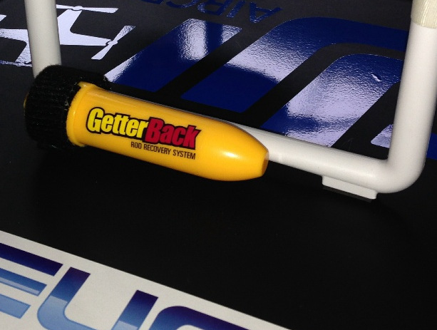

Ok, is it me or does that image make that thing look like something someone of the female persuasion would order thats shipped in a plain brown wrapper from a adult store? "Rod Recovery System" on the side? Seriously?
Seriously? Who cares what it looks like or says? Drone hits the water, sinks past five feet and a chemical reaction pops a highly visible floater attached to 100' of line - its not rocket science and costs about the same as a few beers.

After it sinks past 5 feet and triggers, it's fish food anyway. What's the point...
Time to buy a new bird.

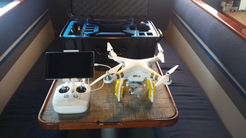

This is what I've done. Keychain floats from West Marine zip-tied to legs. Then it still fit in my case too... Had no noticeable impact on performance. Luckily during my flights over the Bering Sea I did not get an opportunity to test if these would actually float it, but they are very buoyant so my guess is they would have.

Why not test the floats? Take the floats off the Phantom, tie them together and start adding weight to them in water. You could use 1/2" drive sockets to incrementally add weight. Weigh the Phantom and compare the actual weight the key-bobs will float. I think the Phantom weighs about 2.8lbs, so if the key-bobs will hold 2.8lbs of 1/2 sockets, you're good. However, I'm not sure it will save a Phantom if it gets totally soaked. Recovery may not accomplish much unless you have insurance (which isn't a bad idea if you fly water much).
Nice idea though, inexpensive! Let us know how viable it is if you validate the concept.

When i first looked at that pic i thought you keep my phantom in a picnic basket :-)
Nice neat installation there.
Was there any percieved difference in flight performance?

It must have had a performance impact but it was imperceptible. The weight of the keychain floats was almost nothing -- I imagine they undoubtedly increased drag but not by any significant degree because it seemed to have no problems getting up to full speed in short order.
Yes indeed that would be a good way to test. I was too lazy to try that.
Regarding recovery of a drowned P3, they can be salvaged -- a person I know crashed theirs in salt water, scooped it out and flushed with fresh and let it dry for a month strait. Battery was toast but the bird was fine and still is to this day... so it is possible to salvage them, even from salt water.
