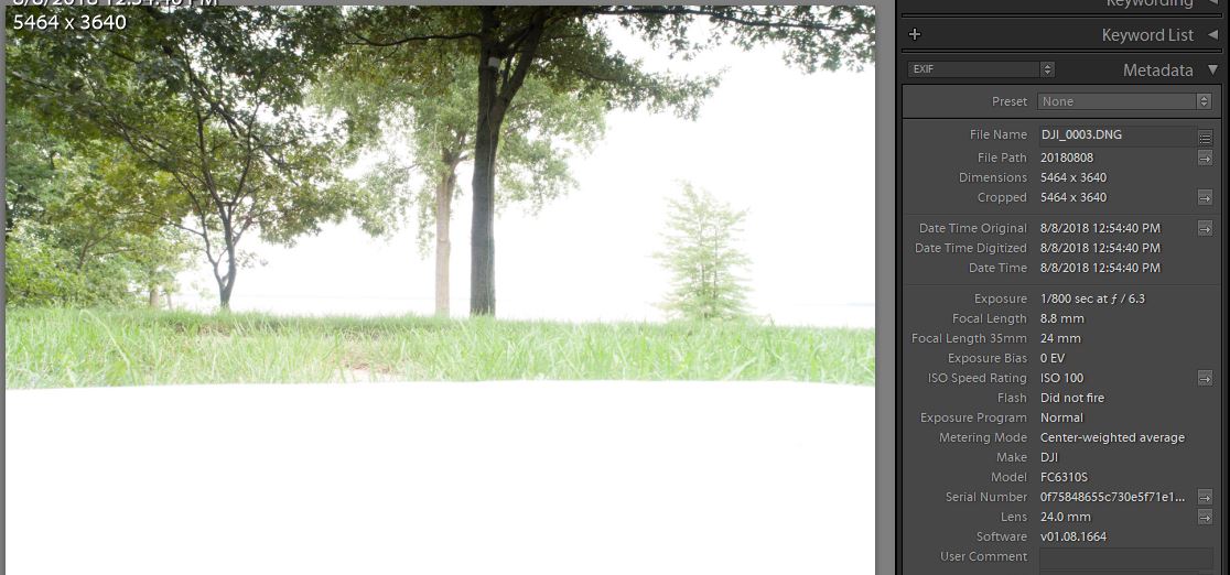

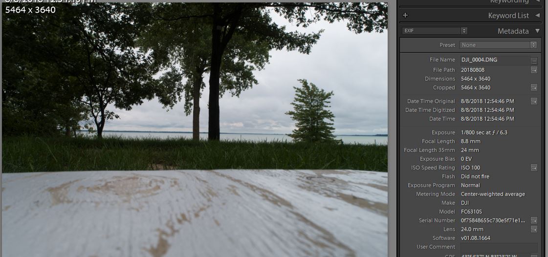

Can you post your EXIF data for the washed out photo?
Did you update your firmware? This may also clear up the issue.
Hi ryantrax,
I'm not sure how to extract the exif into text. Attached are screenshots from Lightroom

It is possible that you have a bad mechanical shutter. If the shutter isn't actuating fast enough it would let too much light in causing the issue shown. Maybe roll-back to the previous firmware version using DJI Assistant 2 and see if it clears it up. Other cases of this that I've found have happened after a firmware update.

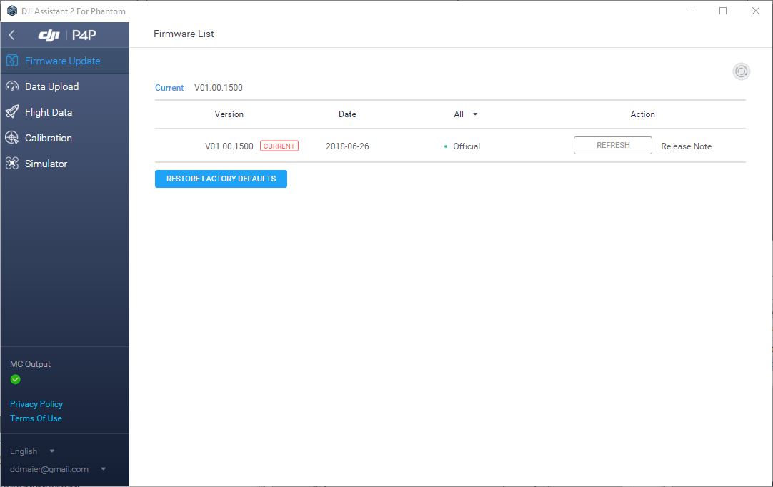

ryantrax,
I can't figure out how to downgrade. The Assistant 2 only lists the current version. This is the v2.0 version of the Phantom Pro 4, I'm not sure there is a previous version.
Dennis
ryantrax,
Dennis
It is normally listed right below your current firmware version in the assistant. What is your current version?
View attachment 102232 ryantrax,
Yes, I understand that, problem is, there are none listed.
You're absolutely right there is none to roll back to... Hmmm, and I take it the refresh option didn't help? Sending it back to B&H would probably be the fastest way to get a replacement, the DJI turnaround time is a couple weeks.

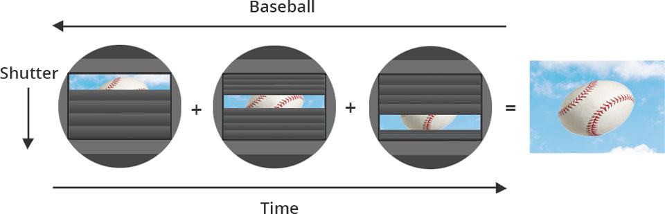

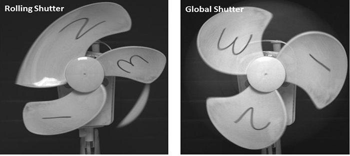

Yes it is important. Attached pics are examples of why electronic/rolling shutter is bad in some scenarios - You paid for mechanical shutter, you want mechanical shutter
I'm gonna fire my P4 up now and see if mine does the same...brb :p
EDIT: No difference between rolling or mechanical on mine... looks like you need to get it swapped :(
rolling-global2.jpg warp.jpg .

Thanks for the picture examples, they are very helpful in understanding the deference in the shutter modes.
