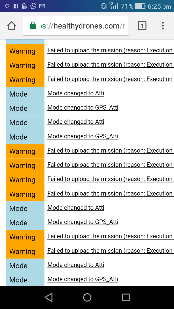

View attachment 70972 Litchi really annoyed me today. Started at 100% battery and time after time all I got was "mission failed to upload" FFS. It's done that mission so many times and when the battery got to 87% I gave up. Litchi is really shît now for way point missions

Were all the mode changes you ot was litchi doing that?
It was litchi doing all them changes. Quite risky as it could be a fly away

That looks like what mine did, it did it once and I just took it out of f modd after it failed to continue so I brought the bird back, that's aloooot of mode changes , something is very odd with litchi now o_O
