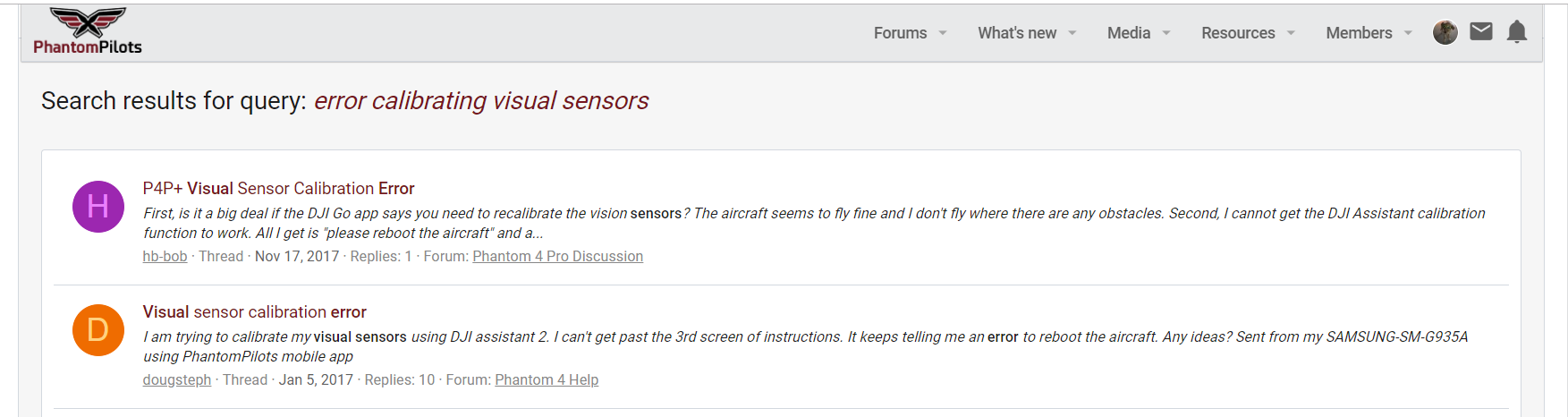

Depending on what is happening for you, there can be issues with windows and you might want to use the search tool to see if any of the posts can help you. I had the dreaded "please reboot the aircraft" and it turned out to be a windows issue but I can't remember exactly what fixed it, but I think it was disabling driver signing.
