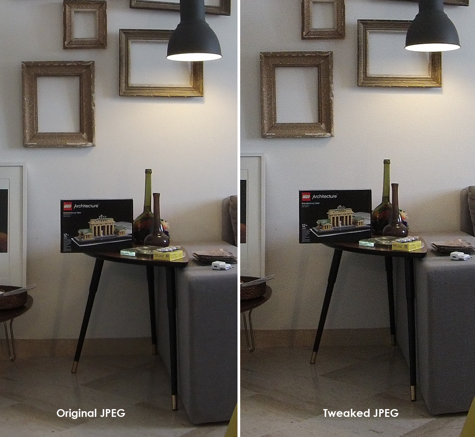

Here is some more tests with these commands :
t ia2 -adj tidx -1 0 -1
t is2 -shp fir_mode 0
t is2 -shp fir 10 0 0 0 0 0 0
t is2 -shp fir_mode 1
t is2 -shp fir_mode 2
t is2 -shp fir_mode 3
t is2 -shp spat_mode 0
t is2 -shp spat 5 5 50 255
t is2 -shp spat_mode 1
t is2 -shp spat_mode 2
t is2 -shp spat_mode 3
t is2 -shp level_min 50 5 10 30 160 5 30
t is2 -shp level_all 20 5 5 5 160 5 5
t is2 -cnf enable weak
I basically tried to reduce/disable every noise reduction or sharpening filters (base setting was standard sharpening)

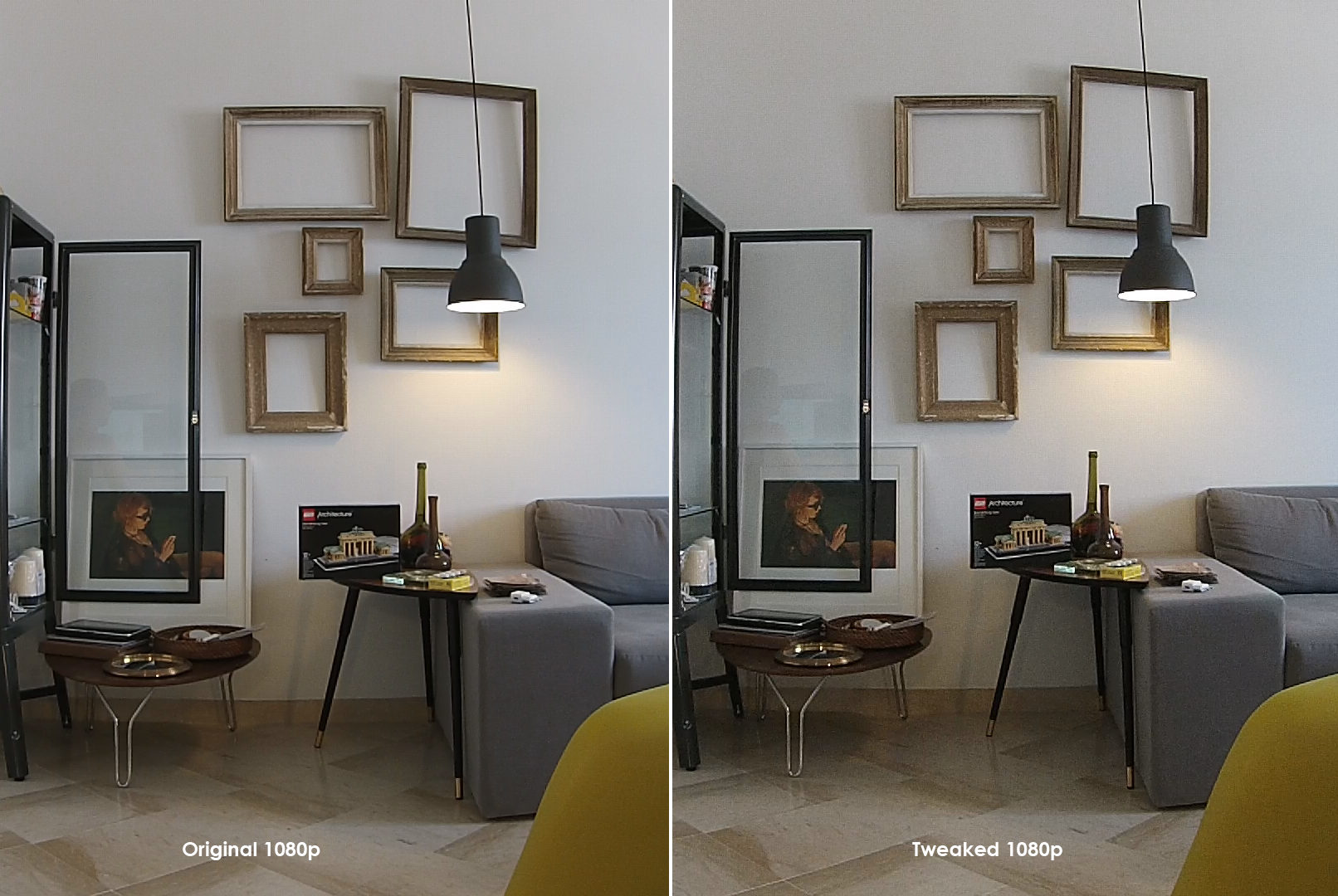

All at once they give these results :
View attachment 26968 View attachment 26969
Cool. But what I can see from these tests is that only noise reduction has been disabled,
but the amount of sharpening stays the same, therefore still a high amount of visible noise.
"Original" looks like Standard and "Tweaked" looks like Hard. Hmmm... :confused:
Perhaps there is less sharpening in the tweaked images, but very difficult to know as you compare them to the Standard mode. Would be easier to see if Hard was the "Original" (as it is free of NR). :)
