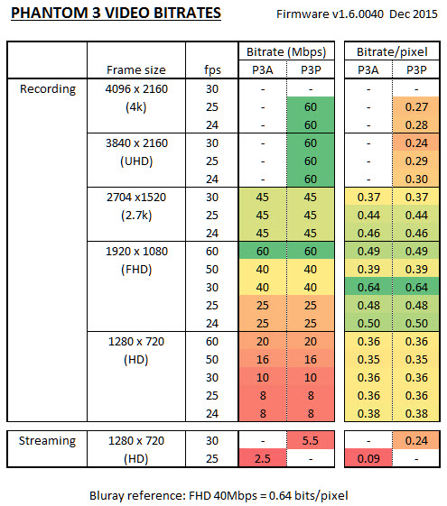

I do however reference this chart for info. Note that I didn't put this together, but got it here on the forum. Unfortunately I don't recall who put it together.
As far as I know yes, the P3A is only 60Mb/s when using the 1080p60 setting. Full disclosure - I have only personally tried the 1080p60 setting.
