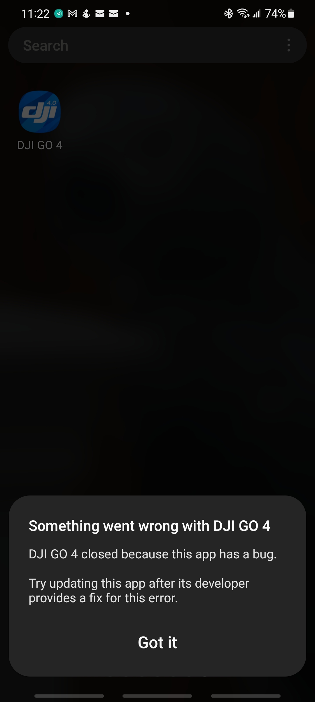

I just loaded the t mobile samsung software S21 update today and tried to open my DJI GO 4 and my DJI GO apps after installing and both came up with error saying bug found and would not open. I have included a screen shot.

What versions of DJIGo and DJIGo4 are you using? Is it possible that they need updating?

I had originally downloaded from Google play store. After i installed the latest upgrade for my S21 Ultra I restarted my phone and opened the DGIGo app and would not open same for DGI GO 4. Next step removed both apps and re-downloaded the apps and same result, got the error about a bug in the software.
Finally I went to the DGI website and downloaded both apps and they are both working.

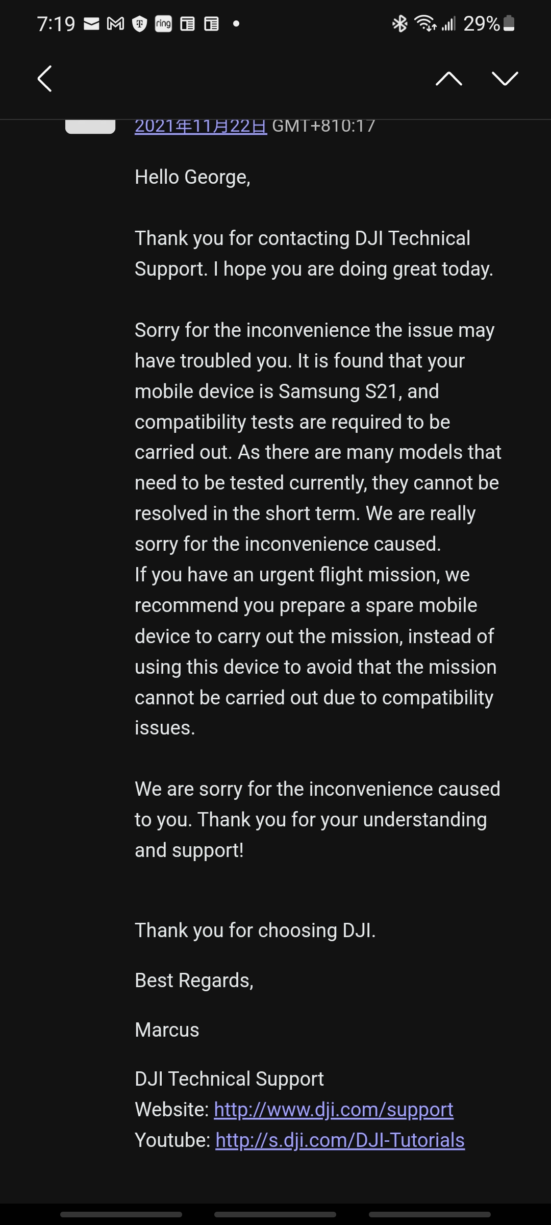

The android update is version 12 which was launched ln November. I went drone fishing yesterday and could not get the app to open.

The same thing happened on my Google Pixel 3. Djigo4 stopped working after the "automatic" upgrade to Android 12. I deleted the app, and found the app on playstore, dl'd it, installed, and it would not work. After a lot of time figuring out where to find it on DJI.com, I managed to download the APK file. It installed on my phone, and seems to be working. I will test it as soon as it stops raining tomorrow.
Thanks for your input, after I download from DJIs web site I thought everything had installed correctly although when I took the p3 drone fishing I could not get the app to open correctly. I worked on the security settings in my s21 today and finally made progress. P4 seems to connect without issues although my two p3s will only open if I act like I just installed the app. The app even makes me take the 10 question quiz before I can open it. I did a test flight and everything worked. 🙃
have you reported this to DJI? Since it happened with both my Google Pixel 3 with Verizon, and your Samsung T-Mobile, I am relatively sure it is a problem of the Android version 12 and DJI.

its every DJI app that doesnt work currently with android 12 on a lot of phones, DJI have been made aware via the forum i beleive
