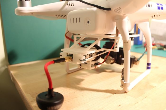

Oh and last note for those interested. I just released my FPV undertray too:
Seperate thread can be found on the Phantom 2 forum area: viewtopic.php?f=19&t=8455
