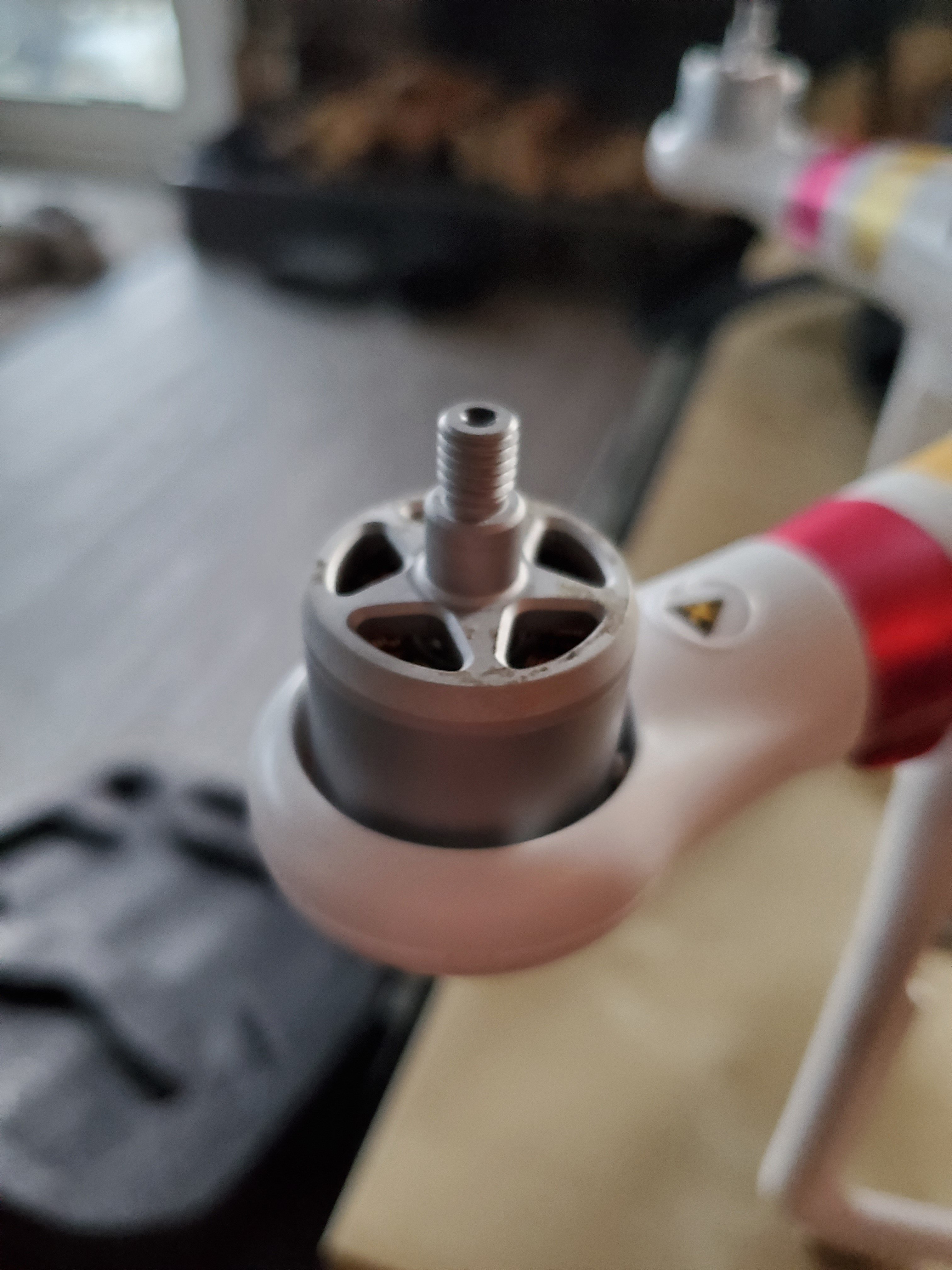

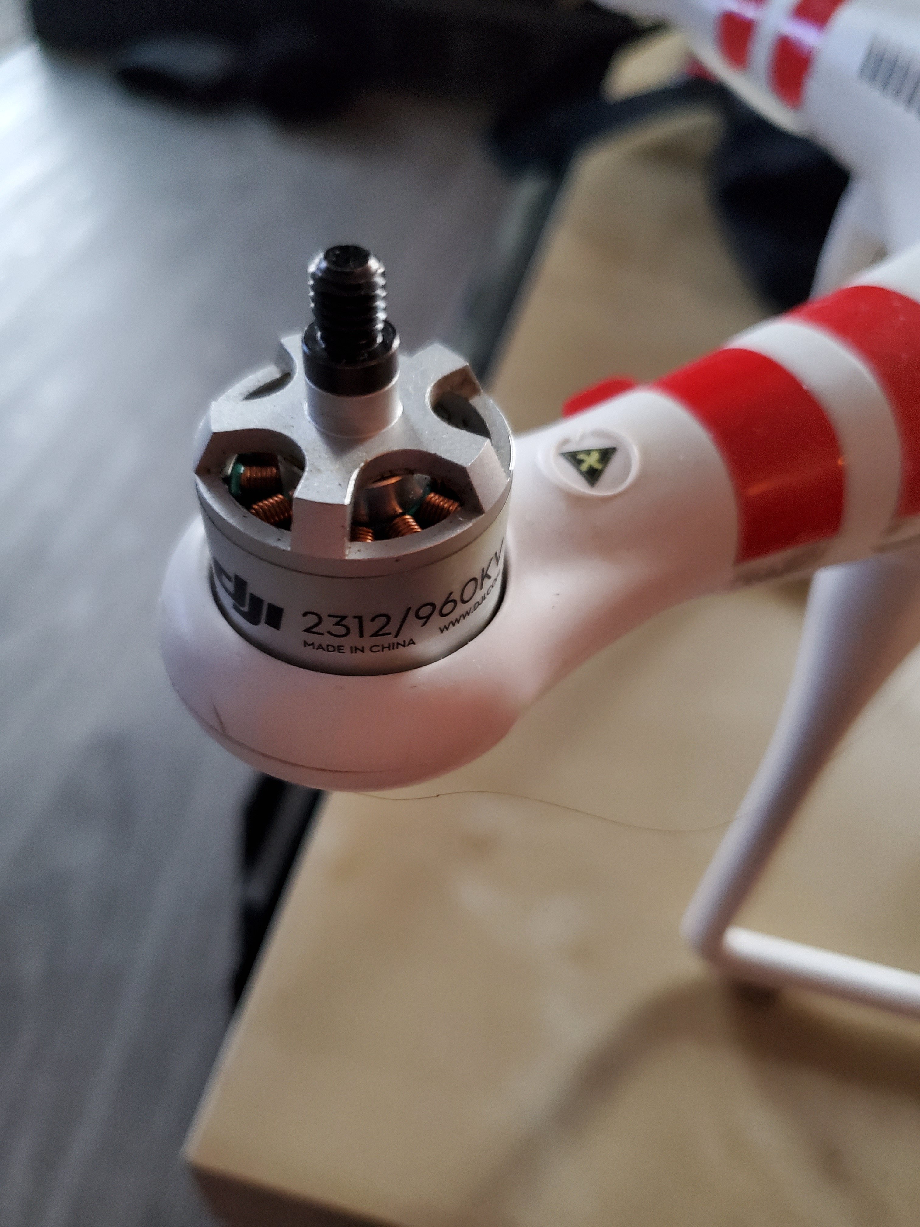

Here's the pics:
Here's my P2, old style 2312 motors, same motors on my Brother in law's P3P.
Here's my P3P.
They dont look the same ? and from what i remember someone tried P2 motors on a P3 standard and they wouldnt lift the quad off the ground.
All the P2's used the 2312 motors. Some P3's used them and some used the newer 2312A motors. The ESC'S and main control board are different for each motor type and are NOT interchangeable. Meaning you cannot use the newer 2312A motors on a P2. On a P3, you must use the same type of motor that it came with. If the P3 had 2312A motors and you tried to use a P2 motor it wouldn't work.
