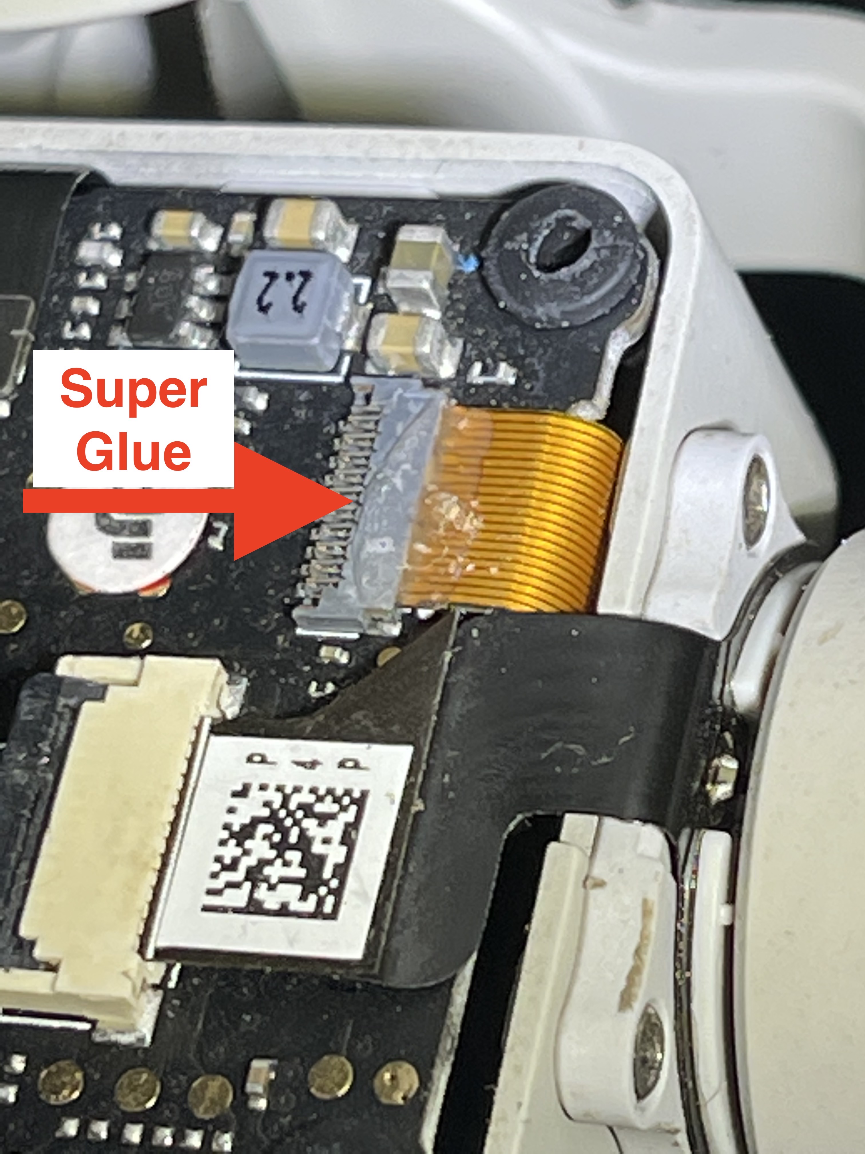

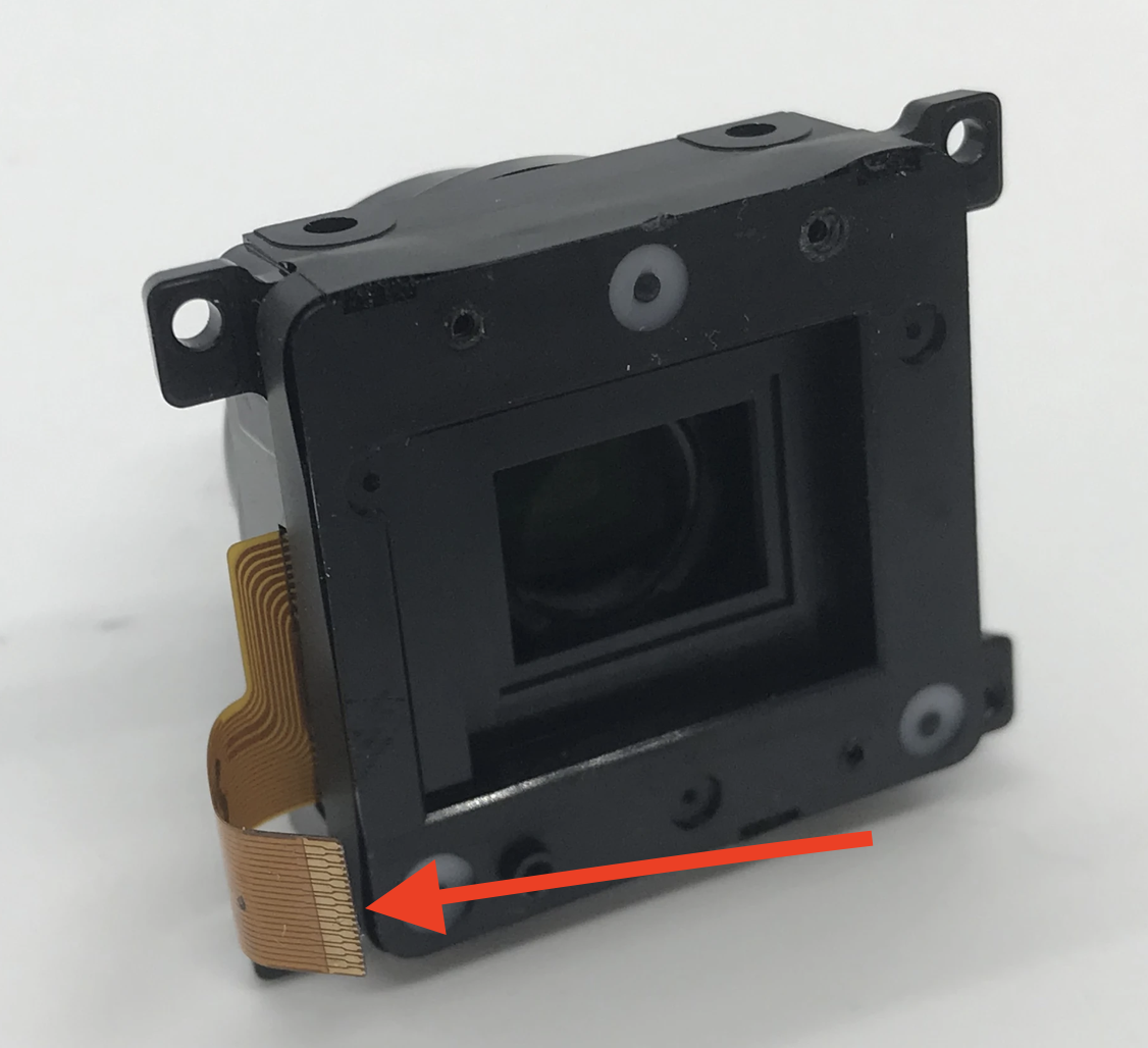

I think I found my issue. Whoever got into this an tried to fix it loved to use super glue. When I replaced the gimbal flex cable it was super glued into the main board. I was able to get that released and replace the cable and now I got the camera back. So looking today I seen that the cable that comes from the camera lens is superglued into the IMU because the tab that holds it was broken off. So I am going to order a new IMU even though mine is ok but missing the clip and then a new camera lens to see if that fixes it. See the pictures I attached. Im crossing my fingers this fixes it.

Focus is achieved by varying the distance between the lens and the Image sensor, controlled by the software tweaking this physical relationship. If the image lens distance cannot be changed due to damage this will cause a permanent focus problem. Changing cables is unlikely. To have anything to do with the problem.
Out gassing from the superglue will fog clear optics. It is permanent on plastic and will damage coatings on glass lenses.
Reactions: tribar
Without that locking tab, no way it will work correctly. Surpised you got any connection at all. I’ve replaced that tab on boards in the past but yours is toast. Believe you have solved it, including the new lens cap. ?
