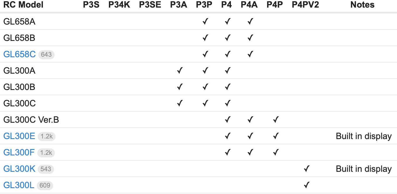

I've just checked the model number in the controller and it's GL 300L. I also got DjJI assistant to accept that the controller was plugged in and the only firmware option listed was VO1.00.5200. P4P RC for Phantom Pro V2.0.
I'm wondering if I've actually been given the wrong controller for my P4 ? Would a P4P controller be compatible with a P4 drone do you think?

Yes... you have the wrong controller. The GL300L will only work with the Phantom 4 Pro V2.
Its amazing that you ended up with that one...... because almost any other remote would have worked with your drone. Take a look bellow at the line for the P4:
Phantom 4 Compatibility Chart - Drone Help Forum
Reactions: tunadoctor
