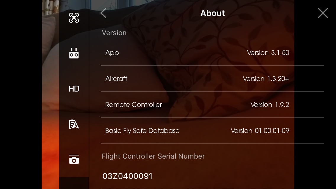

According to the DJI-GO App I'm currently running firmware version 1.3.20+ which I have concluded does NOT support the Intelligent Flight Modes even though DJI Help haven't confirmed this to me.

Looks like you are not on most current version for the aircraft assuming you are using P3P.
If your app is V 3.1.50
Aircraft should be V 1.11.20
RC V 1.9.2
Mine is working perfectly with no problems at that level for a long time now.

ok so according to DJI, if you are the advanced there are
v1.4.0010
v1.6.0040
v1.7.0060
v1.8.80
v1.9.60
v1.10.90.
v1.11.20
so you are 7 FW's behind, you cant just update to the latest as this will cause issues, here is a link to the list of FW's
Scared need to update 1.1.9+
Im guessing that you will need to update one at a time until you reach the highest, from what i can see up to 1.76 is done via the SD card method in the quad and the USB key in the transmitter, after that you use the app to update.

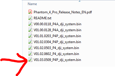

Assuming a Phantom 4 Pro:
App: v4.0.8
Aircraft: v1.3.509
Remote: v01.04.01.00
Never update from these, and you will achieve unprecedented reliability and independence from the DJI mother ship (no tests, no logins required to fly).

I don't know if they use the same firmwares. Because of the different cameras, I'm tempted to say "no." Below are the screenshots of the .bin files (firmware) I have for my Phantom 4 Pro. The arrow points to the version I use:
You might compare this list to Phantom 4 firmware versions. OR...as those in this list which versions they are running on their Pro and non-Pro P4's. As you can see from the arrow, I'm running version 1.03.0509. It would be interesting to see which versions other P4 and P4P users are running.
