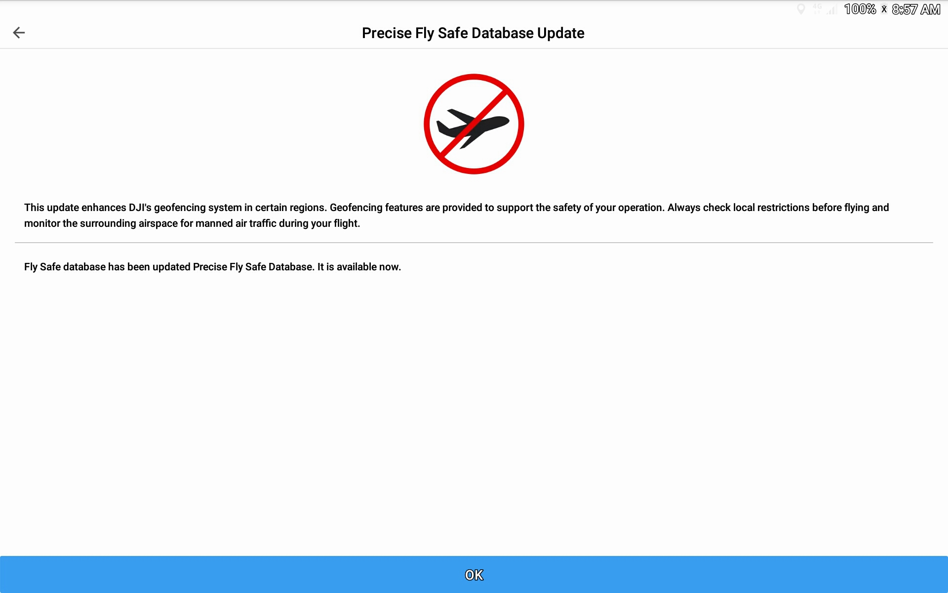

Update success ,turn all on,when prompt shows onscreen hit update,with all still on ,remove usb and stick it in usb on drone,(might need OTG adapter,makes mini to mini usb)update loads.not know why this work now but did email dji on this issue,NEC MINIT it works ,hope this help some of you having this annoying prompt,
Reactions: GadgetGuy

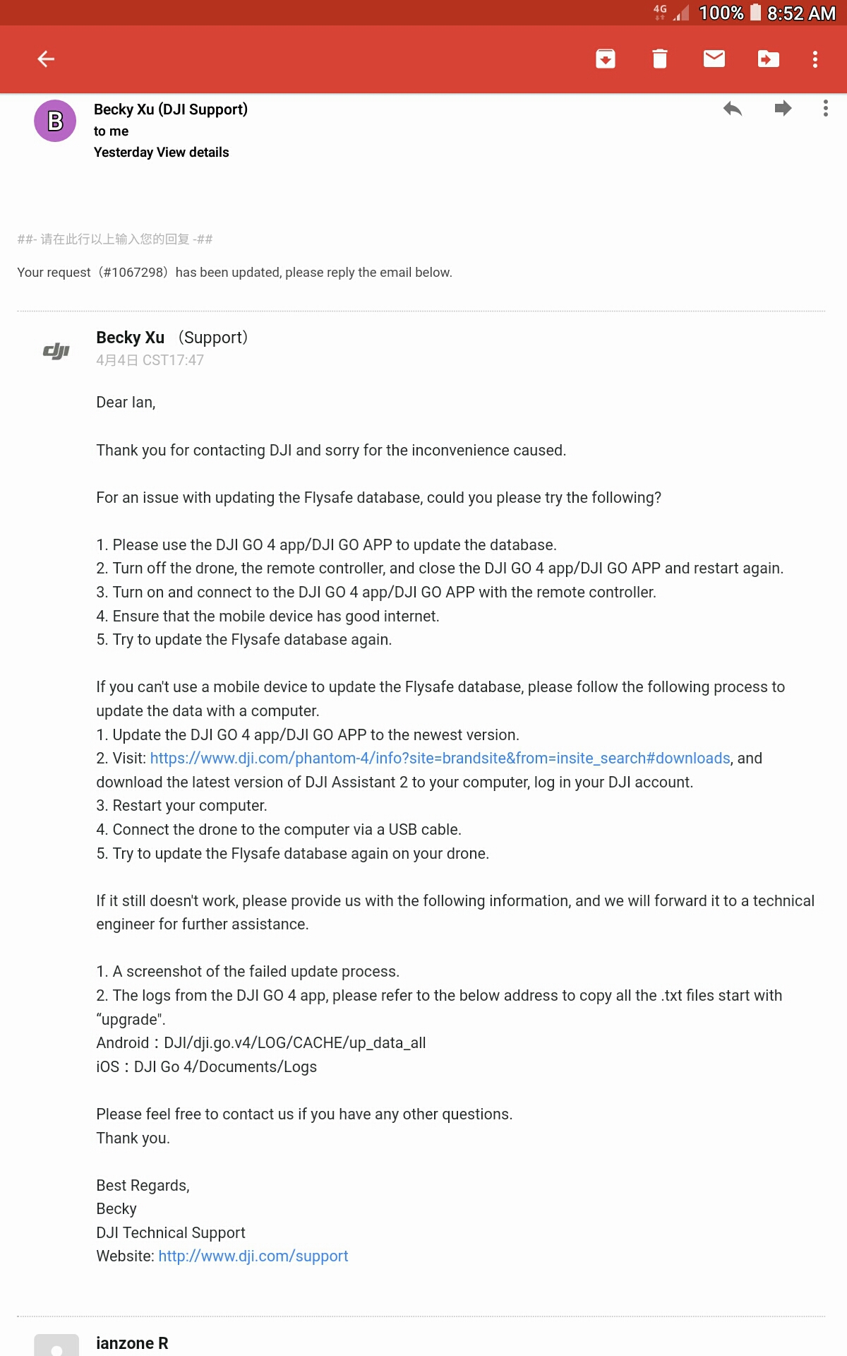

Update success ,turn all on,when prompt shows onscreen hit update,with all still on ,remove usb and stick it in usb on drone,(might need OTG adapter,makes mini to mini usb)update loads.not know why this work now but did email dji on this issue,NEC MINIT it works ,hope this help some of you having this annoying prompt,View attachment 97208 View attachment 97207
In the past, whenever you followed this procedure for GO 4 prompted aircraft FW updates through GO 4, as soon as you removed the USB cable from the RC to connect it to the aircraft instead, and did so, GO 4 would notify you that the RC was now disconnected, and nothing else would happen, even though the aircraft and the iPad were now directly connected through the cable connection. Hopefully, that has been fixed, so this procedure can now work. I'll be testing it later today. I'm optimistic, based upon your post. :cool:
Yes was surprised myself it worked,had test flight and had no prompt come up (yay),,,,just to make me top post bit clearer,here how I did it,,turn all on , when onscreen prompt show unplug usb from remote and plug into drone, then click update and it's away........and turn off wifi......
