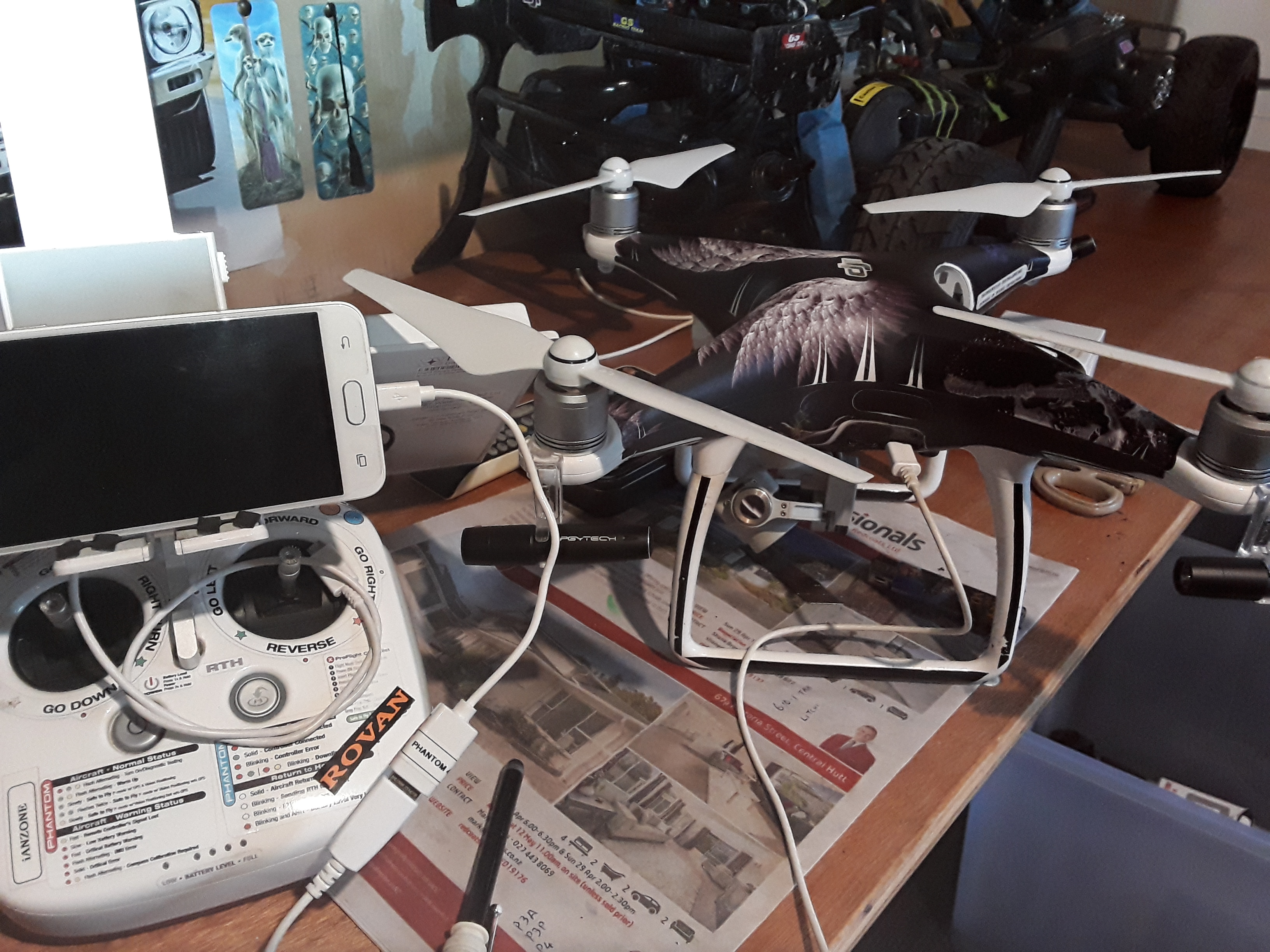

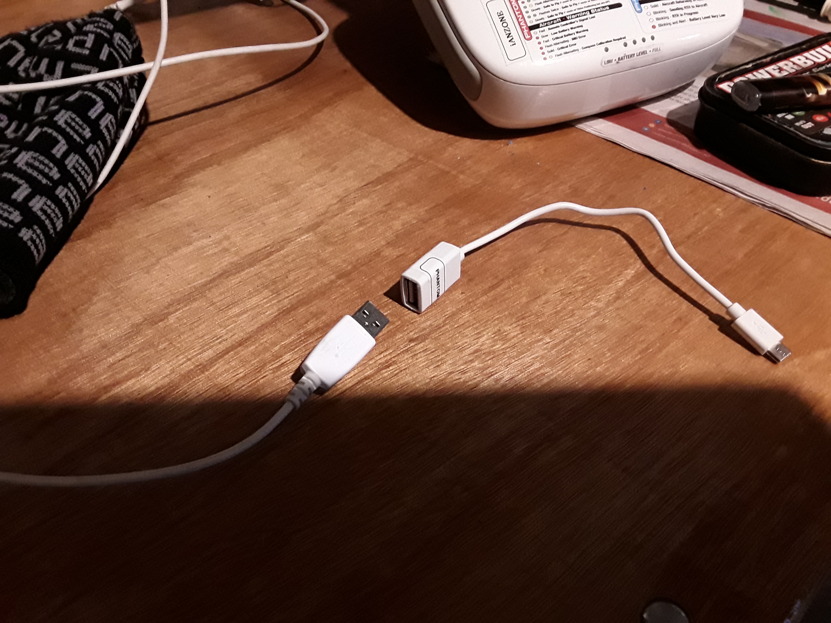

OTG adapter for usb,that way you can conect to device and p4 usb slot,they very cheap and local electronics shop should have,I never had luck with assistant and always do it through the djigo4 app.
,,,,,,these are sposed to be in the box with phantom but some not get,,mine was missing had to buy
