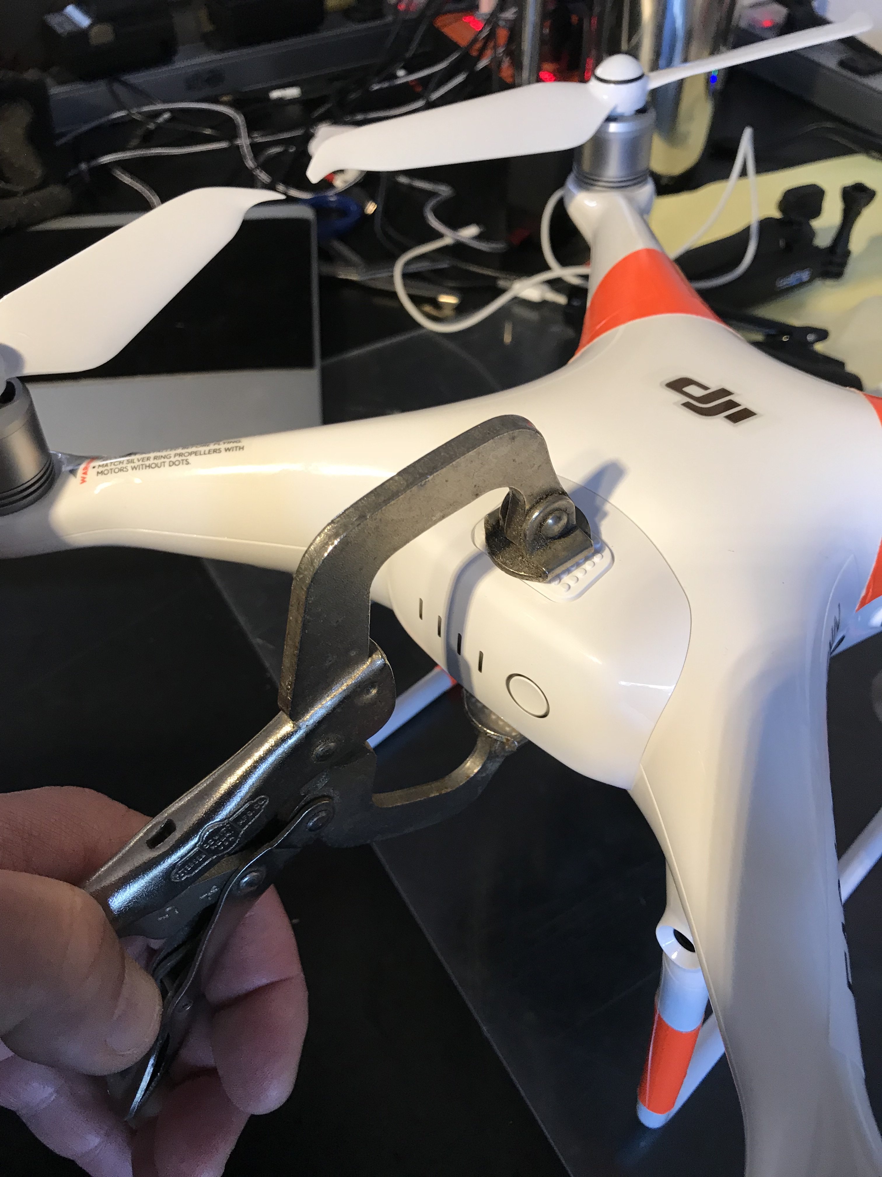

Yeah, they really clamped it on this time. From top and bottom. A pair of welding vice grips with some sort of attachment to keep the plates from sliding off (VHB tape? Double sided tape? Sugru-type stuff?
It IS a design deficiency. I'm pretty strong and have problems getting the battery out on occasion. My wife would never be able to do it.
Edit: Another approach might be to build up the press tab area by using Sugru or similar so that the operator's opposing fingers would not start out about half way compressed. You lose quite a bit of mechanical advantage from starting half open.
Stole the idea right out of my head.
