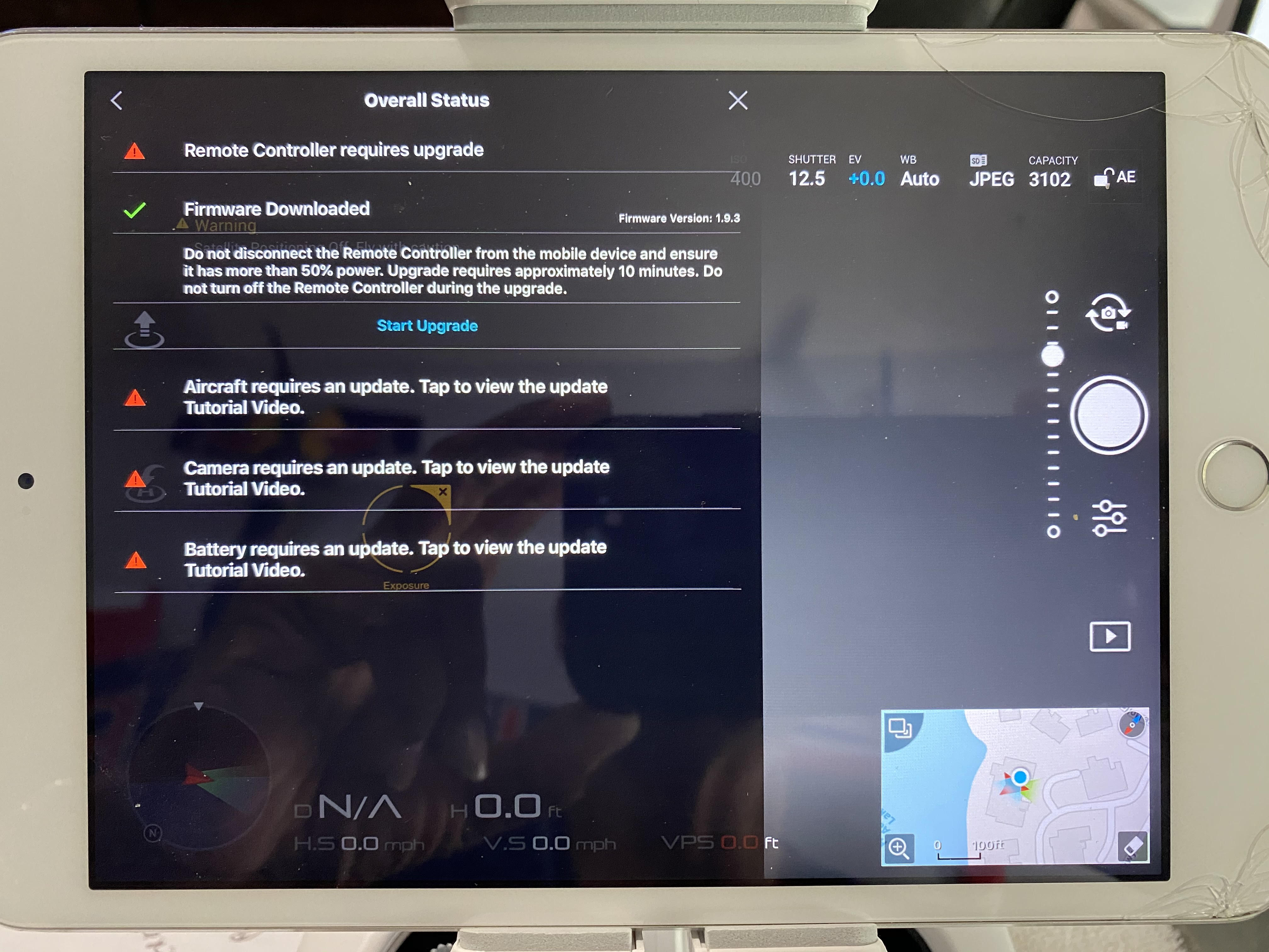

This is a picture of my iPad Mini 3: Overall Status

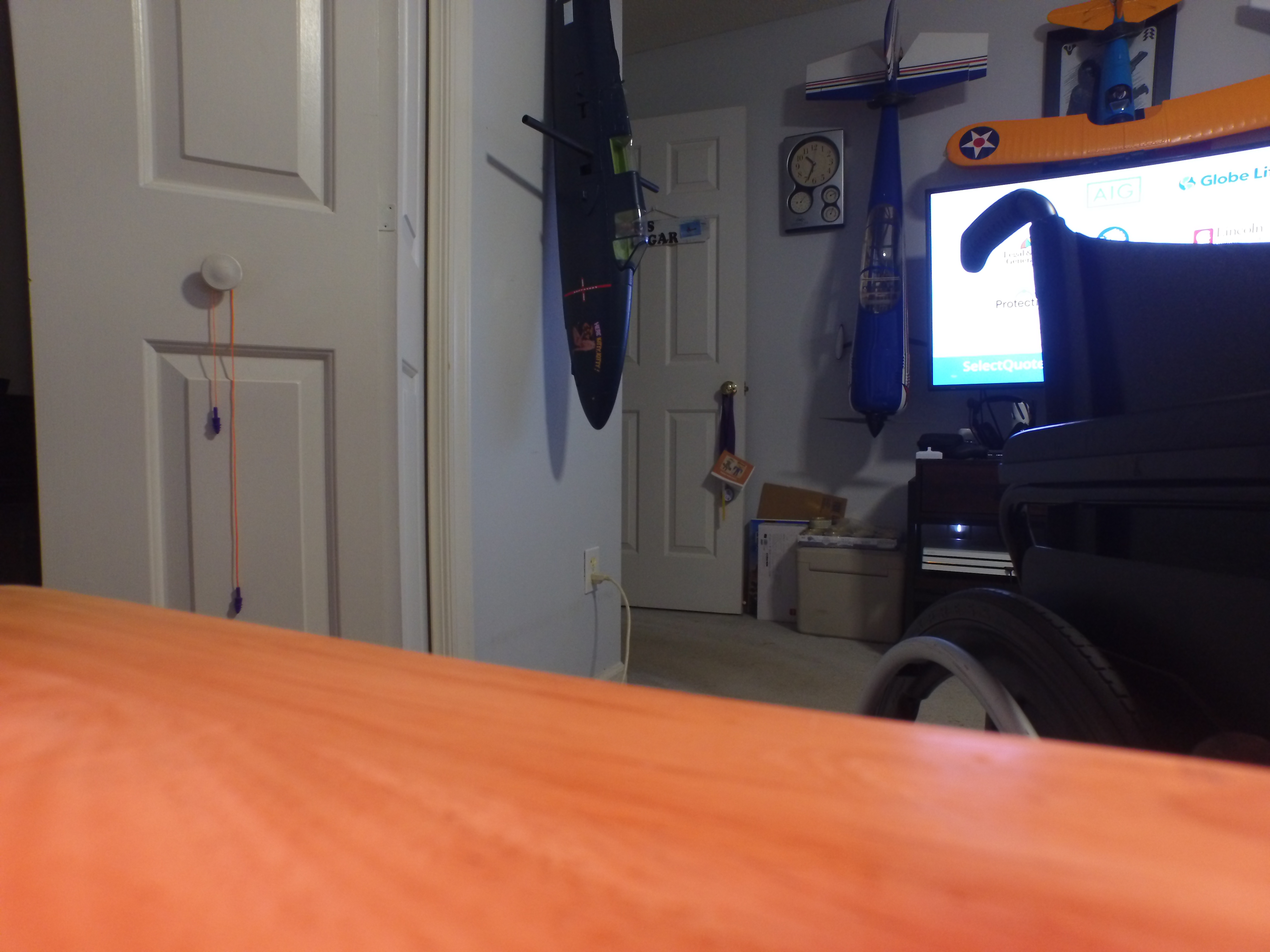

The drone is set to Auto Exposure, I was able to take several shots and the files were successfully recorded to the SD Card under the DCIM folder. Here is one of the pictures from the SD Card.

Excellent, the camera seems to be fine. You are using the same smart device and cable from the known-working kit, yes?

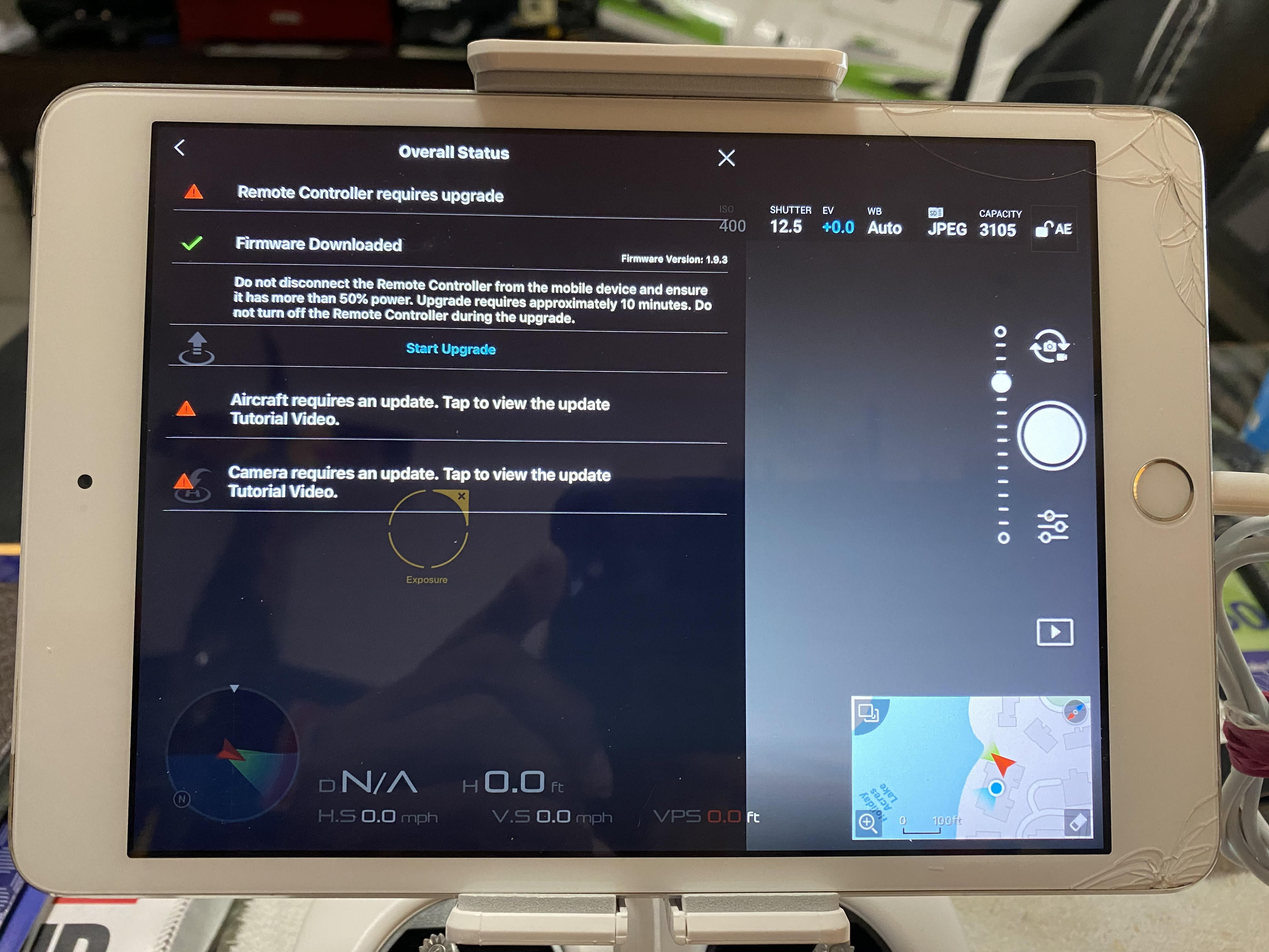

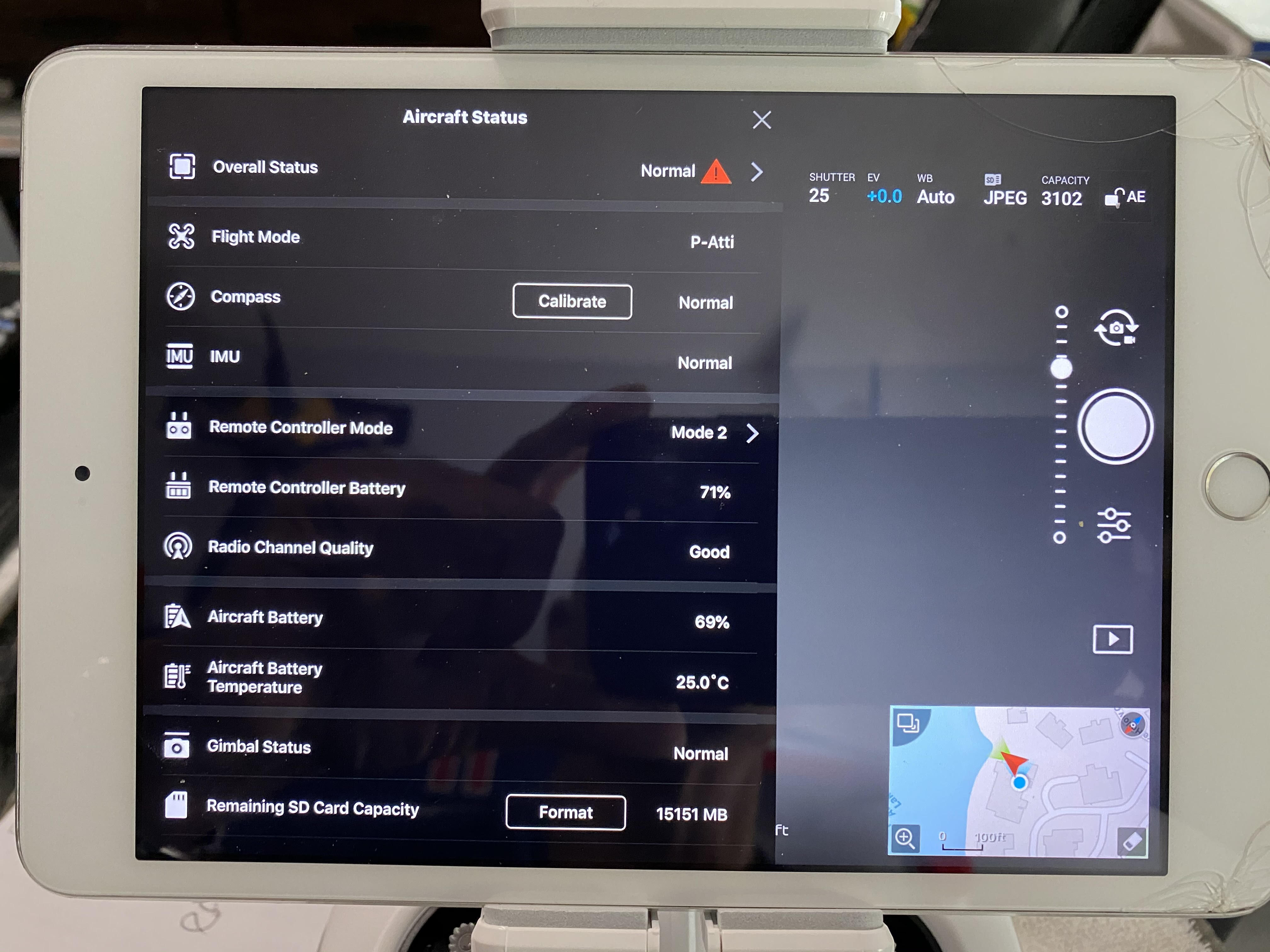

Dave, Yes I am using the same iPad and Cable from the working set. I was not able to get the working Transmitter to work with my Drone. I am including two screen shots of my Aircraft Status which have a few items needing attention. Question is should I update as necessary or will the troubleshooting be easier if I don't? Thank You Again

Your RC is communicating with your craft. No need to mess with trying to clear those FW notices. In fact, if you disconnect from wifi before you turn on anything, those notices likely will not show up.

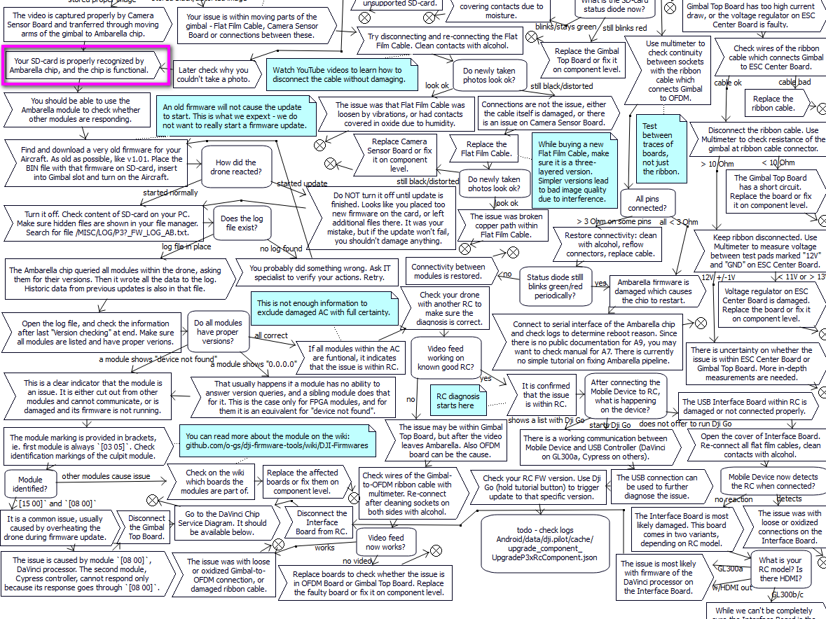

When @Oso asked about the log file, he also provided a link to a flow chart. I have not used that myself, but looking it over, it looks reasonable. I've attached a copy and marked where you are in the process. It looks like the aformentioned log file is generated when you attempt to load an old version of FW and the craft is supposed to generate the log in that process. You can follow the directions in that chart to see if you can get that log.

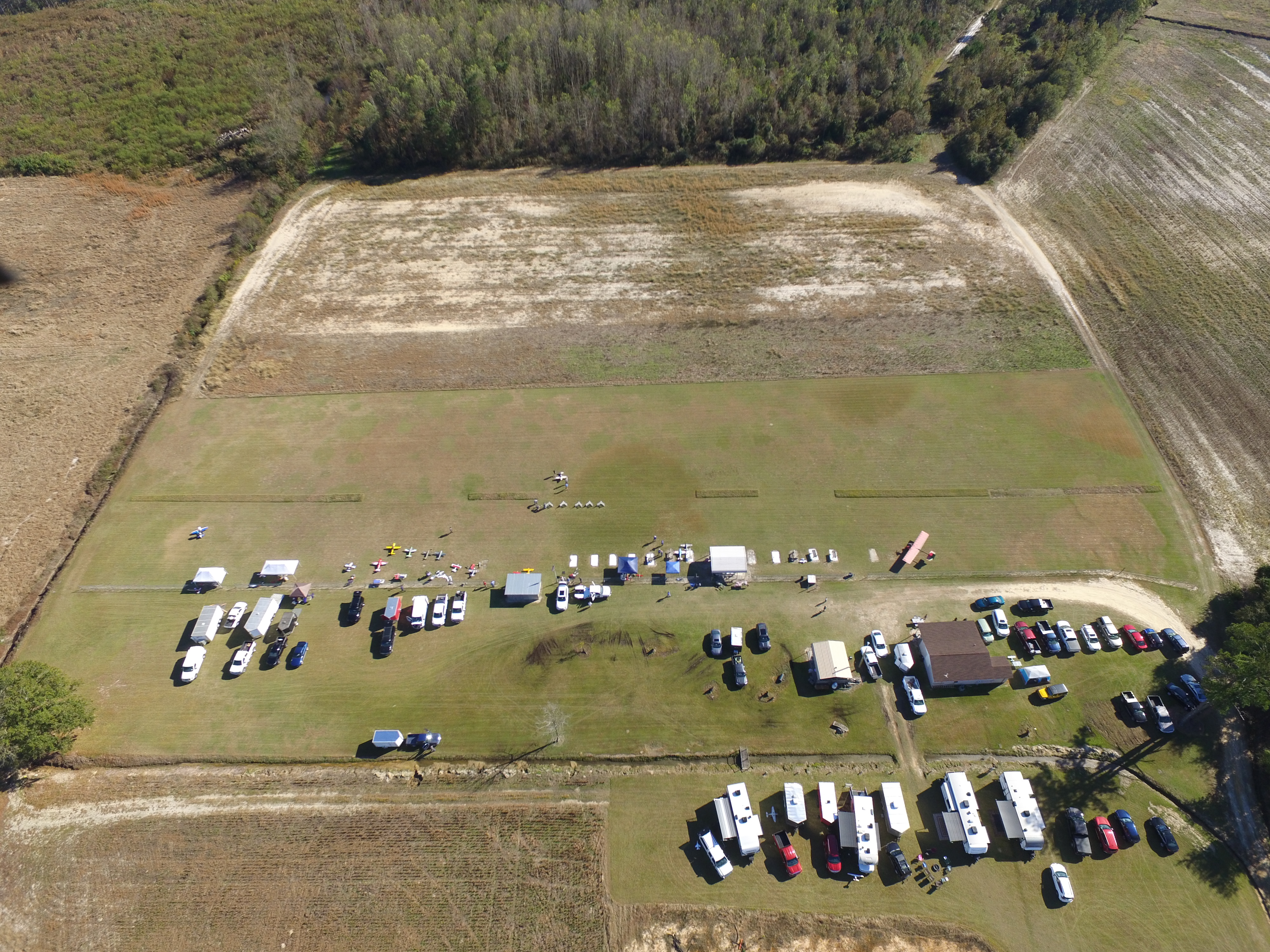

Update: Received Drone back and as I expected I have all new Drone and Transmitter. DJI once again have come through with getting me in the air with my second Phantom 3 Professional. Here is a picture I took this past weekend at an RC Model Aircraft Fun Fly. Thank you to everyone that has chimed in. This place is an invaluable source of information when it comes to Drones and Done flying.
