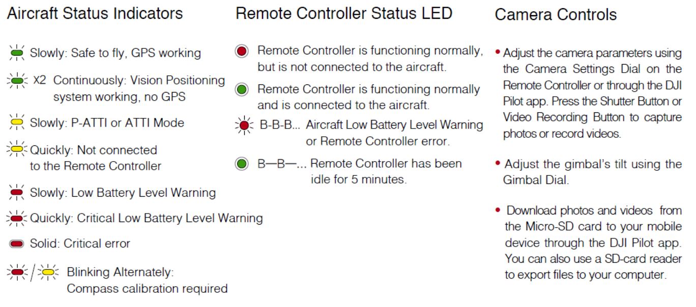

If you power up the drone, and on the camera LED indicator and/or battery side arm LEDs, you get a solid red (system error), something is wrong with the drone itself.

At the moment I am not getting any indication that it wants to connect to the DJI Go App. There is no critical error warning light on the drone at the moment. Everything else seems normal except for unable to get the DJI Go App to connect. Green light on Transmitter, flashing green on drone probably because I am testing on my desk.

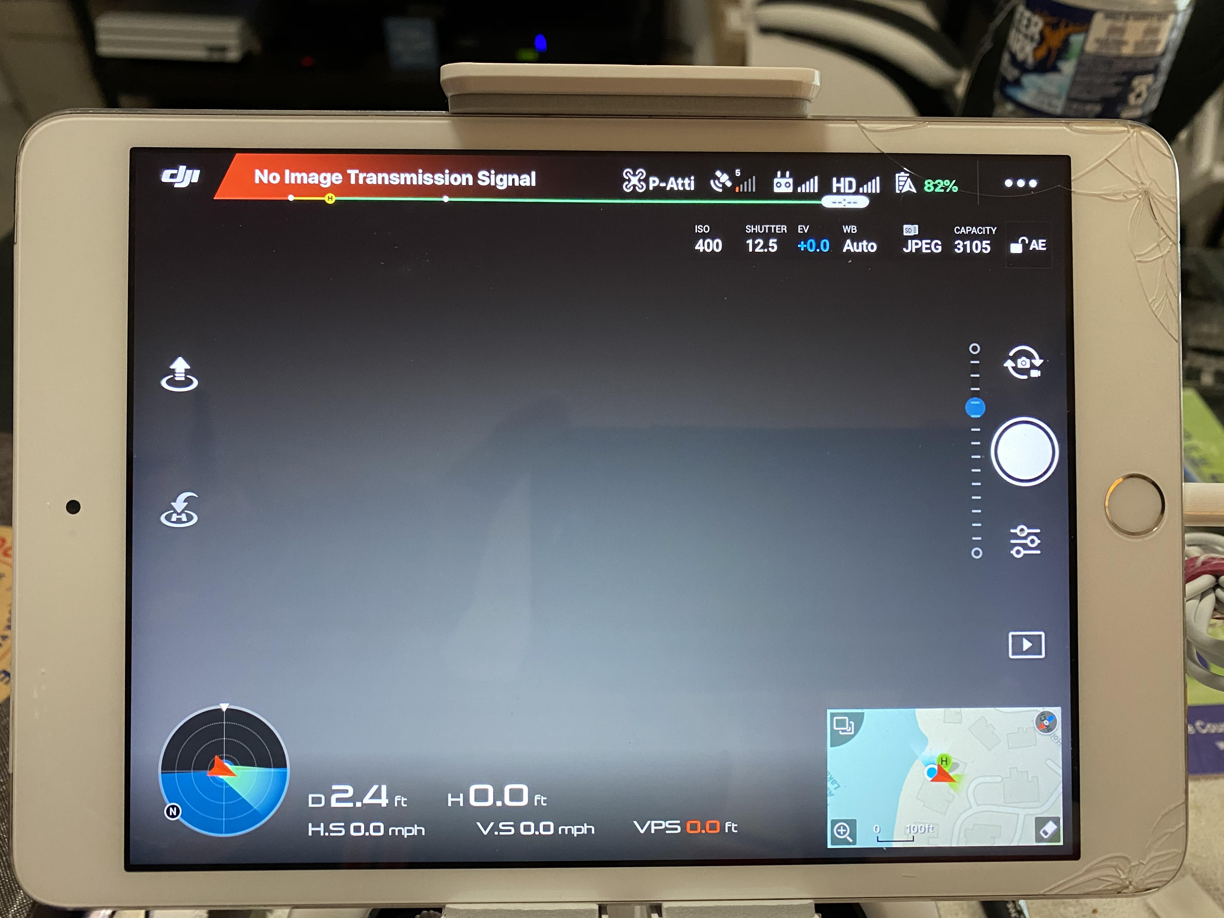

Update: As I suspected once I replaced the onboard transmitter module with the updated HDMI Upgraded Circuited Board Module I was finally able to register my drone and yes starting today my one year warranty. Was able to take the 9 question quiz, aircraft connected and received the below error. I might have to wait until it stops raining to go outside and do more testing to make sure all is good. I do have a fan running on high on the drone to keep it cooled. Now time to research the "No Image Transmission Signal Error". It did start due to interference but I should at least have a camera image.

Dave you are correct and I could have done that, but I was going by what happened with my original drone. As you can see it seems that the Module was defective just like my first one. I am hoping this was the only problem with the drone. Either way I am now better off then I was a few days ago and if I come to the conclusion I don't want to mess with any more I can always open a ticket with DJI and send them the drone and transmitter. Being a Gen 1 setup they just might do as before and send me a newer setup. Just a guess is all here, but until then I will keep working it. Thanks for your chime in.

Dave that is the angle I am working. Not going to mess with FW but look into why I am having the No Image Transmission Signal. Looking at my iPad I see I am getting data except the Image. I am also able to start up the motors. I am able to move the camera up and down. Will have to move my location to my back porch where I have more access to Satellites.
Update: 8 Satellites, waited about 10 min, no change.
Since it’s so common, this is what I was expecting you’d see. Have you already gone through the often referenced troubleshooting chart? I’d like to see your LOG_AB file to see if you have the classic modules 8/15 "device not detected" problem.
