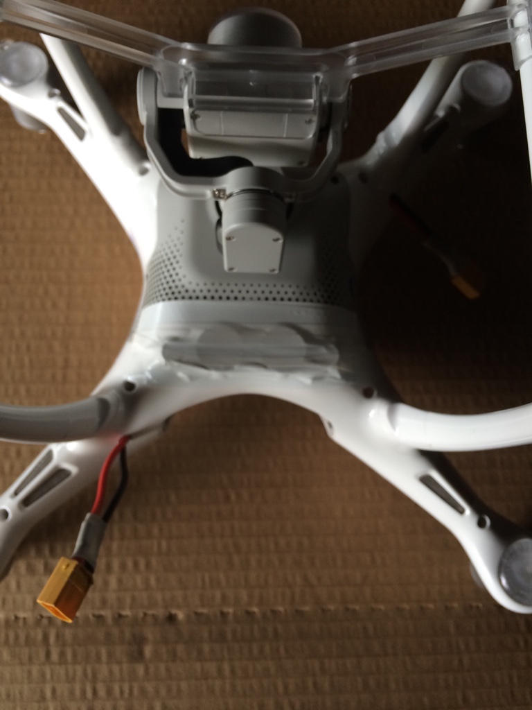

    Just discovered you can turn off VPS simply by covering the sensor lenses with tape. Poof they don't work!

    Here's how I turned it off so I can strap a battery under there ImageUploadedByPhantomPilots1467138671.524058.jpg
    Black electric tape, then white!
