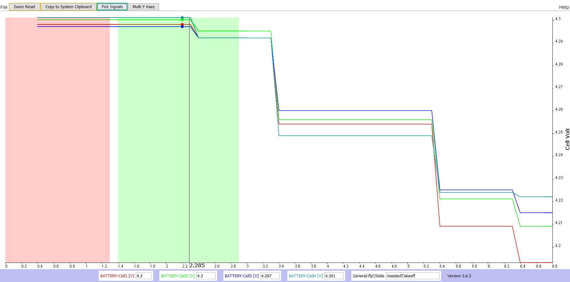

OK, battery and contacts look fine, battery was on its first flights, maybe first, I noticed the Cell Deviation increased during flight, could this bring it down?
No. One cell was a bit off but nothing drastic.
