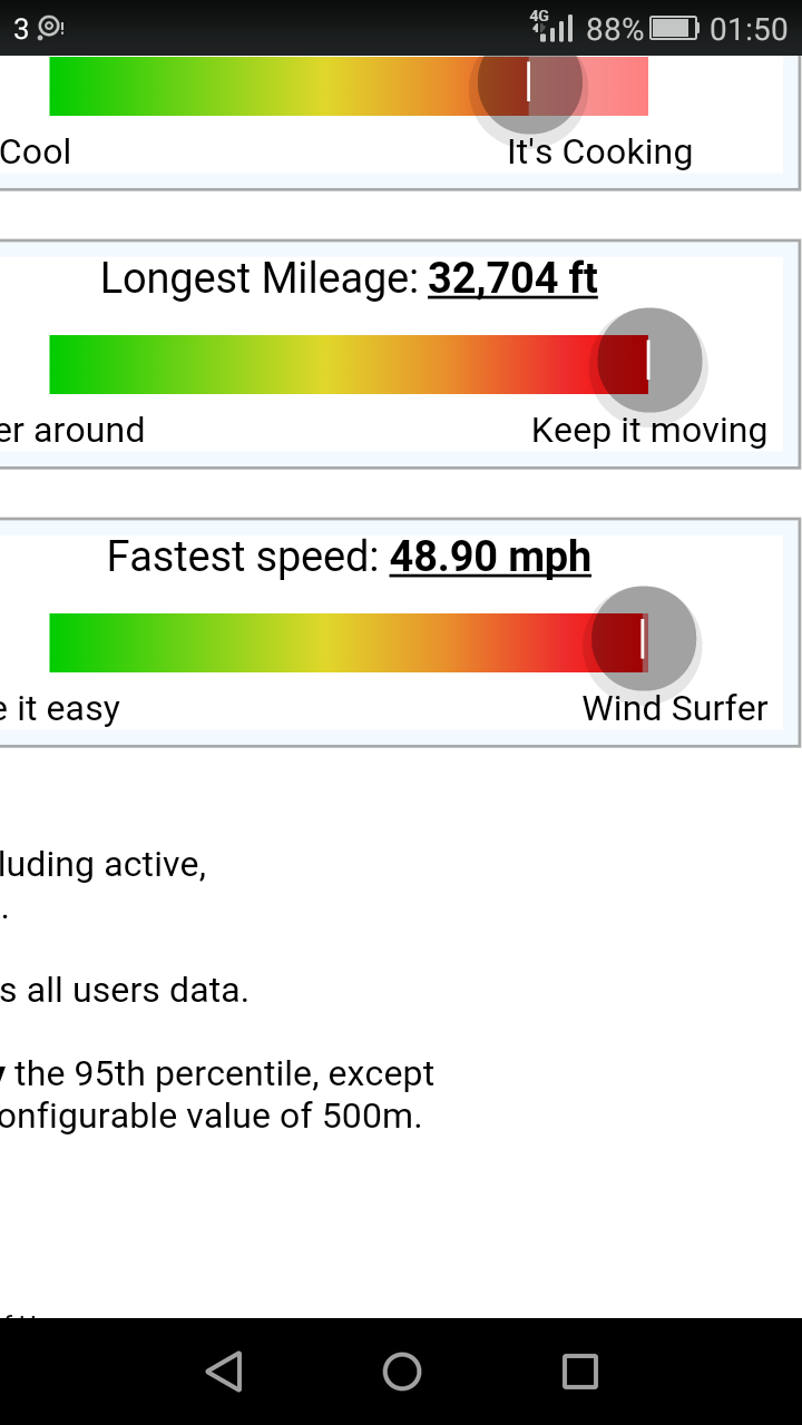

This is mine. Had full signal still on controller and screen. Only came back due to worried about the battery as it was at 60% and I needed to make sure I get back. This was done on a P3A with windsurfers

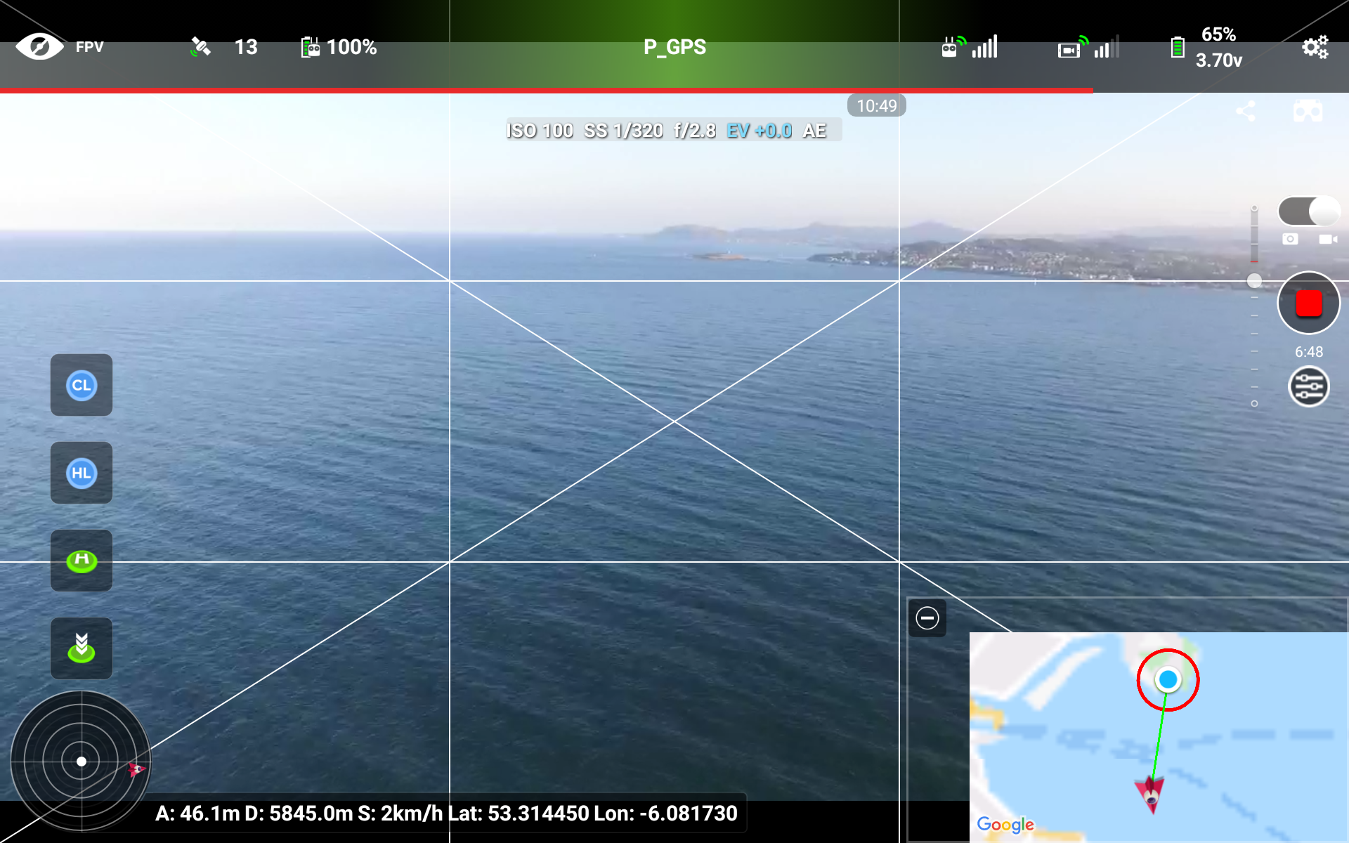

16692 feet outwards and 33385 feet in total including the return journey - all bar 100 metres flown over water - Alfa M04 & M25 antennae plus Sunhans 2.5w 2.4ghz & 2w 5.8ghz
The Itelite antenna mod is awesome, but make no mistake this is over OPTIMAL locations. My range is barely half of that in a city setting.
Laws in Ireland are quite restrictive - no flying permitted over built up areas
