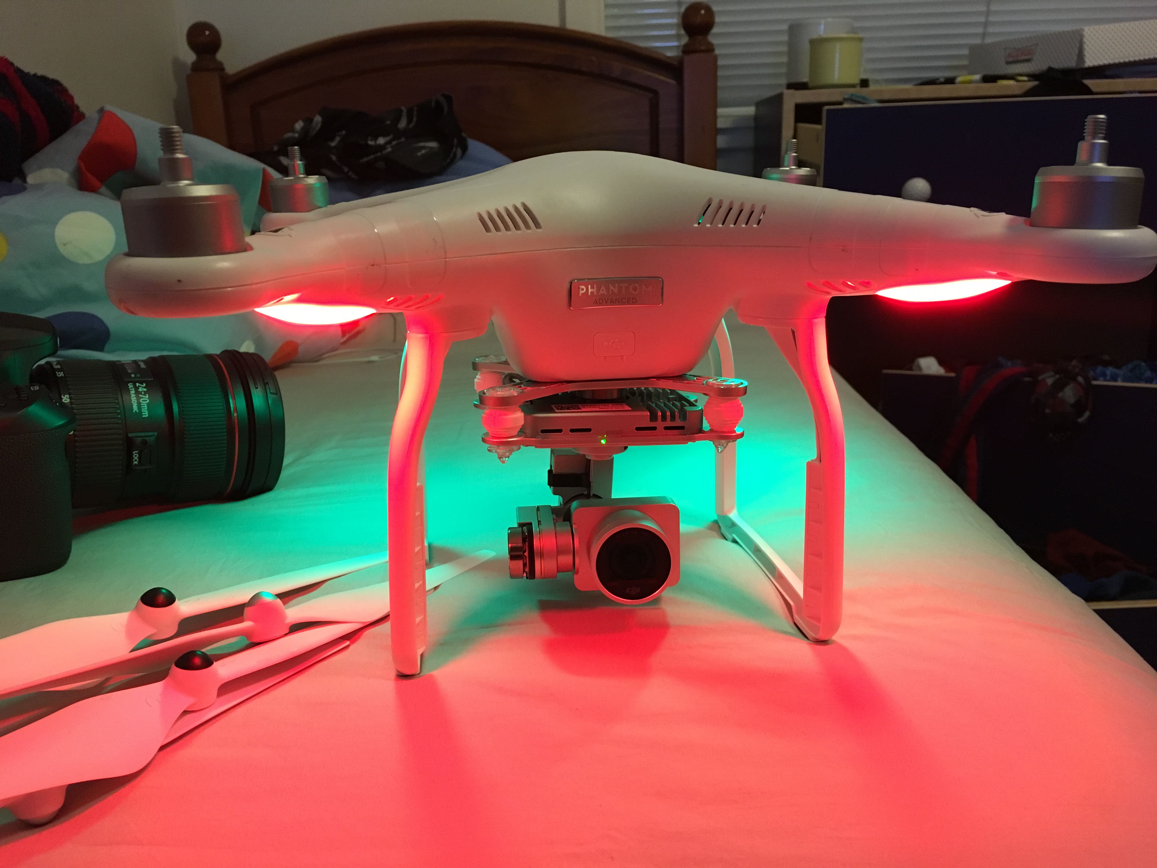

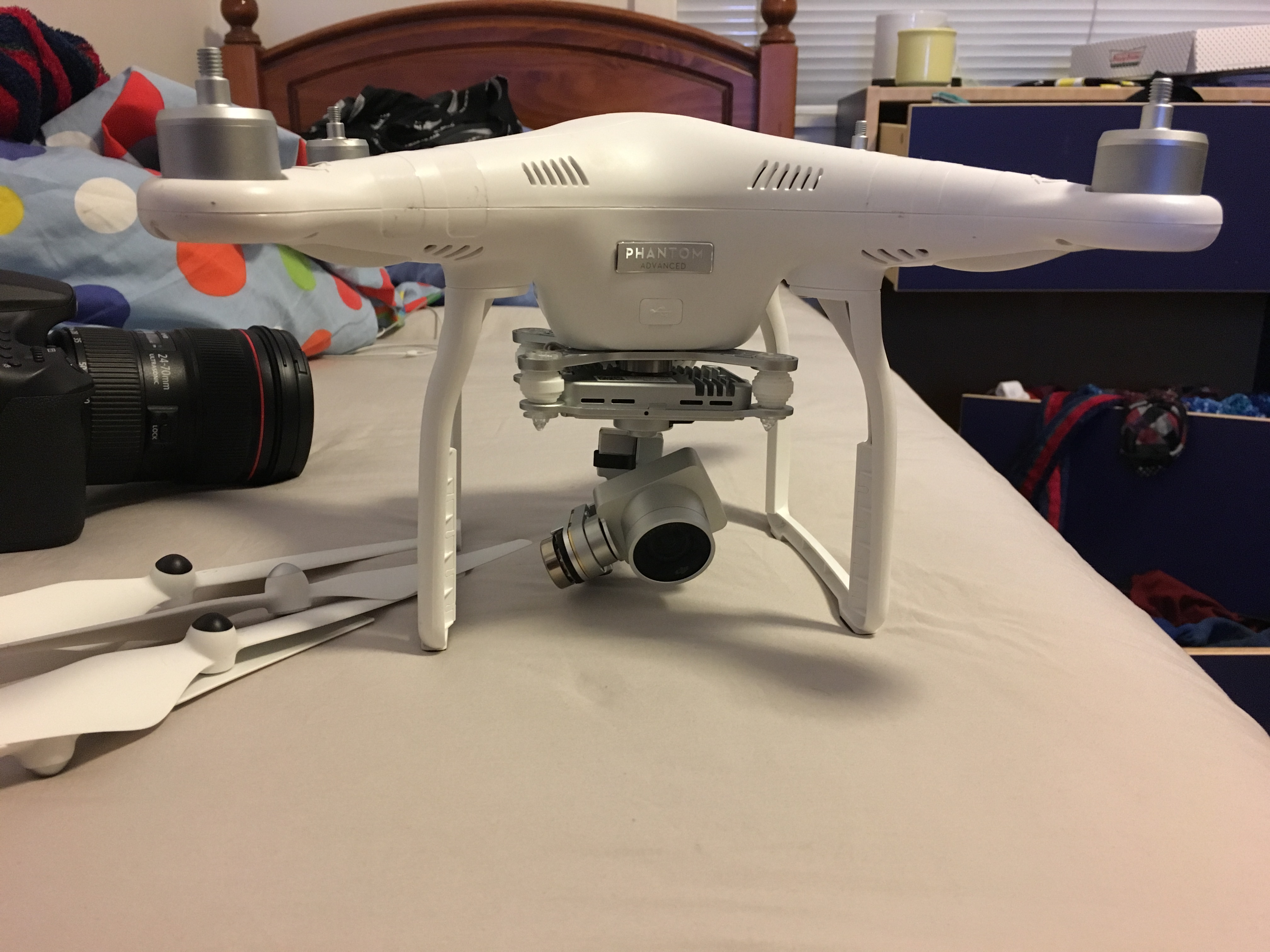

    Hey,
    I recently had a crash where the drone dropped 30m after hitting a tree. Fortunately, there was no damage on the body except scratches and dirt marks everywhere. Although the gimbal ripped completely off. I managed to solder the cables back and attached it, but noticed that the gimbal tilts when off (like in the photo?)
    Just wondering if this is normal due to gravity? When its on, it even's itself out but when off its always tilted like 30 degrees
    ALSO - I'm sorta still new to drones and all, and after my crash, is there a guide I can follow to make sure everything is working 100%? Like making sure the motors, sensors are all working?'
    Thanks!

    When your drone is turned off, it is normal for the camera and gimble to be tilted. As a matter of fact, when it's off it will be totally limp and movable by hand.
    Give your propellers a hand spin to make sure they spin freely and don't make any noises, except for a quiet Whirring sound if you spin them fast. Power everything up and check the status on the GO app. It will tell you if it detects something wrong.
    You may want to do a compass calibration and even an IMU calibration just to be sure. Follow the instructions for both to the letter!
    Your first flight afterwards should be a simple hover a few meters off the ground near you. Make a short flight to test the controls and the drones behavior. If it hovers in GPS mode and holds position, and the flight controls are behaving normally, you should be good to go.
