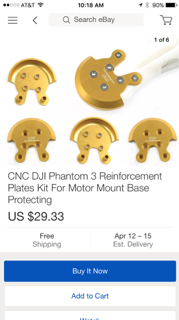

    What thread lock do y'all use for the motor mount reinforcements, red or blue?? Thanks in advance.

  9. pilottee
    Nov 2, 2015
    8
    2
    I have the inodized aluminum plates and they recommend thread lock in the instruction. I thought they would have sent the screws out with the already applied thread lock.

    Pilot,
    Again, just opinion. I like the UAVbits item better. I don't think I'd want something so rigid. I wanted something that would flex with the bird. With that setup, I'd probably put a tiny bit of nail polish on the screws. Just remember, any time you want to check them the polish will break and will no longer be effective.
