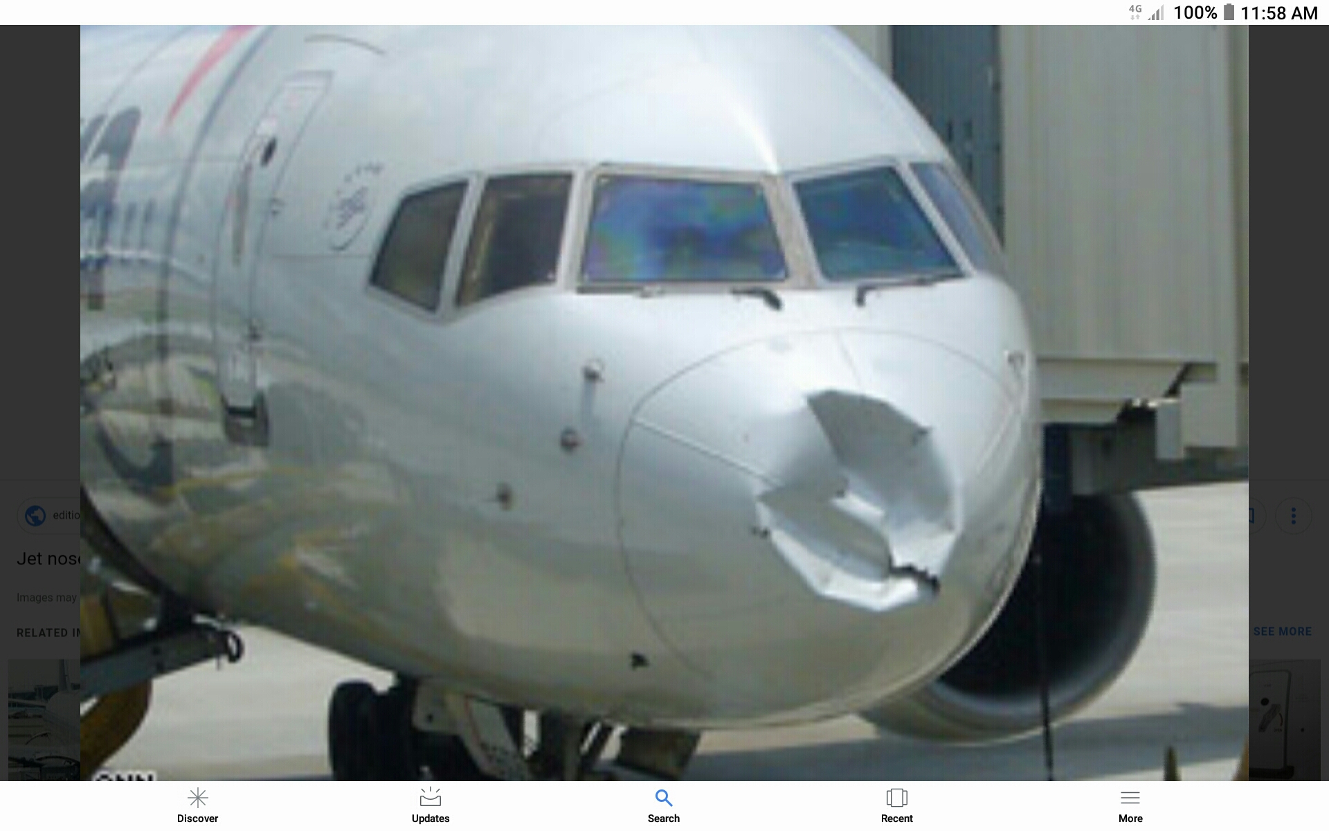

I reckon it become unmanned if that happen,,got curious and went searching,,I found this similar pic of mid air cave in,,NO impact,,,,we'll no more planes for me lol..since no evidence at the scene this what probly happen
I reckon it become unmanned if that happen,,got curious and went searching,,I found this similar pic of mid air cave in,,NO impact,,,,we'll no more planes for me lol..since no evidence at the scene this what probly happenView attachment 106296

It can happen from a simple hail strike previously. and because it is right at the point, and is not made of metal, they can collapse. Since there is a radar unit right behind the dome, they are made of very thin and lightweight material.

I think there is too much tearing on the Aeromexico 738 radome for it to be a simple collapse without collision. Because of the shape, I don't ever recall seeing a 738 radome collapse without impact of some sort.

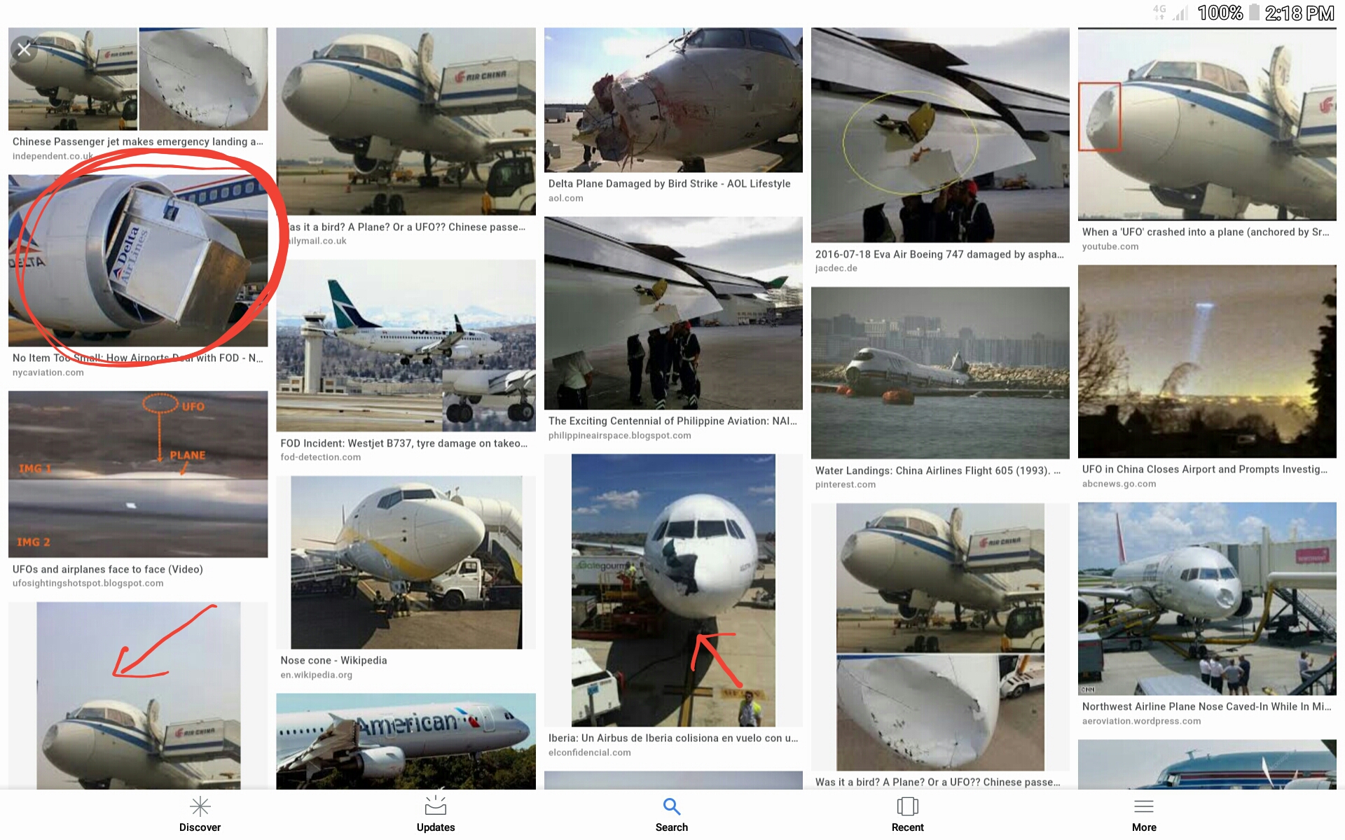

Gezz check these out,comes up with Google search,,can see bird strike one but others are there so must happen more than we think,,,,note the one I circle,,lol,,nothing to small,,,this some thing airports rather keep quiet on,,
Gezz check these out,comes up with Google search,,can see bird strike one but others are there so must happen more than we think,,,,note the one I circle,,lol,,nothing to small,,,this some thing airports rather keep quiet on,,View attachment 106302

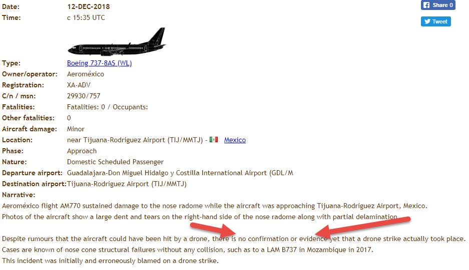

The radome cover is not a structural element of the plane - just a lightweight fibreglass cover.

The investigation came up with this finding:
Mozambique's Civil Aviation Authority concluded the radome most probably failed as result of a structural failure caused by air flow pressure, contributing factors probably were a defective installation of the radome and inspection of the ribs.
